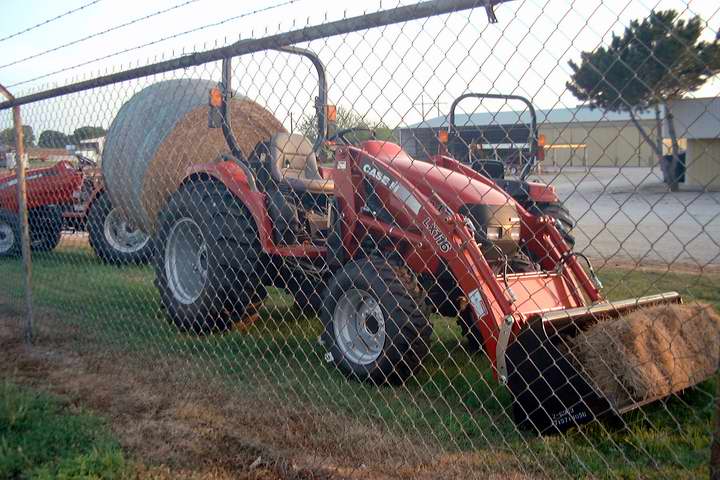

Mark, I'm going to echo what Mike said about getting someone else to cut and bale your hay. I think the TC45DA is a great utility tractor, but a mediocre haying machine. I would not want to do haying with anything less than a TN-size tractor. Once you get round bales in the field on 10 acres, you'll have plenty of work for the TC45DA just getting the bales out of the field. It can handle bales with a 3PH spear and light bales less than 1500# on a quick-attach spear. If it was my tractor and I was going to handle a lot of bales, I'd plan on using the 3PH and keep the loader on front for counterbalance.
I think you will love the convenience, size, and ease of operation of the TC45DA for the hundreds of utility functions around your property using the loader, rotary cutter, etc.. I just believe you will be a lot happier getting someone else to do your haying for you. I also think your tractor will last a lot longer if you don't run it at or near it's limit all the time.
I'm attaching a photo I took of a D45 at a local dealer. You can see the handling of a round bale. It makes the D45 look pretty well loaded. I've also handled bales with my TC45D and it does a good job on the 3PH. /forums/images/graemlins/cool.gif
