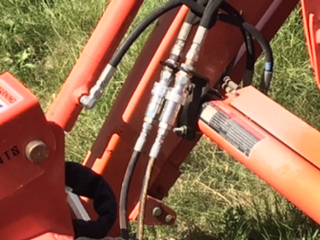

I.E. is there a backward and forward flow? (Land Pride 3rd function, MTL grapple) Everything is all hooked up and ready to go, but I don’t need a major repair job at this point.
Intuition tells me no, 92AF8E14-2DE9-46DA-9F59-348AC41814FA.jpegbut I once trashed my PTO backhoe pump when I hooked up to my woodsplitter wrong.

No, it won't damage anything in that case. It will just work the opposite from what you have setup. Let's say you push a button to close the grapple, if the hoses are connected wrong, it will open instead of closing. I hope it makes sense.

If you're just powering a cylinder or a hydraulic motor by using the tractor remotes or 3rd function, there is no damage if you connect the hoses wrong. The worst it can happen is the thing work the opposite of what you wanted.
However, if you're powering something that has it's own valve, ie: log splitter, it does matter how you connect those as it will damage things.
   / Can I damage my system by hooking up my grapple hoses wrong? #5
Usually Grapple couplers are reversed so they can't be hooked up backwards. One male and one female on the tractor. Same on the Grapple hoses. If you don't want to do that, put a zip tie on one circuit. One on the Grapple hose coupler. One on the matching tractor coupler.

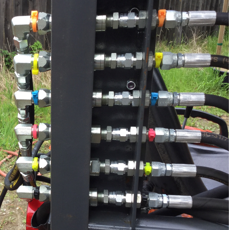

For the grapple I hook it up either way. Just takes one push on the valve lever to see what way is open and what way is closed.
But I did use color coded ties to simplify the top and tilt hookup. Without that it can be difficult to get the hoses paired up and the three valves operating consistently.

Good stuff Pat. Great pic!!!
