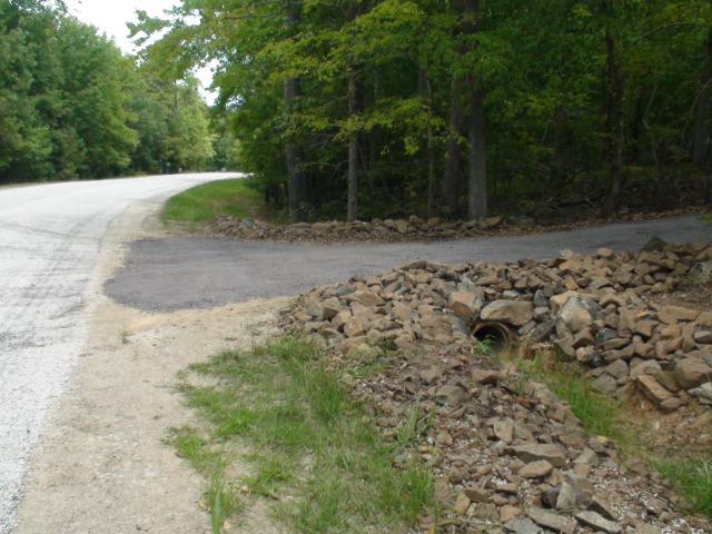

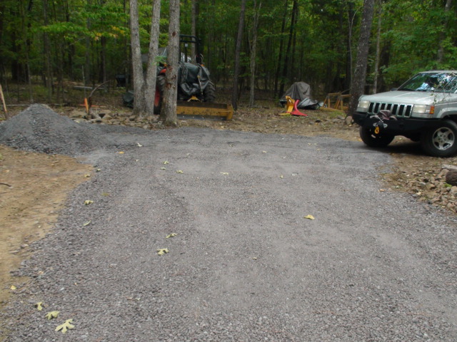

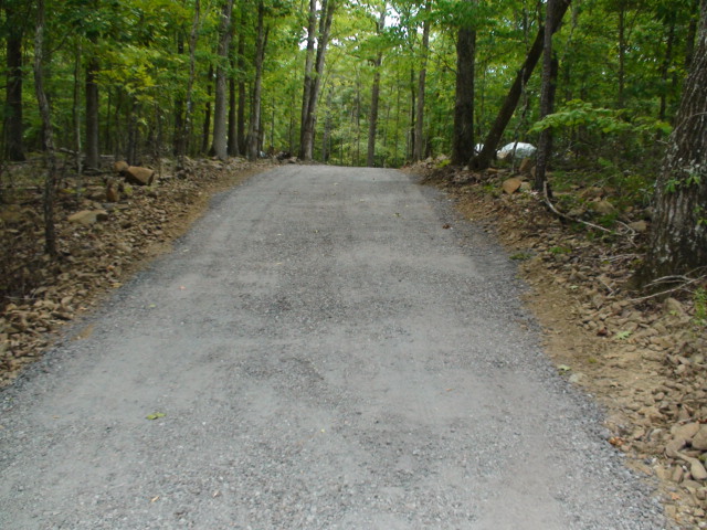

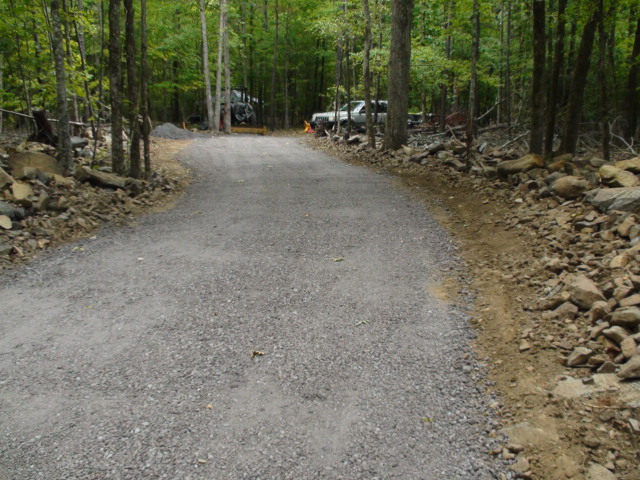

Filling in ruts and finish grading are too different things. Ruts are easy and finish grading takes a lot of skill, experience and the right equipment. I believe you can fill in the ruts okay but need to add a good landscape rake to your equipment list (with wheels). I would not attempt finish grading for a home site.
I just put in a driveway that went up a hill, then flattened out and curved around to the area the house will be. I have many hours in it, along with more and larger equipment than you have mentioned. I got pretty good with the ROBB and landscape rake (with wheels) using the TNT hydraulics and the driveway is graded exactly like I wanted. I have received comments the job looks professional.
I am leaving my home site grading to professionals after I cut down the trees and have a mini-x dig up the large stumps I can't remove.
I can't emphasize enough how important wheels are (to us folks who do not have professional level box blade and landscape rake skills) on a heavy landscape rake to spread the loosened soil- evenly.
I would not attempt to finish grade 4 acres or 1 acre for a house. I think your equipment is too small and there is not enough of it.
