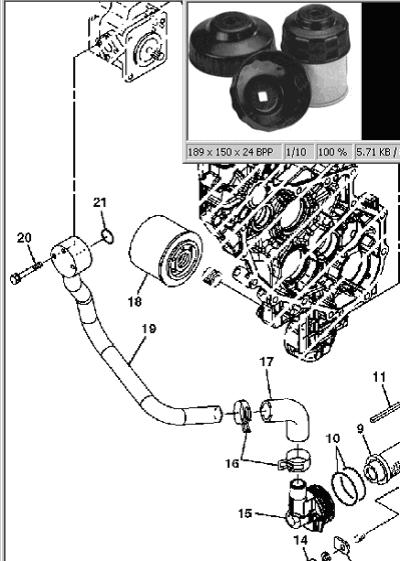

I have a 2210 and am pretty handy with tools, Can I do this service myself without getting in over my head. Do I have to remove the mower deck. Anthing I need to watch for?
   / Can I do the transmission service myself #2
Do a search as there has been lots of discussion on this. The answer is yes to both. It is easier without the deck. The hardest part is removing the bottom screen as the line attaching it restricts easy removal. I tried it this way first then had to remove the other end which allows removal of the screen.

Do it yourself. Buy all of the parts & oil from Deere. The MMM needs to come off (doesn't have to but extremely simplifies the project). You need to learn how to remove the MMM anyhow for cleaning, blade replacement, etc. The most difficult part, like someone stated eariler, is removing the suction screen tube. I fought with it for ~ twenty minutes and then followed the tube up to where it bolts to the top of the unit (see attachment). Remove those three bolts (part #20 in picture) accessed from atop of the rear tire and it allows you to get things apart in like two minutes. Just remember to have container(s) available to hold the 3+ gallons of hydro fluid. Also, the hydro fluid you drain will be red-ish (like auto trans fluid) and the new will be gold-ish (like engine oil).

Well I did it no problem, easy to do , removed MMM , which BTW was very easy , and did the R/R. Man there is a lot of fluid in these babies. /forums/images/graemlins/laugh.gif
Thanks everyone
   / Can I do the transmission service myself #10
I done mine myself but I also removed the rear wheel, gives you some extra room.
