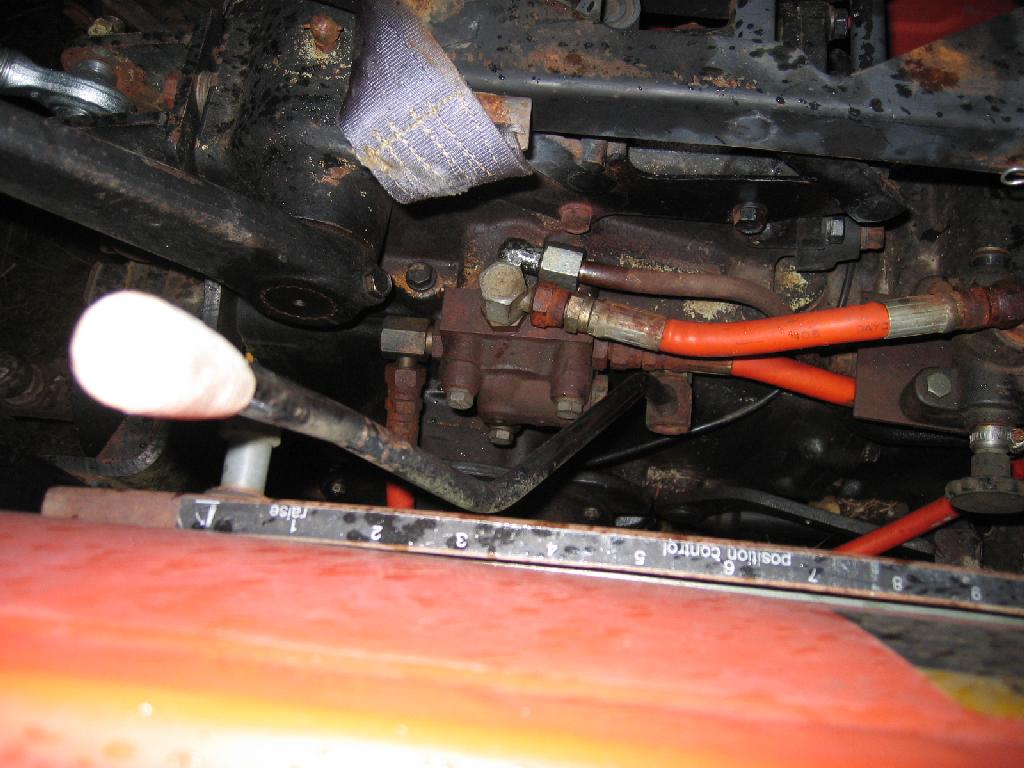

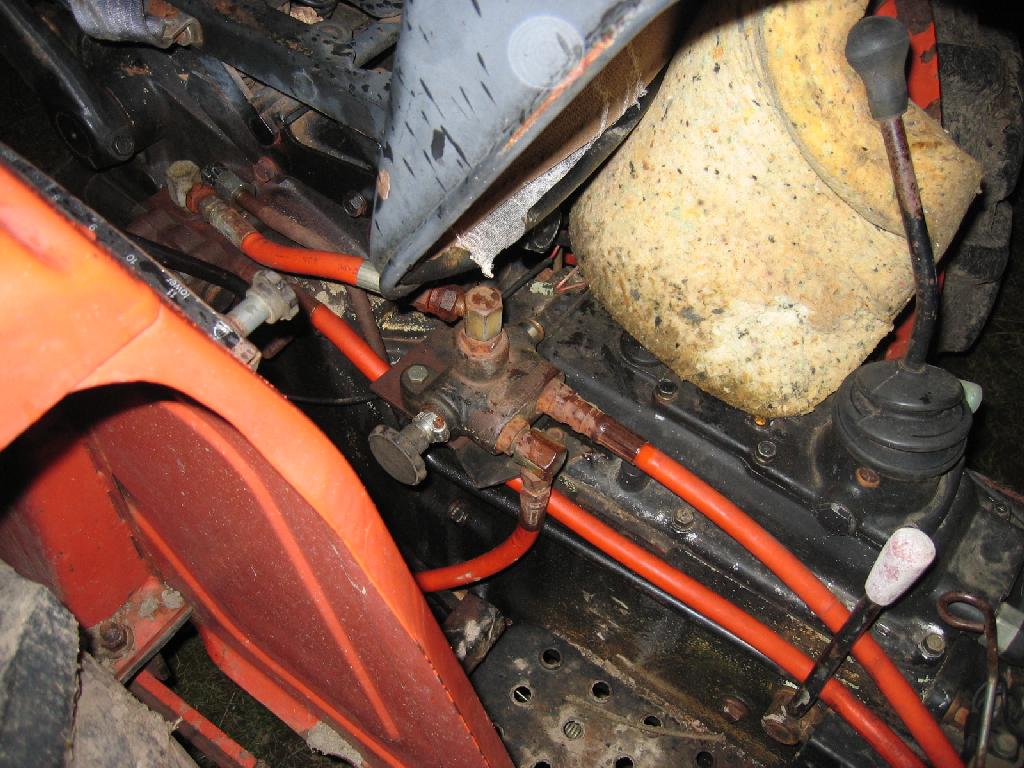

There's a block on the right side just where the pressure line (small one) is attached to the trans housing under the seat. It has 3 lines attached to it, the top one is high pressure going to the diverter, the lower front one is from the "OUT" on the FEL control valve, the rear one comes from the diverter and I assume it's high pressure to the 3PH.
The loader is an Allis Chalmers model #430. It's detachable, which is cool.
Monte

   / Can I eliminate a diverter? #8
thanks for the photos- I will have to compare in a few days to see what I have, as the tractor is at the farm and I am working in order to have enough money to keep ranching.ha ha
#9
If you can take some pictures of yours that would be great. I'd like to see the area where the pressure line from the pump enters the trans housing.
Monte
