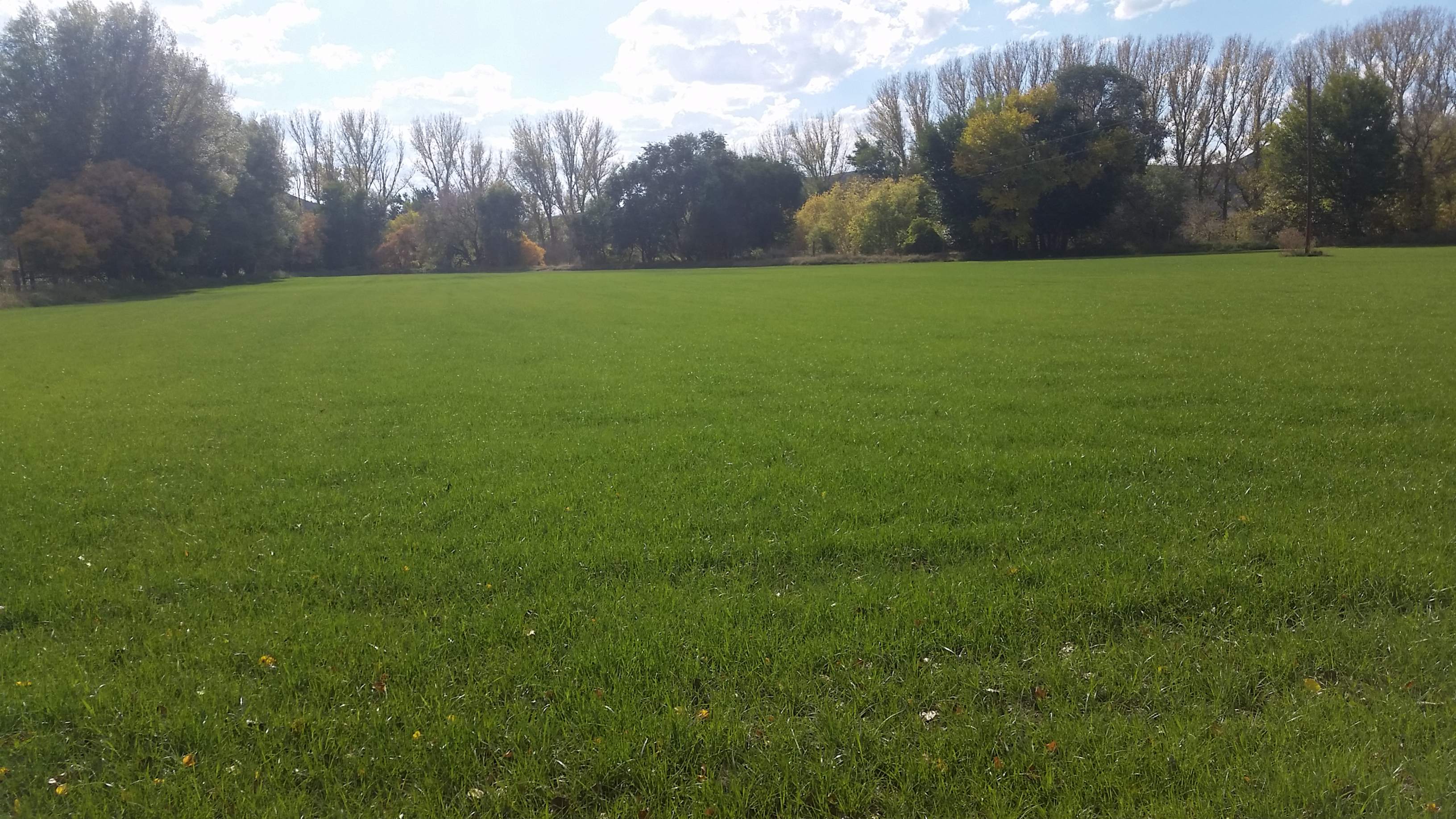

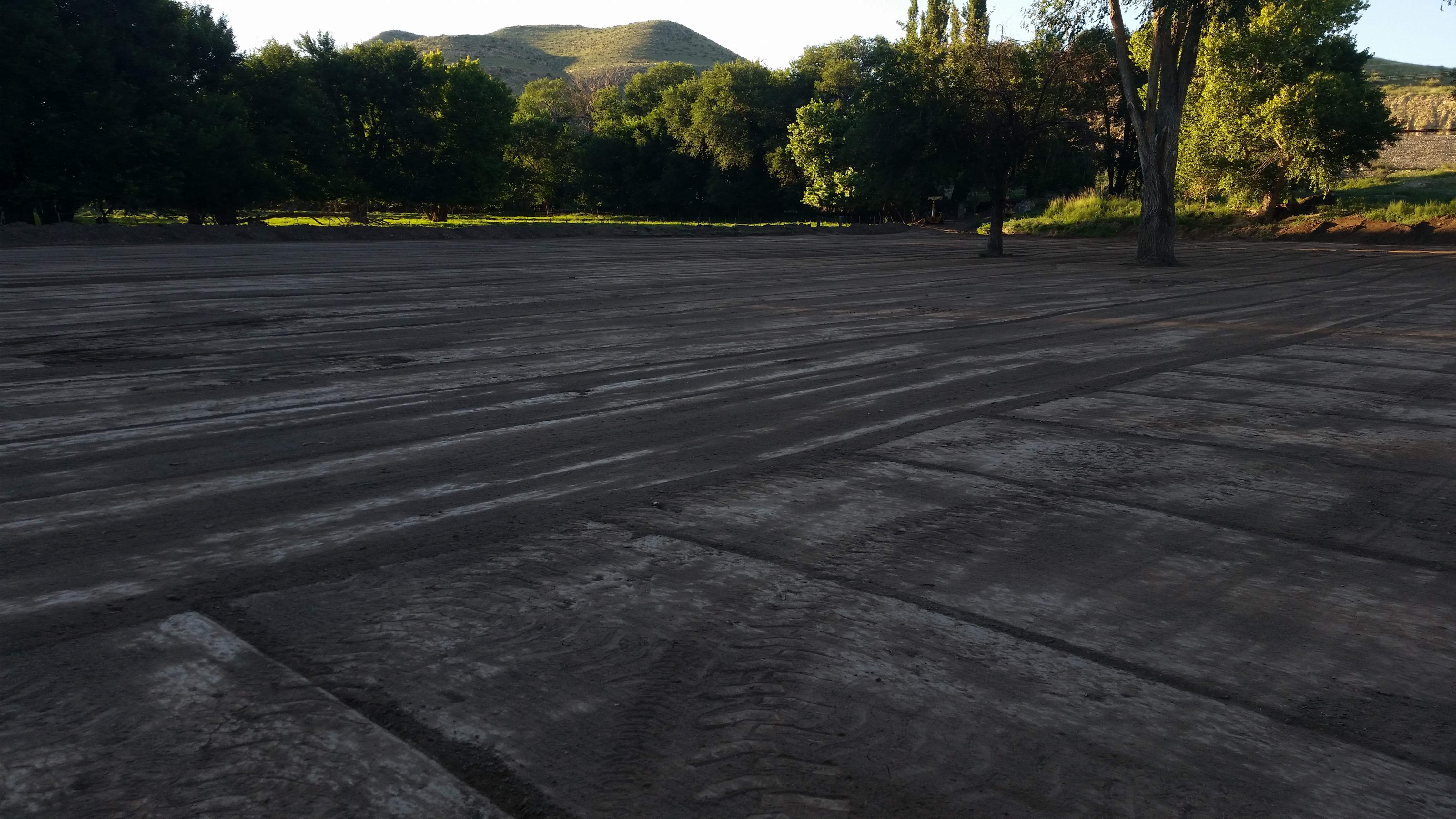

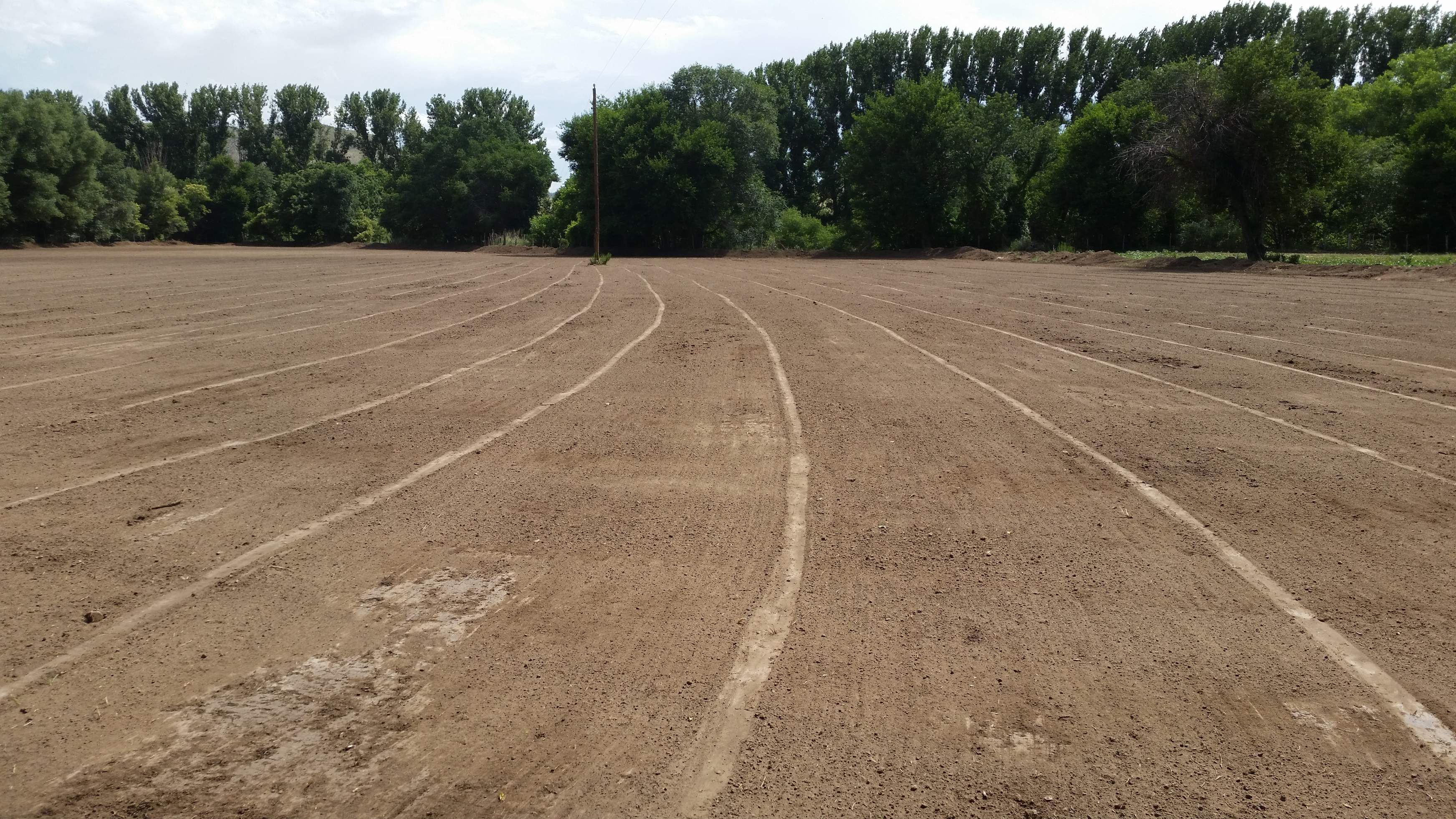

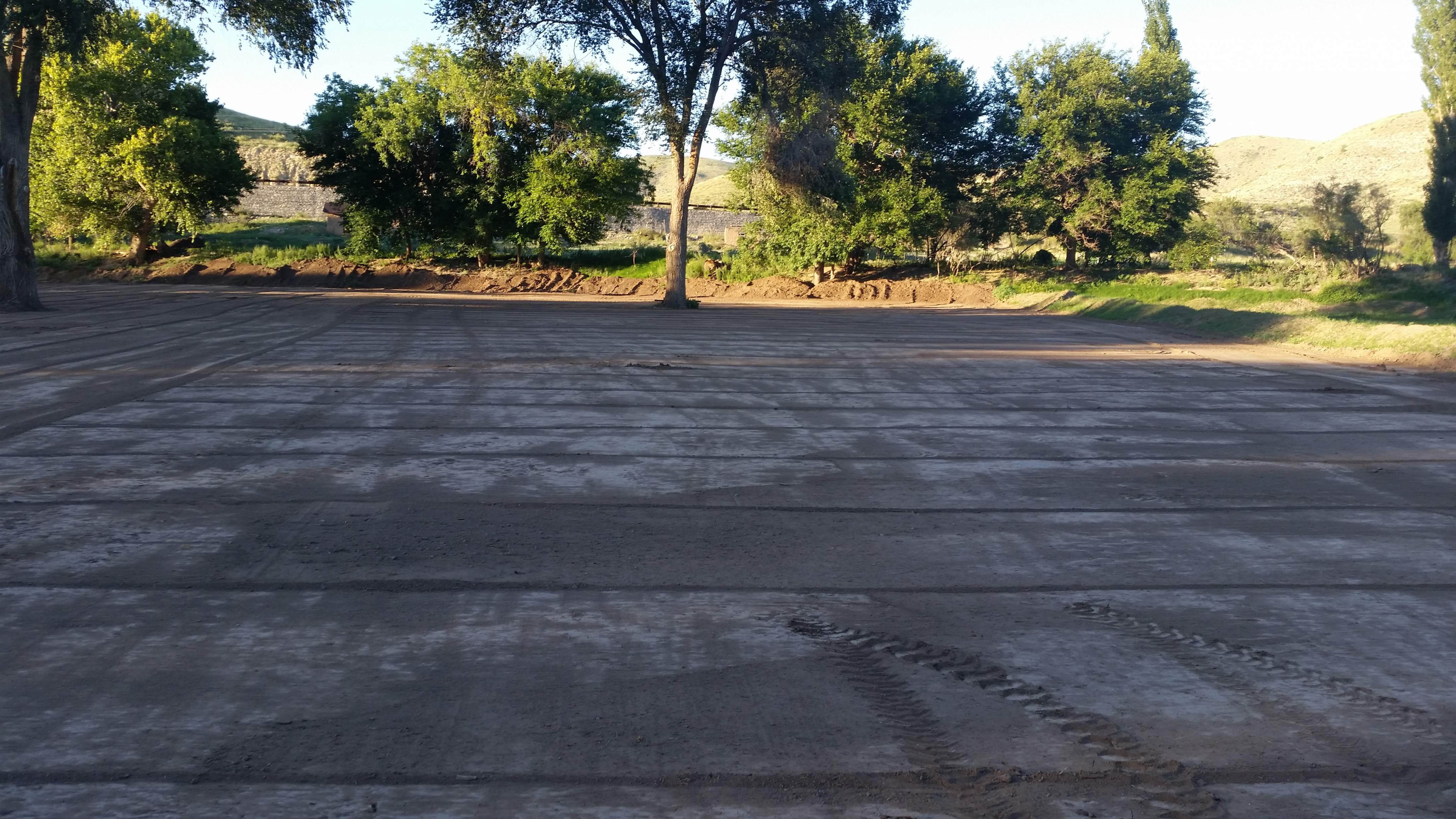

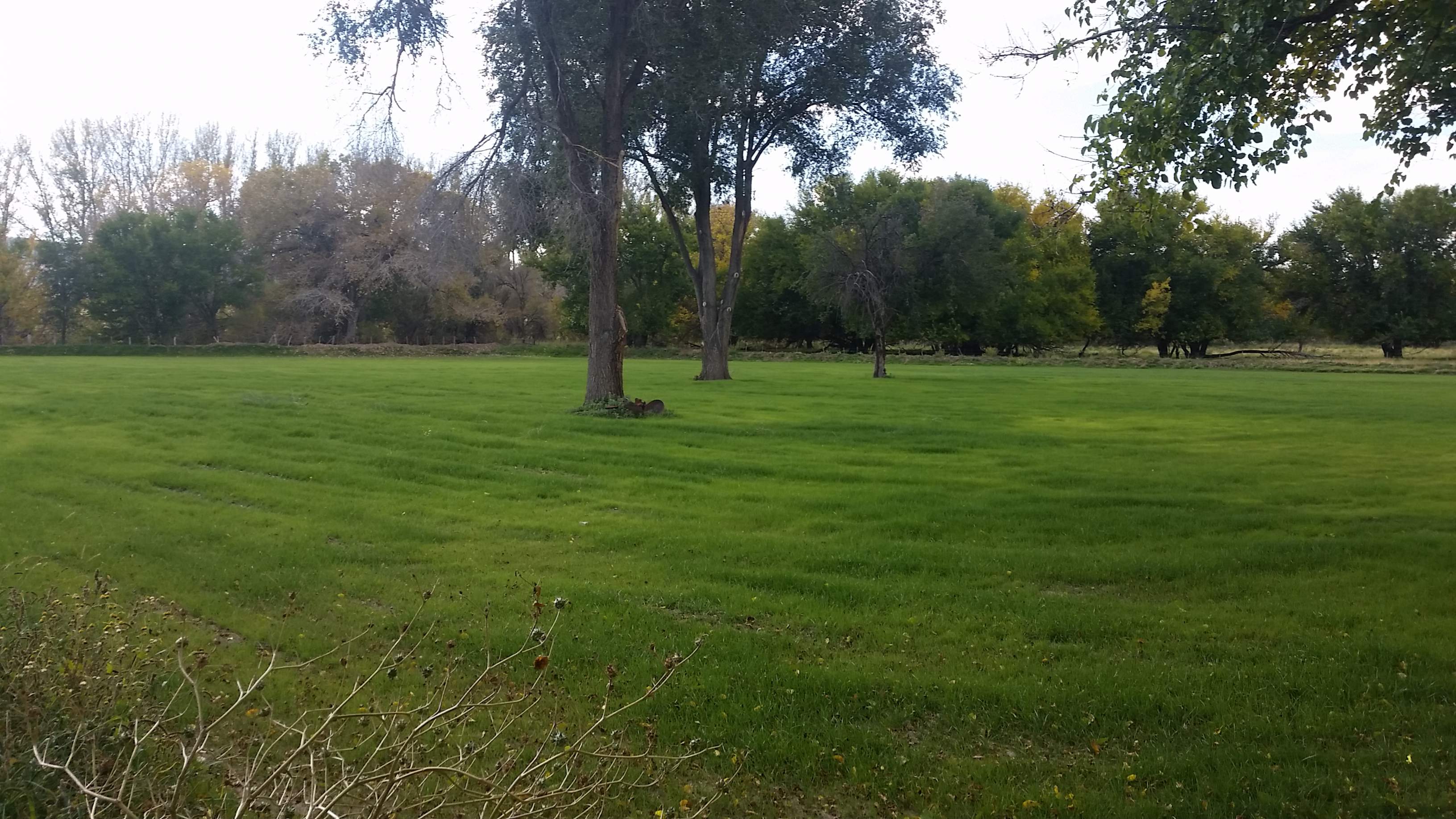

I cut through bush hogged fields often in my work with good results. I use a Deere 673 tiller with my 4520 but there are other good tillers such as King Kutter which are a lower price. Nothing wrong with used if it is in good condition. Some people think tillers are only suitable for a small garden, I disagree with this.
Here are some pics of a field I used my tiller on last year. It was a run down apple orchard where I cleared the old trees and stumps then tilled up, lasered to grade and planted in Fescue.
