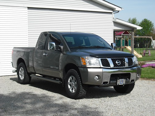

Well I did some checking and I hate to say it but its too much for even the Titan. The machine is shown at a weight of 8,350# alone and a 21' trailer has to be 2,500# alone. You add all the chains, ec and you going to be over 11,000#.
I would pass.
Here is a pic of my 08.
Chris
