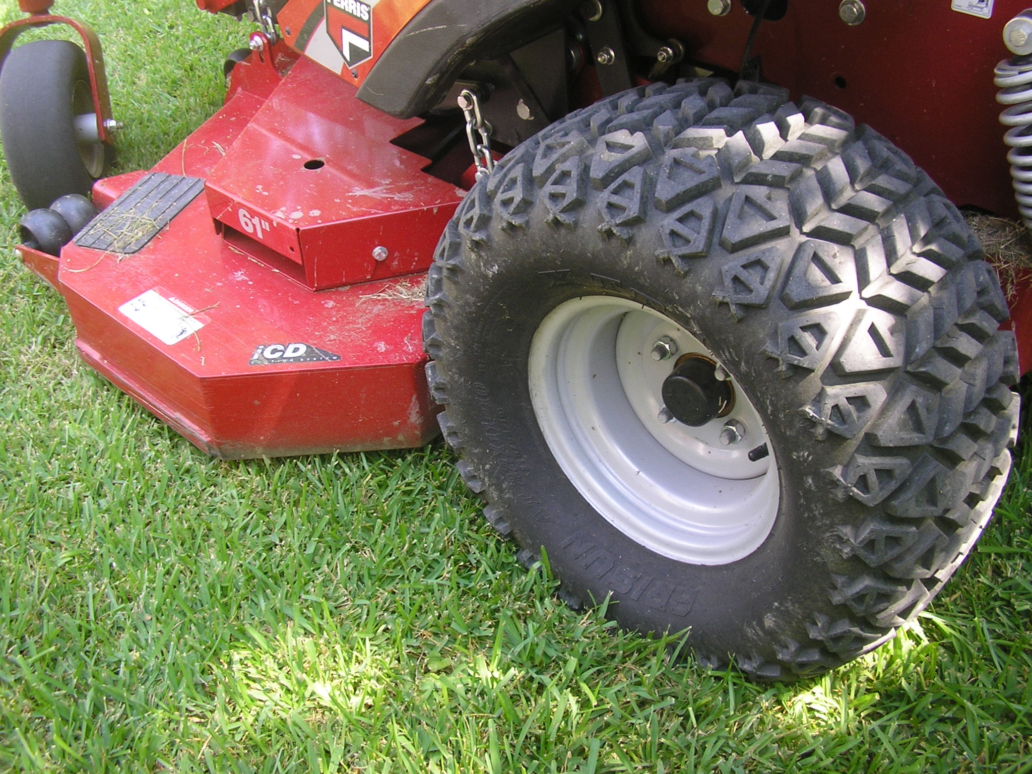

A 9.5 Tire will be taller than an 8.3 Tire of the same diameter. You can take that to the bank ,my friend.
I wouldn't bet on it. I know the allowable margin on car tires is plus or minus 5% from nominal stated size and I have personally seen that difference between tires of different manufacturers.
At one time I raced in the Street Stock class of Stock Cars and, since we were at that time limited to regular passenger car tires, knowing the circumference of the mounted tires was important and we tended to go through a lot of tires with used ones being best on our paved track because of the minimum amount of tread on them. Actually the rolling radius was what REALLY mattered but going by the circumference worked equally well and was super easy to do. Small changes could greatly affect handling.

If the reason is for more flotation you could just run them a little flatter and increase the length of the contact area. If you really want more flotation increase the width and run them flatter as has been suggested.

Quick GOOGLE search shows:
8.3-20 Tire is 895mm OD (35.2inch)
9.5-20 tire is 950mm OD (37.4inch)
See BKT Tires - TR 171 Product
What are you wanting to gain? What size & model are the fronts?
BTW, thanks for the reference to the BKT tire data site.
Do you have a special reason for quoting the OD? Normally when matching 4WD the RC (rolling circumference) is used.
