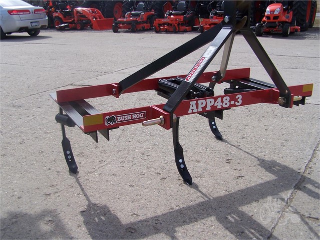

I’m looking at the APP48-3 for my new kubota l2501 hst 4wd. It says that it requires 24 pto HP which is odd to me since it’s not pto run. I have loaded r1 tires and a FEL so I think I’ve got plenty of weight. Do you think this tractor can pull those 3 shanks or will I be disappointed?

Depends on your ground. I have a jd 2025R which is a comparable machine and sometimes can pull 5 shanks all the way down on a box blade. Sometimes I can’t. Depends on the ground. I’d think you would be able to pull the 3 just fine as long as conditions were right. Can always make shallower multiple passes.
Edit: I thought was a b2501. An L2501 should have no problem.

I have been doing ground contact work with two HST equipped Kubota tractors for nine years. Never a problem with the HST transmissions. HST transmissions are used a many, many pieces of heavy construction equipment weighing north of 12,000 pounds.
I'm looking at the APP48-3 for my new kubota l2501 hst 4wd. It says that it requires 24 pto HP which is odd to me since it's not pto powered. I have loaded r1 tires and a FEL so I think Iエve plenty of weight. Do you think this tractor can pull those 3 shanks or will I be disappointed?

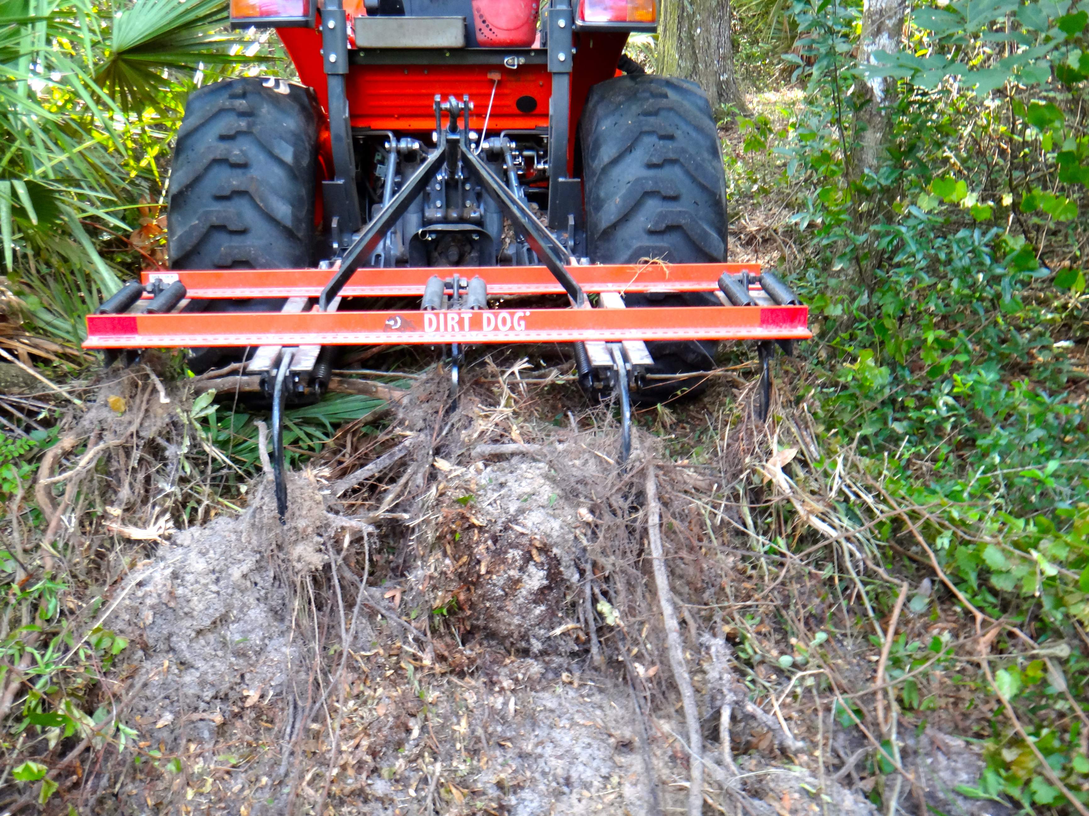

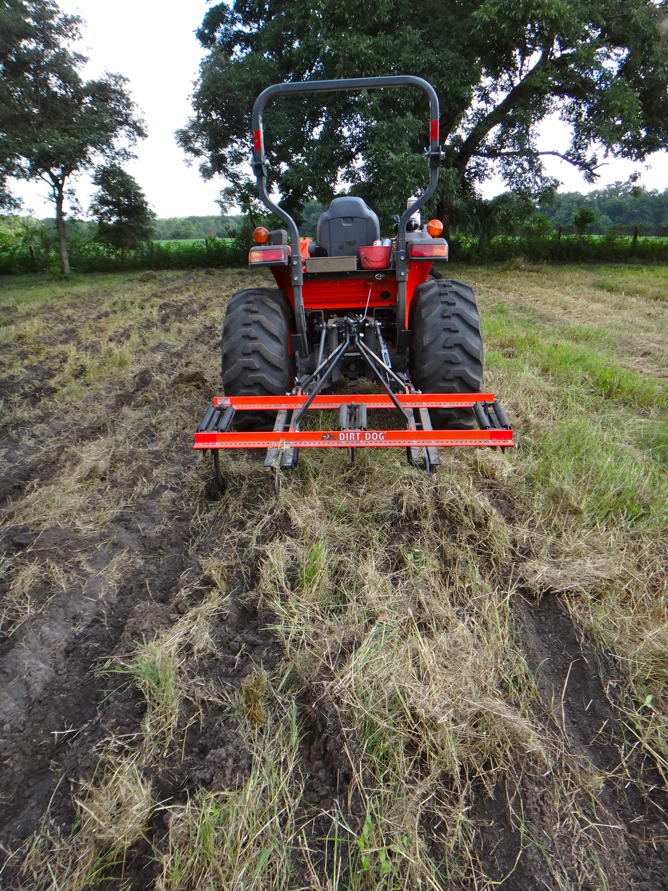

Do not fool yourself the BH/APP is a chisel plow. It is not.
You will have plenty of power and weight to pull a 3-shank APP, if the ground has not been compacted by animal hooves for years and if the soil is moist.
MORE: https://www.tractorbynet.com/forums/attachments/339095-dirt-dog-all-purpose-plow.html?highlight=
I believe the Field Cultivators branded as Bush Hog, Fred Cain and Dirt Dog are identical in source.
If you want a Chisel Plow for a compact tractor there is only one source in the USA that I know of, Buckeye Tractor in Ohio.
LINK: Buckeye Tractor Online Catalog Page 18-05 Chisel Plows

Most chisel plows will need 15-20 HP per shank depending on your soil and the conditions and how deep you are trying to go, 4" vs 8".
The reason that you see pto hp listed is the most small tractor manufactures do not list a drawbar HP just an engine and a pto HP.
The engine is a very unrealistic number while the pto is going to be closer to the drawbar .
The lighter duty unit you referred to should be usable with your tractor under the right ground conditions.
