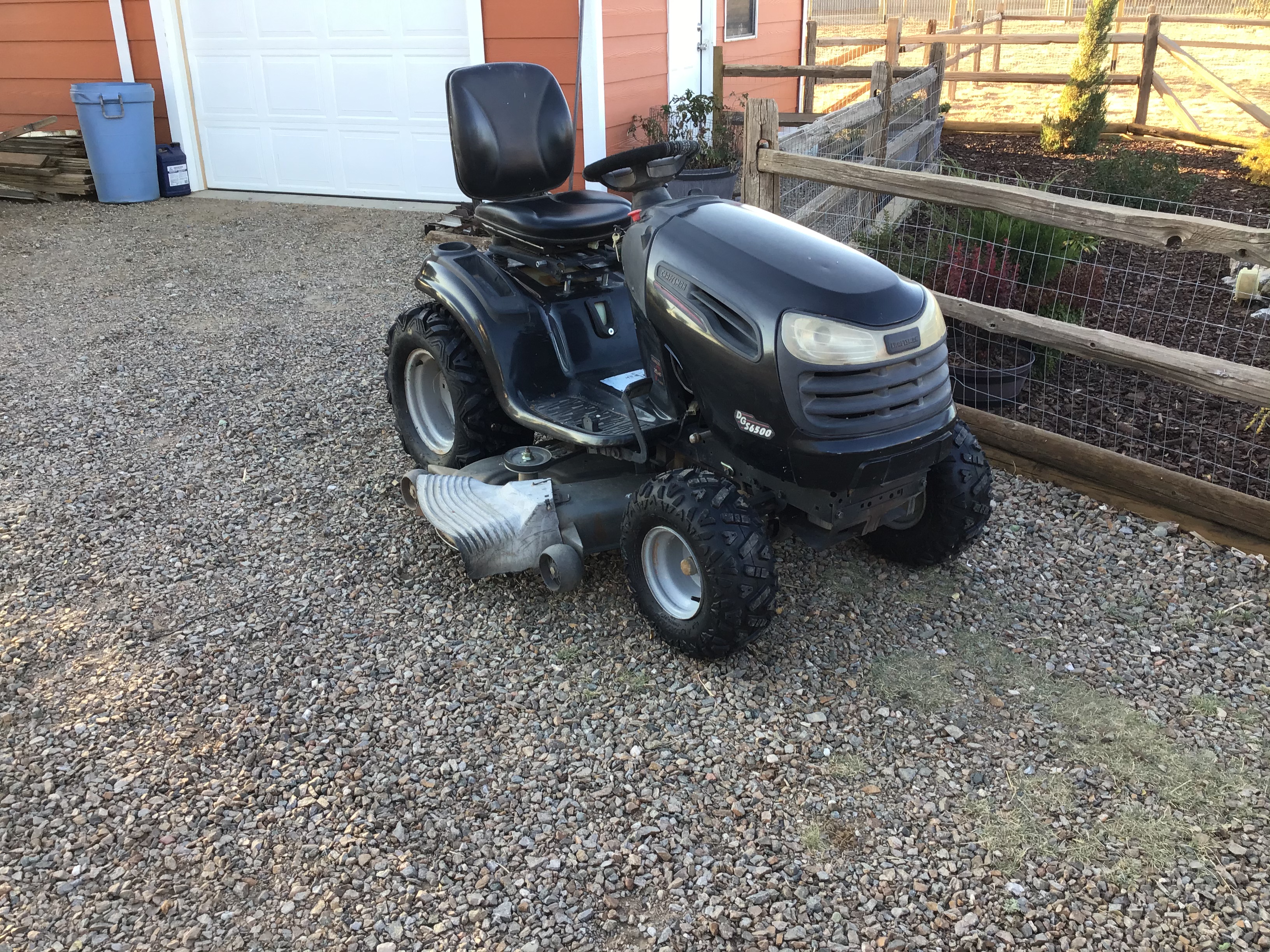

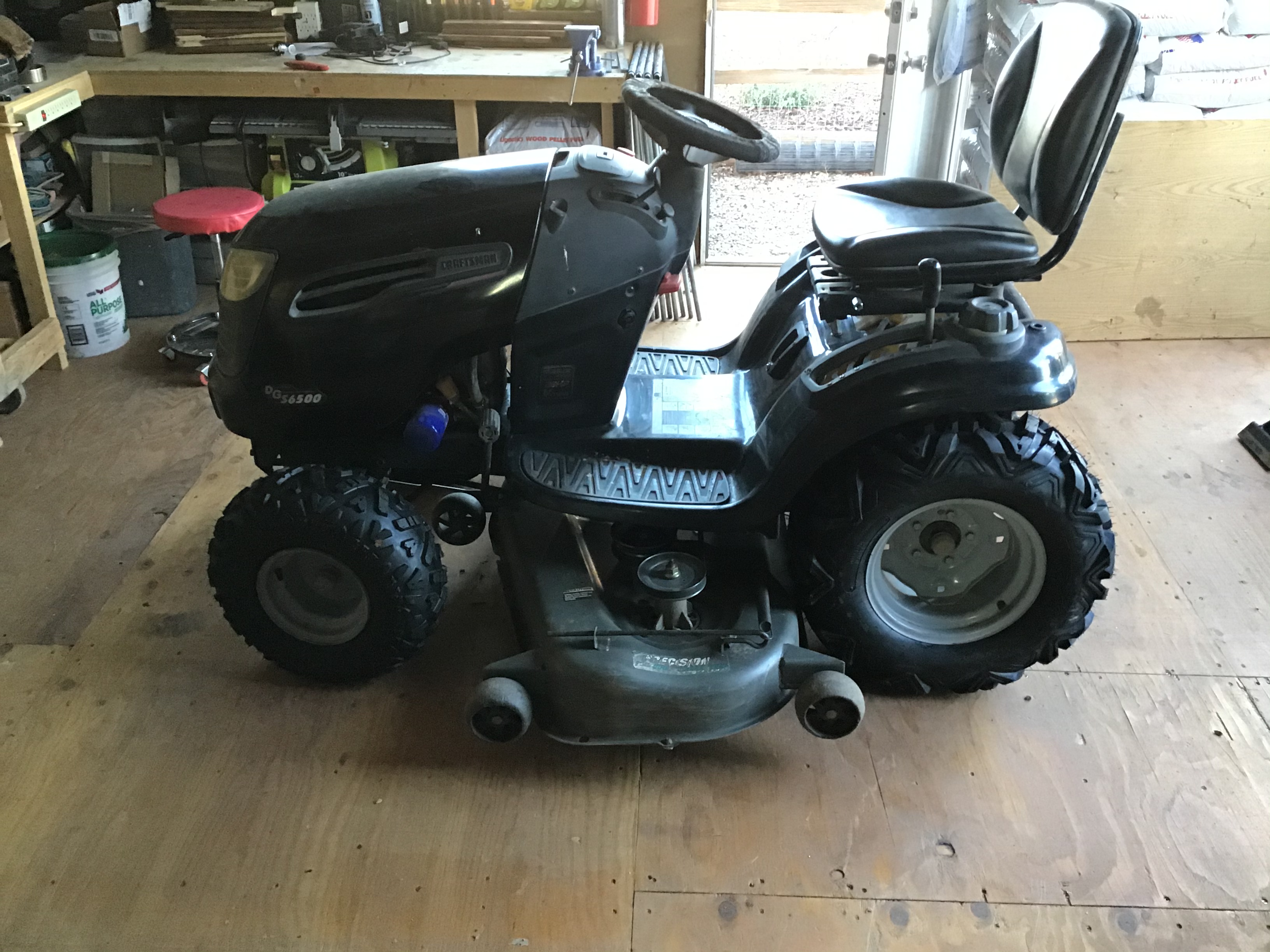

I just put 25x10-12 on my Craftsman, replacing 23x10.5-12. Worked great! Ride is better, no noticeable difference in power while driving. I also replaced the front 16x6.50-8 with 19x7-8. Steering is easier and not as 'bumpy'. I did have to relevel the deck from front to rear. Here are a few pics:
