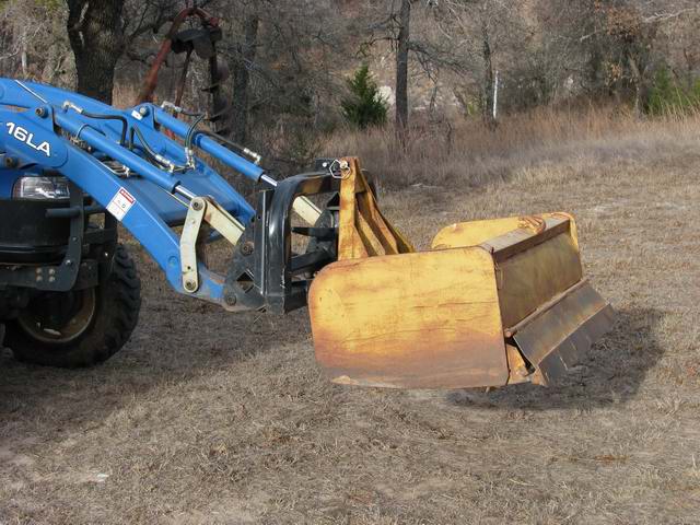

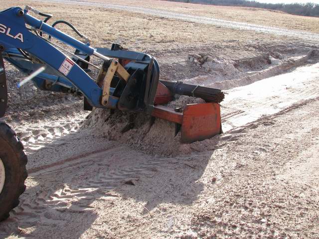

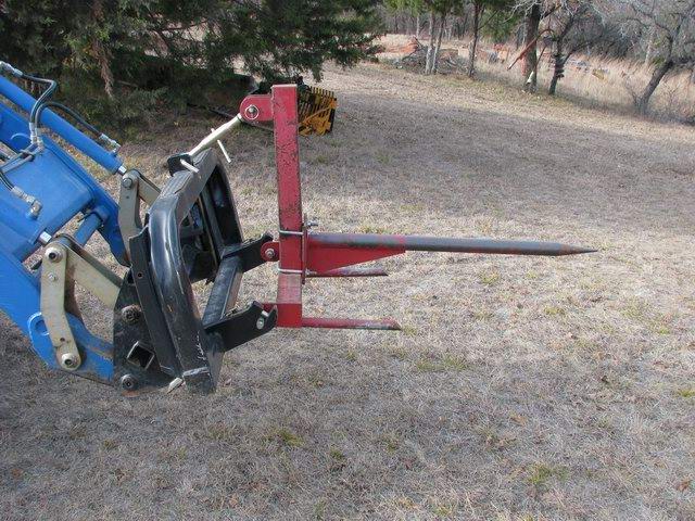

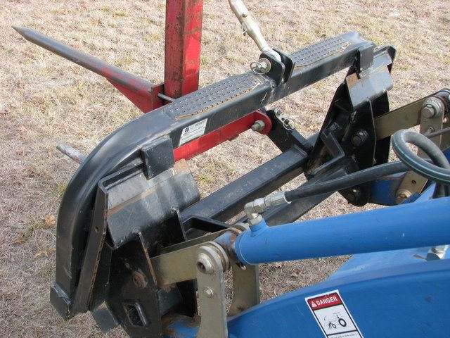

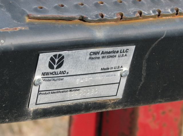

Well, the weather today was beautiful and I decided to play with my FEL-3PH adapter. My first few pictures are of the adapter with a bale spear. I also have a CNH nameplate that shows it's an OEM certified attachment.
I tried the adapter with my yellow boxblade that has captive pins and ran into a problem. The claw is too thick to clear the boxblade. I'd need to grind a little off the claw or off the boxblade to make this work.

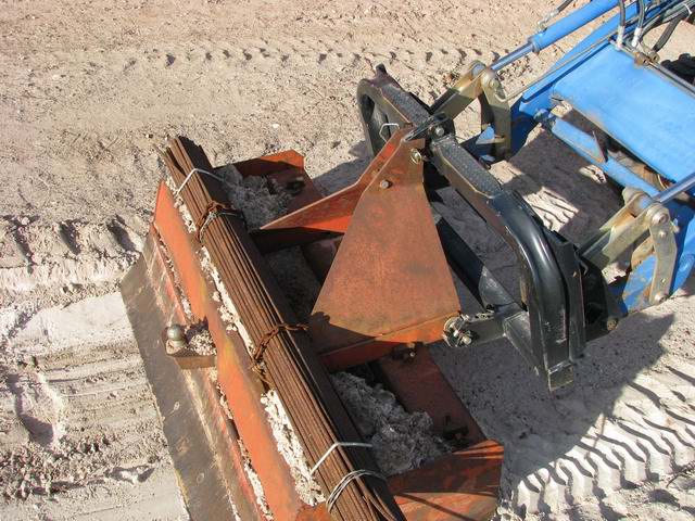

My red boxblade worked fine. Everything lined up and the blade worked just fine as shown in the pictures. I also used it in some red clay and dug with the scarifiers by curling the boxblade so only the scarifiers dug into the ground. It worked okay and I loved looking forward to view the boxblade in clear view, but not being able to tilt the blade made it less adaptive than on the 3PH where I have TNT. It also really looks goofy hanging off the front of my tractor.:rolleyes:
