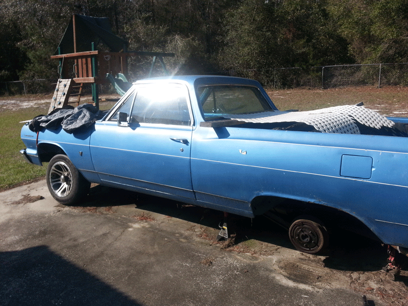

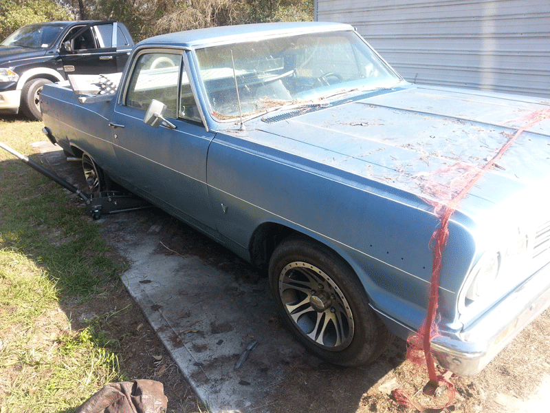

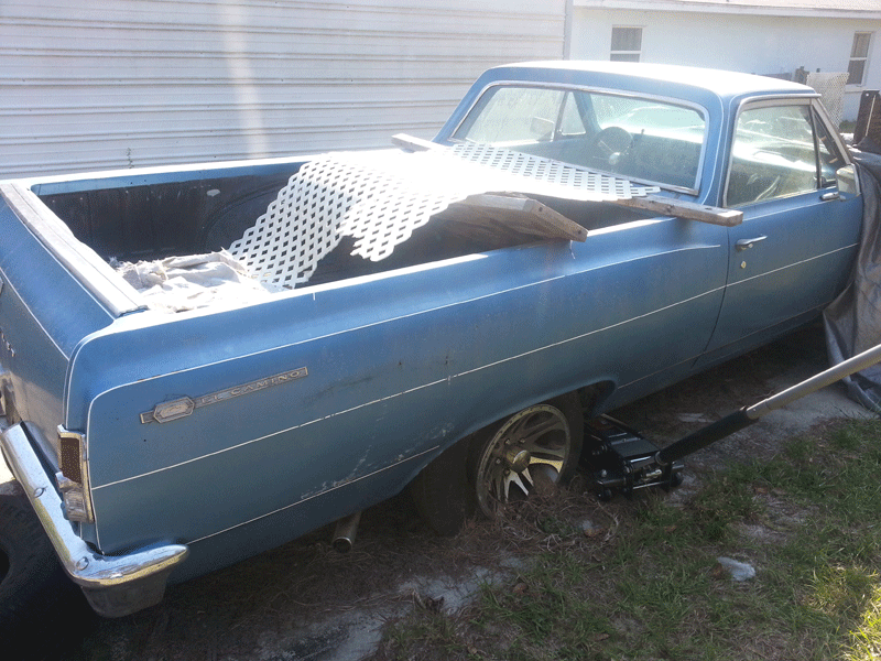

Here is what we're starting from. The Wasp nests were under the junk that was in the bed, behind the gas filler door, and on the engine. I may discover more as I go, so my new best friend is the can of Wasp spray.:thumbsup:

Nice looking project! I'll echo the 50/50 mixture from Murphy...cheaper than Marvel Mystery Oil probably, also. Be sure to post some pics as the project gets moves along.
   / Can I use Sea Foam like I would use Marvel Oil? #7
The body looks to be in good shape. Nice little car/truck vehicle for collector. Too bad that Chevy didn't build them with enough suspension to really haul something which is what caused the demise. Trying to make a car into a truck just doesn't work too well.
   / Can I use Sea Foam like I would use Marvel Oil? #8
That is going to be a nice ride, Take your time and enjoy.

Your right Gary, it is not much of a truck wannabe, but will be fun to take to the car gatherings that occur around here. Hodge - It has dropped back down to being in the low 40's overnight for the next few days, but in the 70's during the day. I gotcha on the Sea Foam and ended up getting Marvel at Napa. The engine is actually not in bad shape, but we decided to take it out, get new headers, and do the body/paint work before re-installing it. That way it will be easier to redo the paint in the engine compartment, redo the wiring, and clean up some rough looking stuff.
