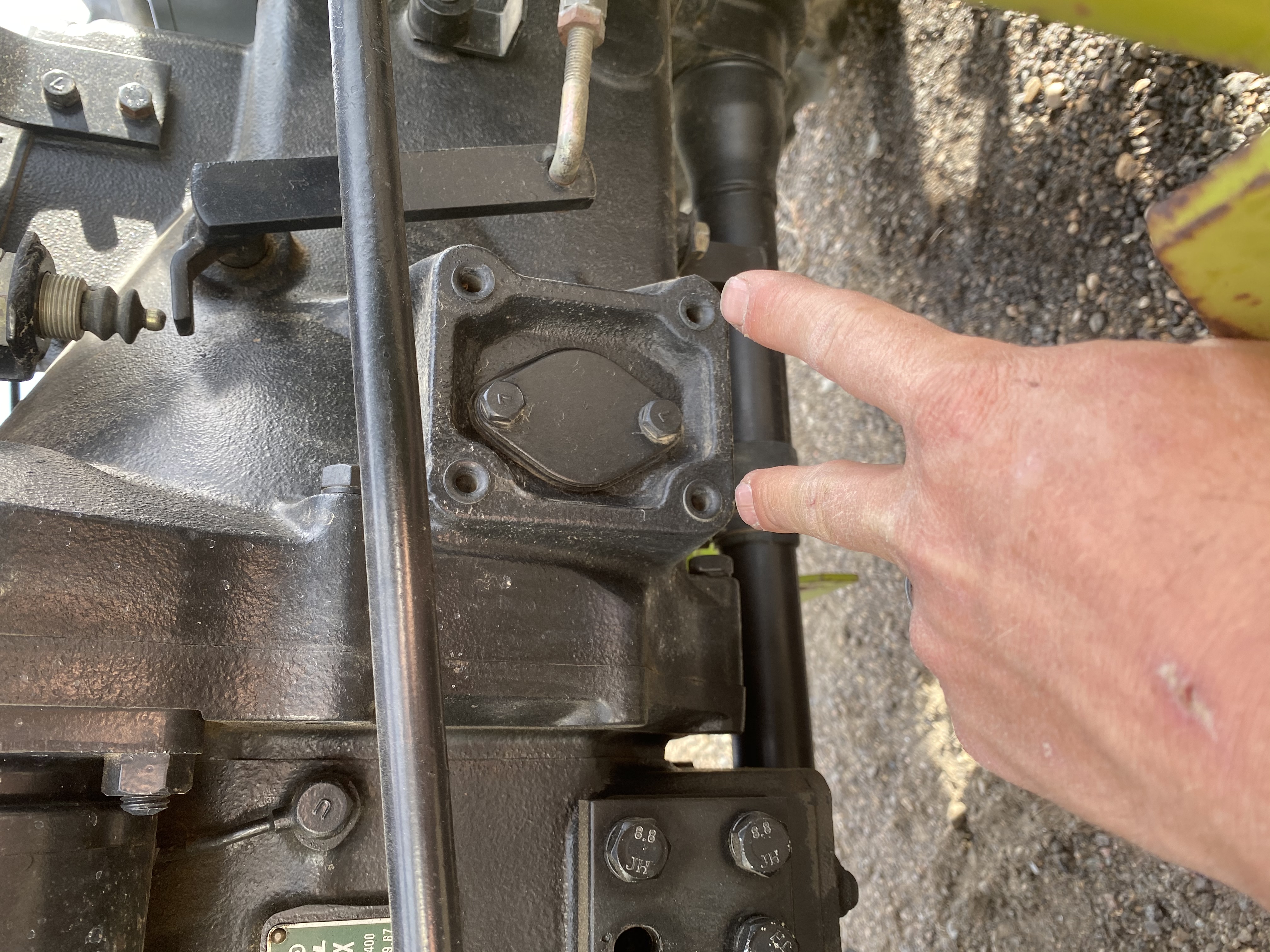

I need to see if anyone can take some detailed photos of how their YFL240 loader subframe is constructed and attached.
I got a loader for my machine but it痴 missing the entire subframe. I値l need to build one.
I can see how the front frame is constructed and understand how the rear is done I think, but would like some detail on how the center main lift portion attaches to the machine.
I attached a photo of the 4 bolts I feel like it would attach to, but I知 not too sure. 08A8DDD6-13A9-4E75-A575-8363331724E0.jpeg

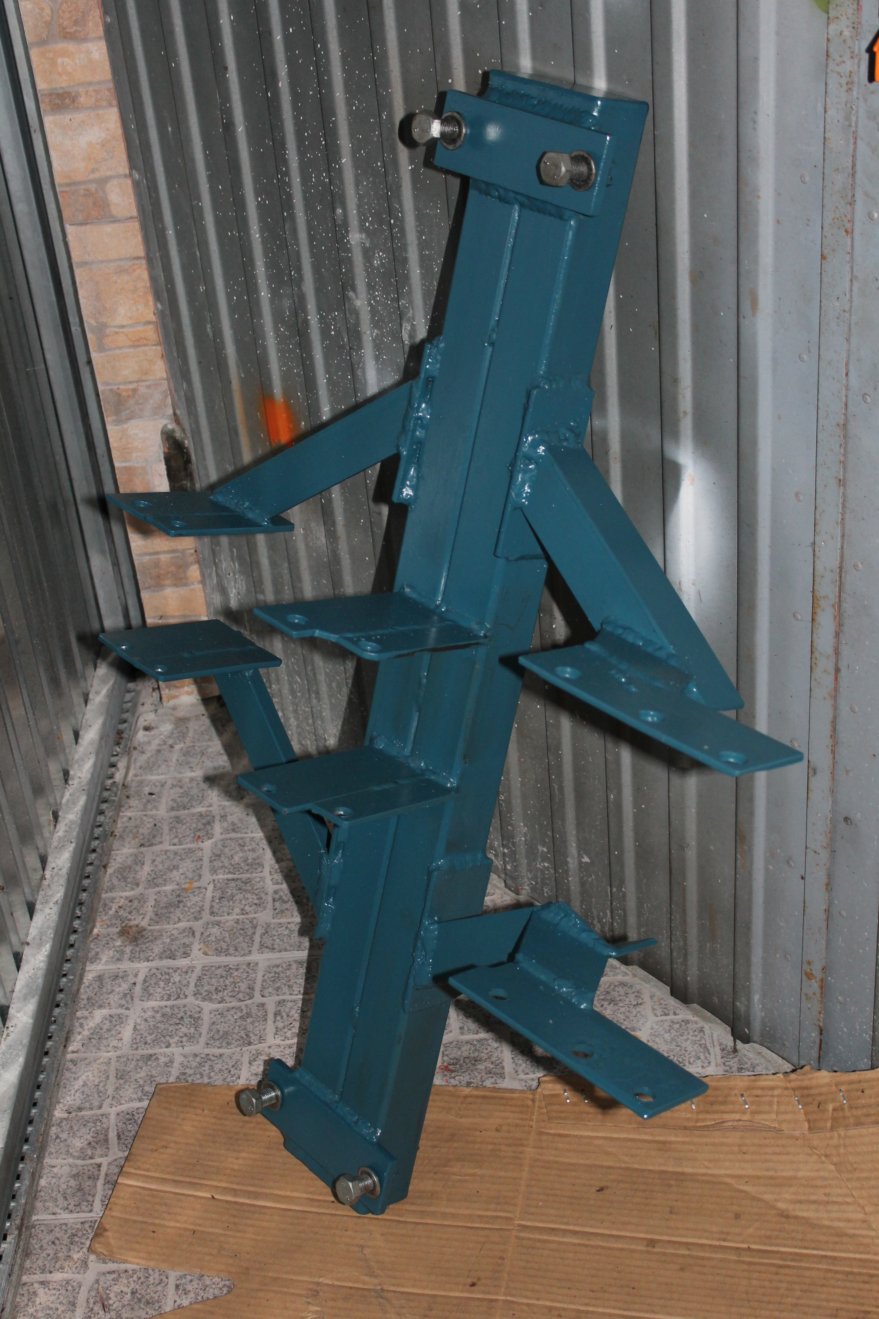

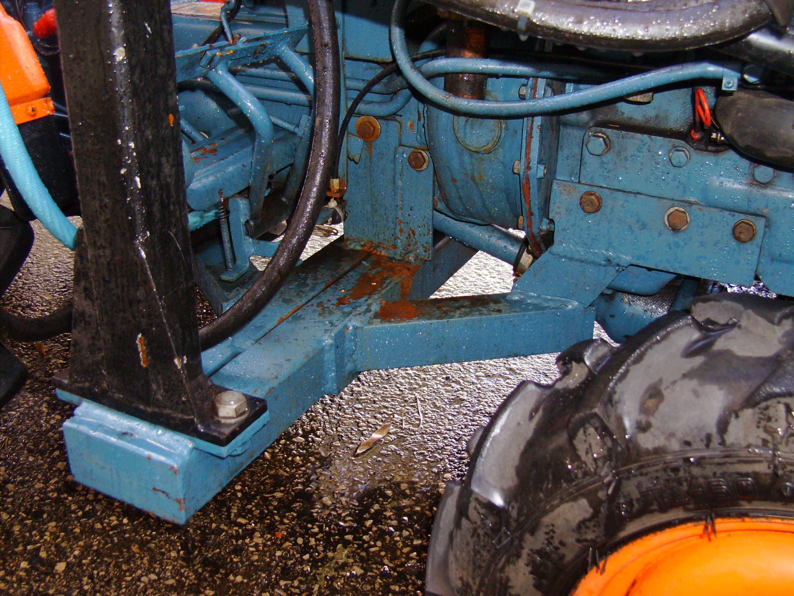

While I didn't have a Yanmar, I had a Kubota B7000 a few years ago which is more or less similar. I made the entire loader from scratch.
Here is what I came up for the subframe:
Basically, I'm tying up the engine and bell housing all together.
In you case, I would use those 4 bolts you showed on the picture, along with those from the engine block (requires longer bolts). And if possible and the tractor has those, a couple holes on the bell housing but towards the rear.
