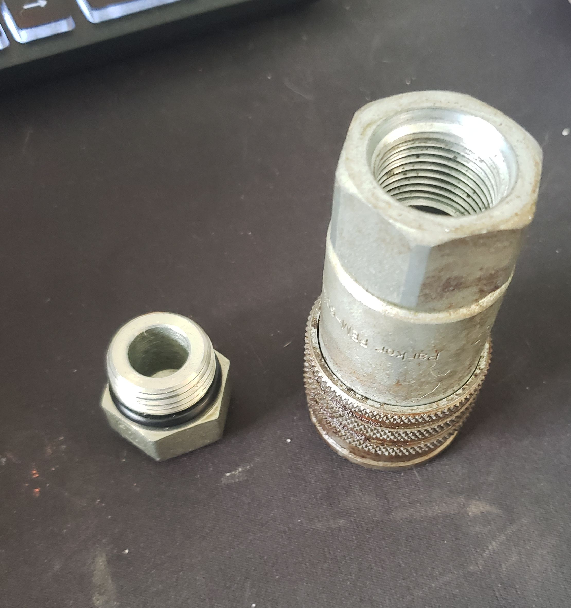

Hi.

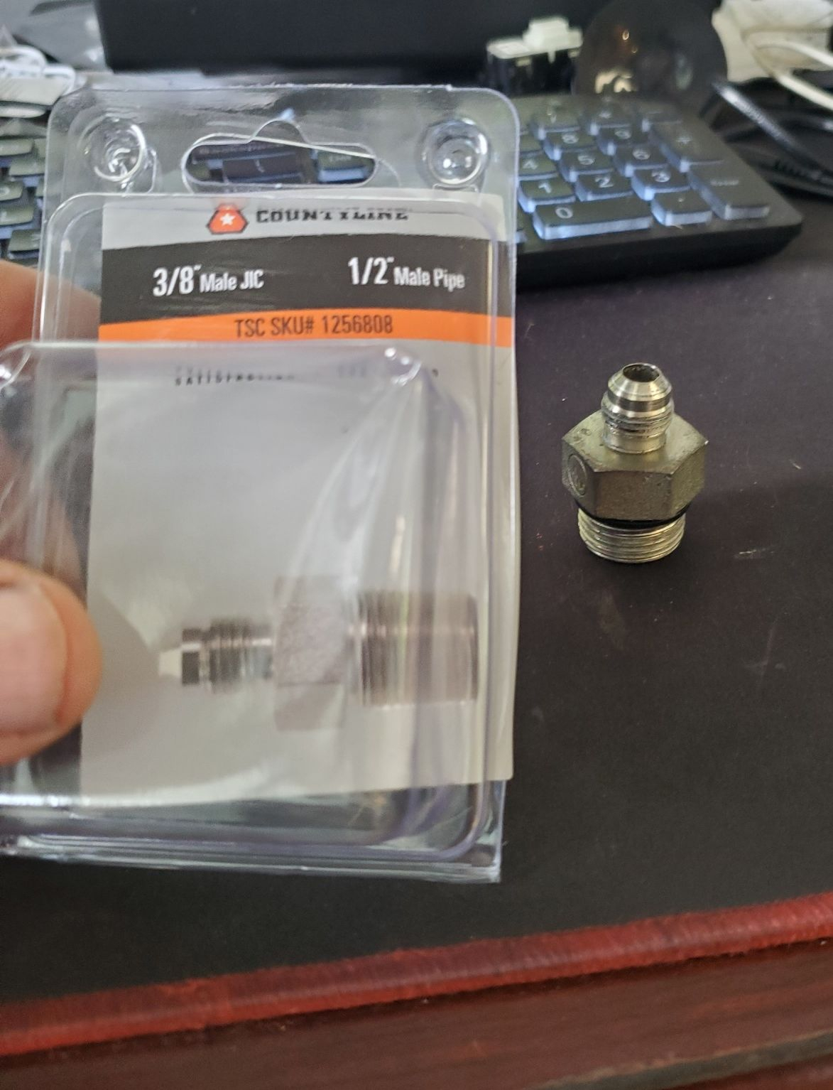

I have a bobcat T650 and this connecter has snapped, it is where the 2 hoses come from the bobcat to go to the bucket controls.
I know the small thread is 3/8 jic male but need to know what the other thread is please. I bought one with 1/2 male pipe on the other end and it does not fiot.
thanks in advance
Terry
   / Can someone tell me size if this hydraulic connector please #2

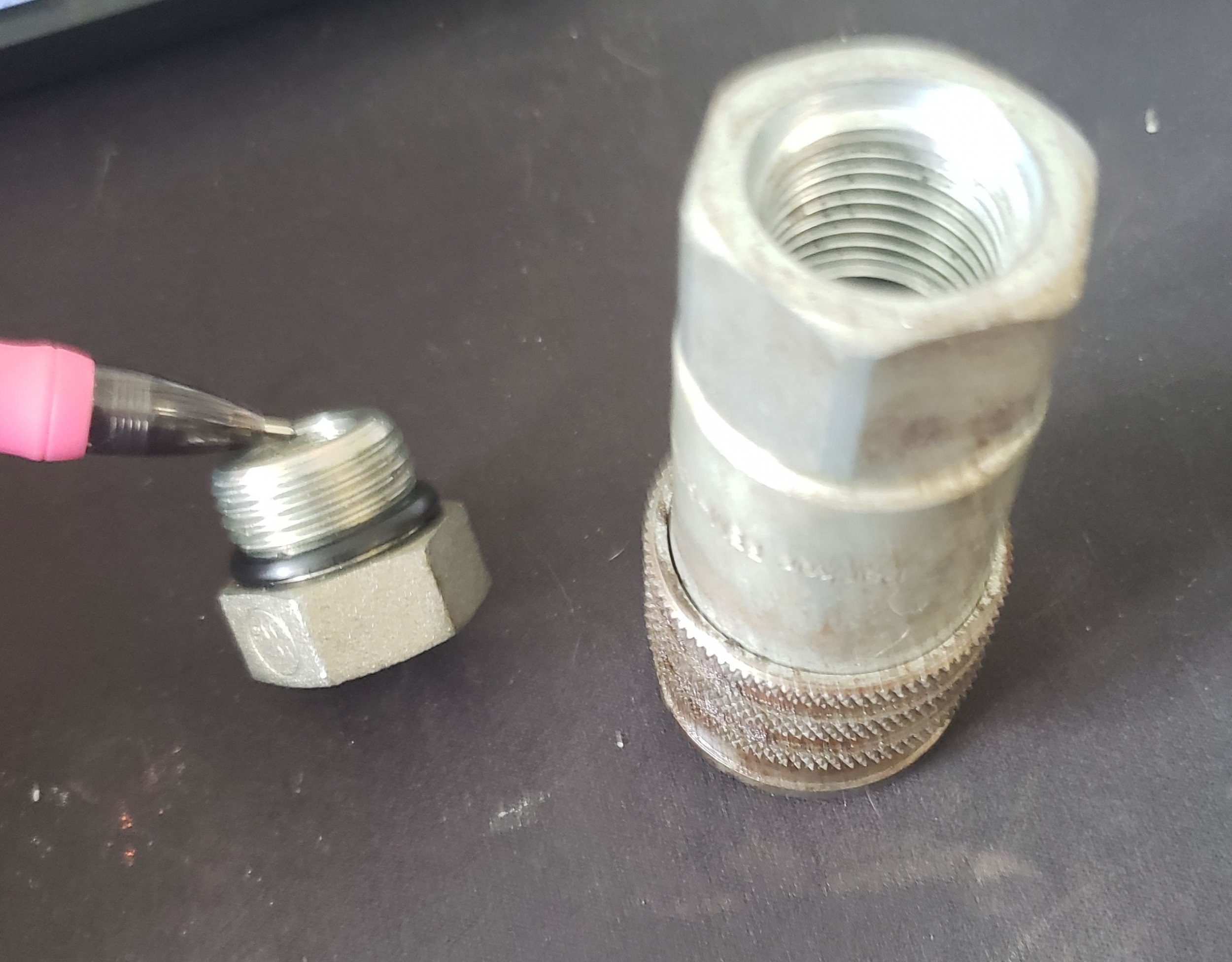

The oring is a orb fitting oring boss. If its a 7/8 thread it's -10 or 5/8 pipe. If it's 3/4 thread it's --8 or 1/2"
do these pics hlep narrow it down please (they show the quick release connector it came from

The numbers stated on the side will tell you what it is. Need thread size to know for sure.

You either need a 6400-6-8 fitting or 6400-6-10
   / Can someone tell me size if this hydraulic connector please #7
I would look up specifications from numbers imprinted on connector...

OK will take to the store thanks, was hoping to order online but that does not seem possible
   / Can someone tell me size if this hydraulic connector please #9
Go to the store and find what size and thread it is then you can look online if you want. Probably just as cheap if not cheaper in the store though.
