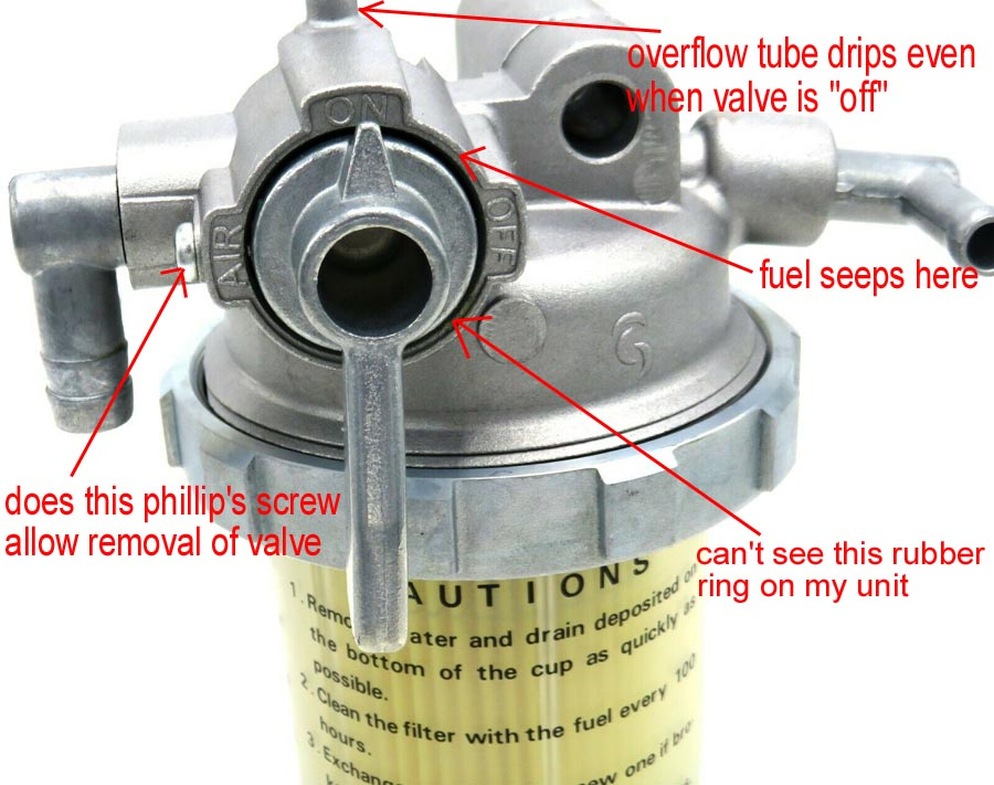

Hello to all the wonderful and helpful tractor folk on here. I am stuck with this "situation" on my 1996 Massey 1250.
About a month ago, I was doing my typical walk-around and noticed a strong diesel smell from the tractor. I saw a diesel spot on the ground (about 5" across) under the fuel filter area. I found a slow drop from the overflow tube. This has NEVER happened before. This tractor has never leaked anything from the engine.
So I changed the fuel filter, bowl gasket, and o-ring up inside the housing. When I was bleeding the air, the valve would not stop a steady drip unless I turned it to about 11 o'clock. It still drips slowly.
And now when I gun the engine a little, there's black smoke at first then it goes away. Is this from too much air from the valve being offset?
Since I'm paying so much attention to the filter housing, I've noticed a seepage of fuel around the valve handle. It's very slow, but it's there.
My thought is that maybe there is an o-ring or gasket behind the valve handle? The one on the tractor doesn't show a gasket like the new one in the photo. There's a screw that looks like it goes directly into contact with the handle, so is that a way to remove the handle and repair a leak? Would a faulty "seat" cause the overflow to leak like a water spigot that drips?

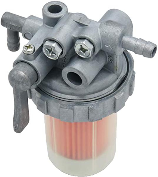

This is an OEM replacement, but it's $178 !!!! Holy cow!
I found a different model that looks similar, but is missing the overflow tube stub. And it has 2 other screws that I don't know what for. It's less than $100
What do you guys think I could/should do? My budget is tight (living on SS) so the less I spend, the happier this old gal will be ☺️
Fuel water separators are universal. Just find one with right flow characteristics. For example I'm pulling out a Racor 900 water fuel separator (super common for like 40 years) and replacing it with a different Racor that includes a priming pump as well as a fuel heater. This one here looks like Racor 500 size.

Looking at first post. First picture... Yes, I believe that removing that screw would let you remove the valve handle.
Rotate the handle counterclockwise to bleed it "AIR", rotate clockwise to "OFF". Straight down is run mode.
Second pic...
Any setup with a shutoff valve and a bleeder system would work.
Leaks out front AND out the overflow when in the OFF position. Sounds like two O-rings pooped out. If this filter is above the fuel tank, you should be able to disassemble without losing too much fuel.
