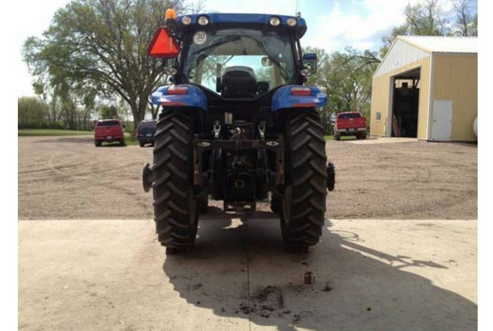

Unfortunately, that 65.7" width specification is already with the AG tires mounted on. The R4 Industrial and Turf tires all will be increasing the width of your tractor. There are special tires even more narrow than AG. That's what you would need, and they are made only for row cropping tractors and orchards and grape vineyards. You would need special rims.
Tractor - Keltgens Tall Tires

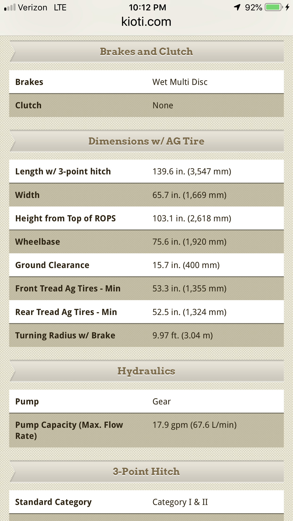

So what does Ag Tire tread Minimum mean? See photo below.
   / Can width of Nx series be narrowed? #5
The AG minimum measurements are the inside width of your AG tires. Just like if you crawled underneath your tractor with a tape measure, and measured from tire to tire. The 65.7" width for AG tire, is the outside width, or maximum width.
Here is an example of a narrow tractor tire.

Thanks for your response. My understanding of tread width is measurement from center of tires. So if you add the width of 1 tire that gives approximate total width not allowing for some sidewall bulge. I am wondering about a 12.4x24 or 11.2x24
tractor tires? Not sure if cost to swap them out is worth the 1-2&1/2 inch narrowing effect.
