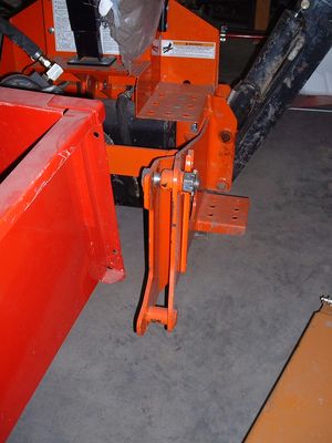

KennyV,
I have a L3430 with a cab and have my Woods BH mounted on it. Woods came out with a sub frame that replaces your loader arms that attach to your rear axle. Here is a picture of the Woods tractor attachment.

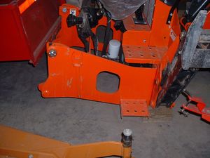

   / Can you have a Cab with a BH-90? #5
KennyV,
Here is a picture of the Woods BH attachment. This attachment enables you to get the hoe away from the tractor far enough so the seat doesn't hit the rear cab window.
Bill

   / Can you have a Cab with a BH-90? #7
Not sure if any of the aftermarket cabs work but the factory doesn't. Of course the BH-90 could probably be made to work with some serious cutting and welding on the attachment side. Looks like that Woods subframe is real close to the BH90 subframe position but the extension on the BH frame is longer under the operator. At least that's what I'm seeing. Guess that's what pushes it back from the cab. Lots easier to buy one that works though.
