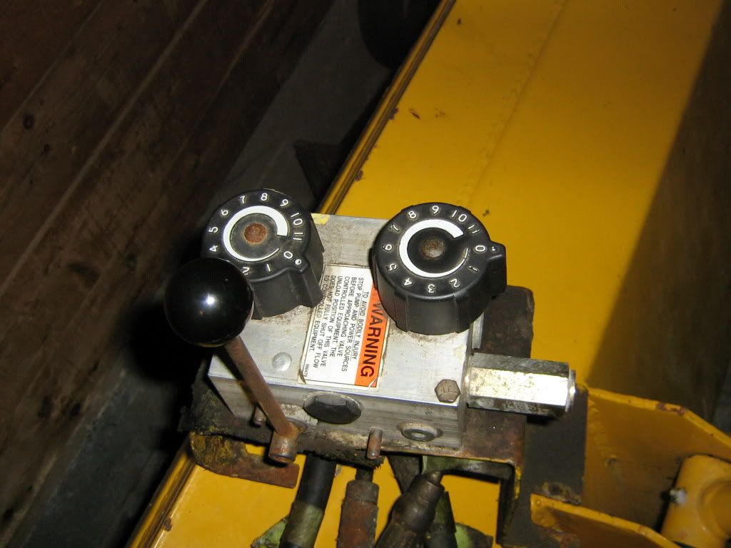

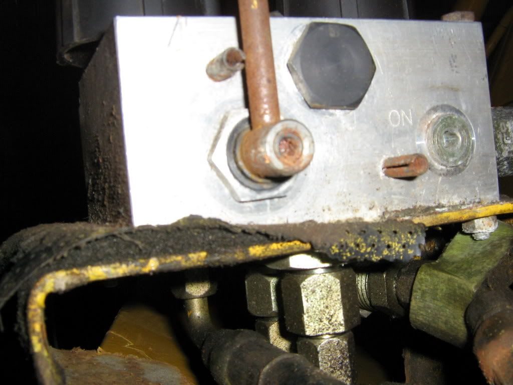

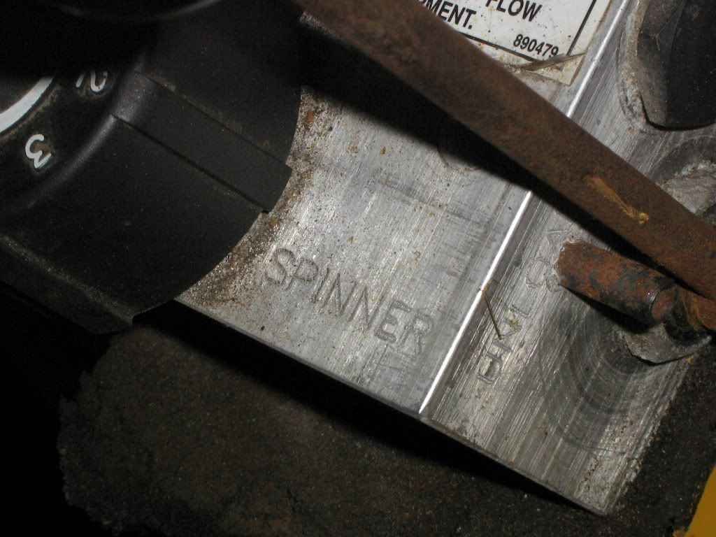

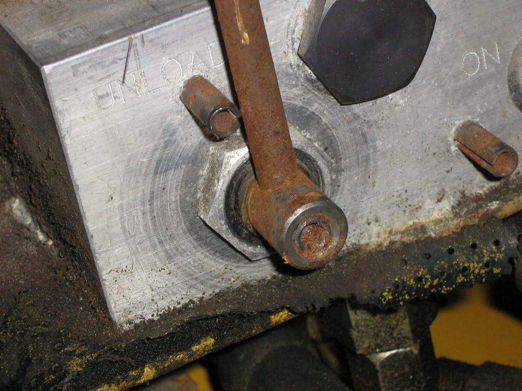

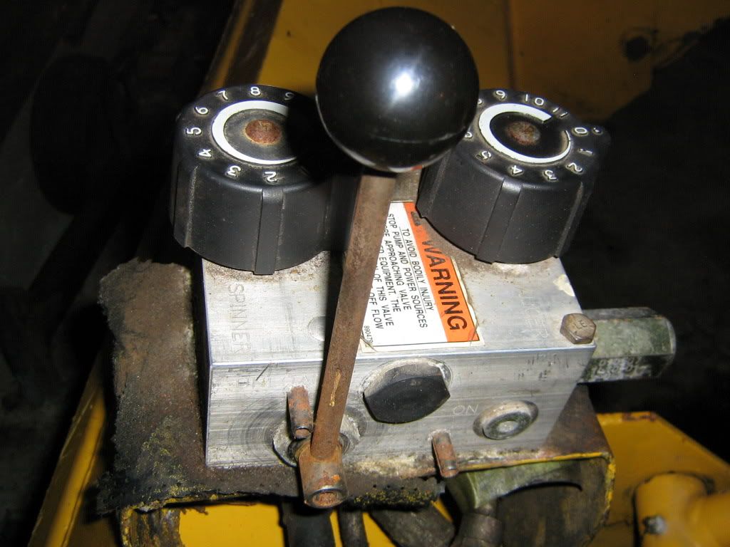

Hi Guys. I was wondering what is this component is called and what it is used for. I am assuming it controls the hydraulic flow but normal flow control dosen't have the 2 ajustable knobs on top. It was used in my tractor to power the backhoe.
Let me know if you need any more pictures.

Looks like the flow control to a truck mounted sand spreader. One dial for convayor speed , one for spinner speed and the lever to turn it on and off.

What he said!:thumbsup:

It looks pretty much like your Buyers spreader valve. Thanks for the input.
