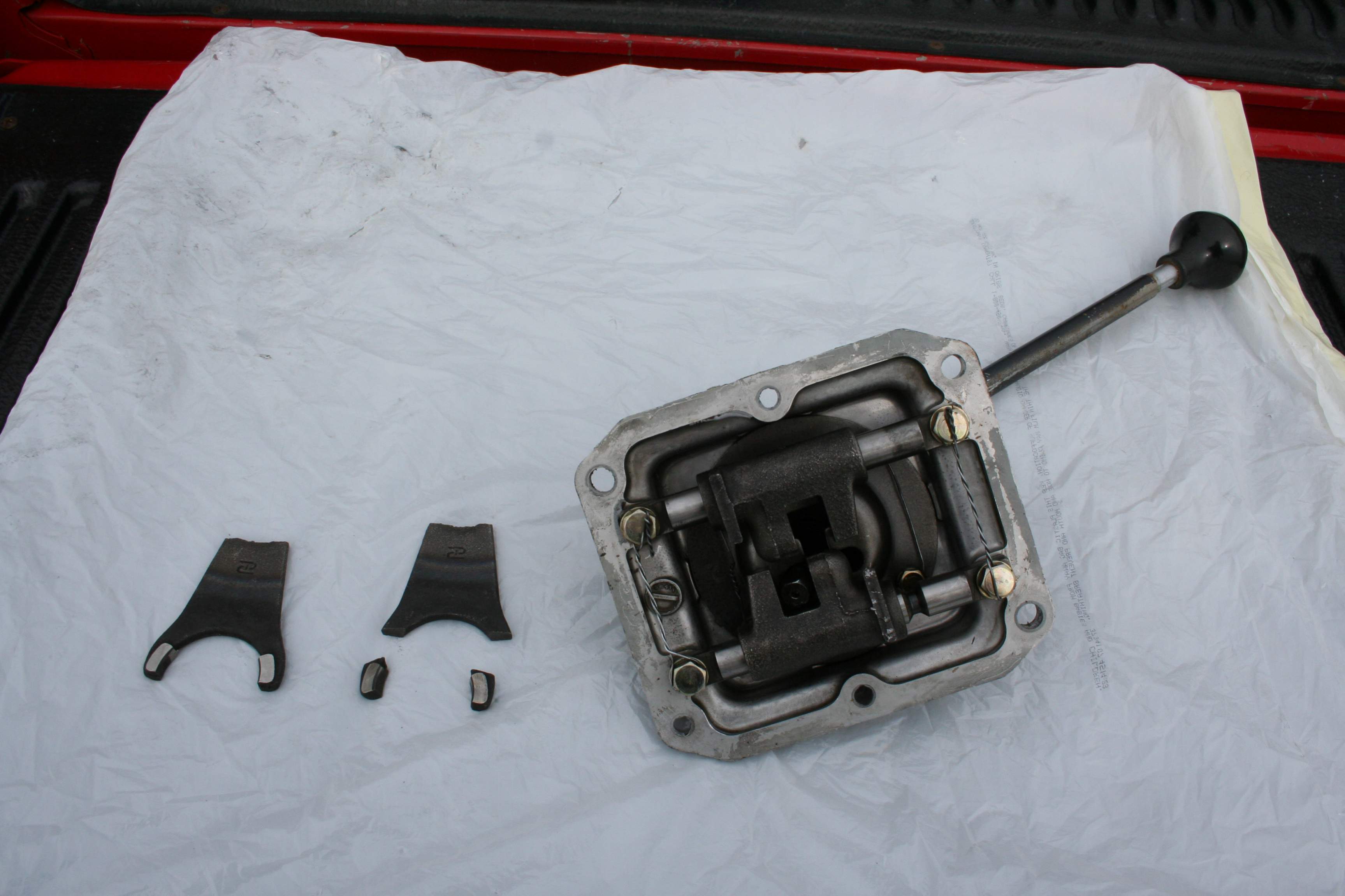

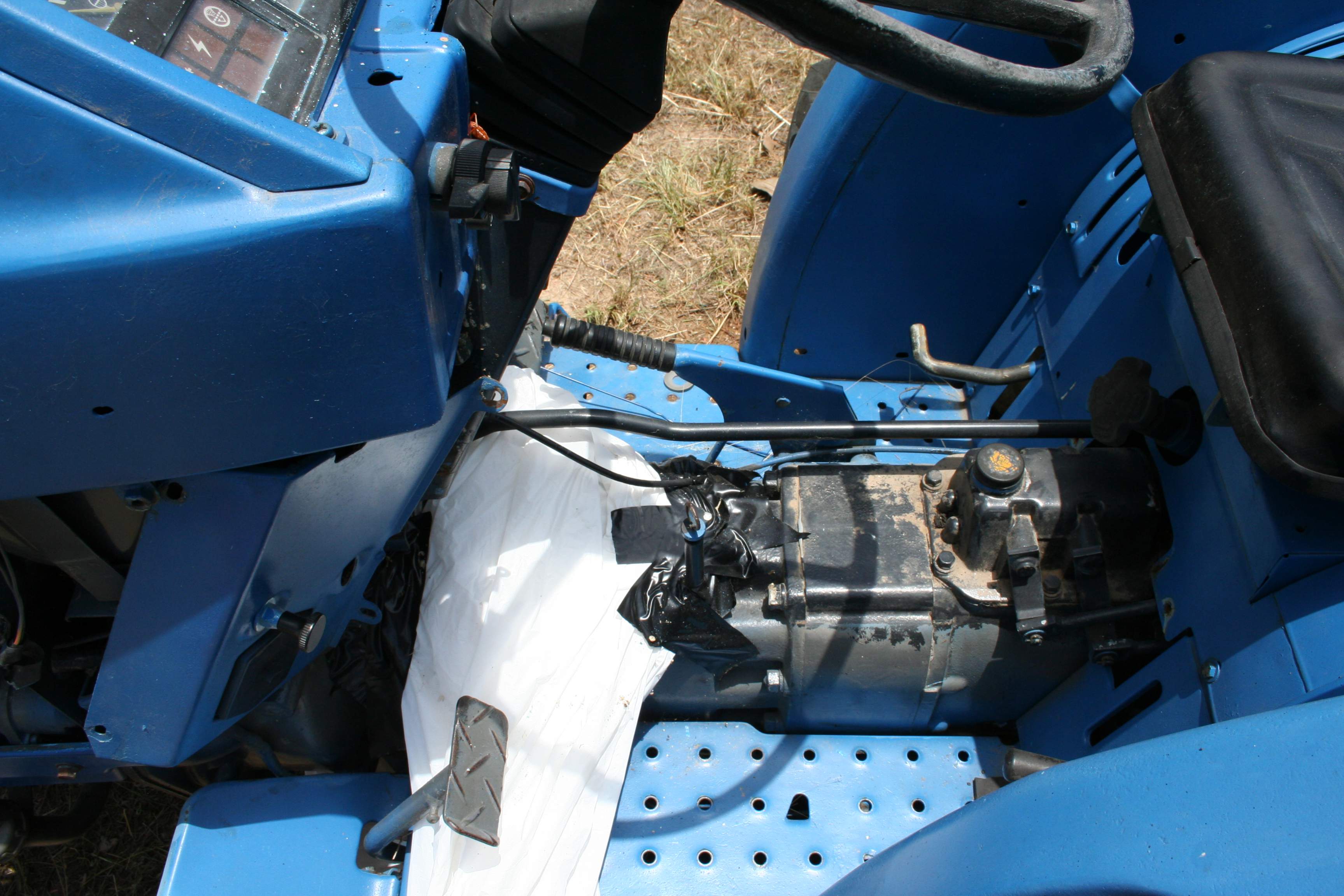

I have scoured every inch of this Iseki (purchased from an individual who didn't have much info) for some ID that will help me purchase much needed shifter.
My tractor has become a yard ornament! The numbers I can find that resemble any model I've seen online is TL1-00101 . The 00101 is on a small plate near the front by itself and then again with the TL1 on right side of transmission case. On bottom of case is OD12. Right side of engine is 3AE1 ....then
1.296L. Under seat is M1m. Under hoos is 5-1530 . On front it says Iseki and below that says Kota. You would think one of these would identify this machine but I have had zero luck . SOS SOS SOS

The tractor could be a TL1900, TL2100, TL2300, or a TL2500. The 3AE1 refers to the 25hp Isuzu engine. Is the tractor white or blue? Also, do you have a photo that you could possible post, that would most likely help me identify it for you, but it sounds like it is probably a TL2500. This is what the 2wd and 4wd TL2500 looks like, let me know, and I will help you look into it further. Also, what shift level do you have to replace?:

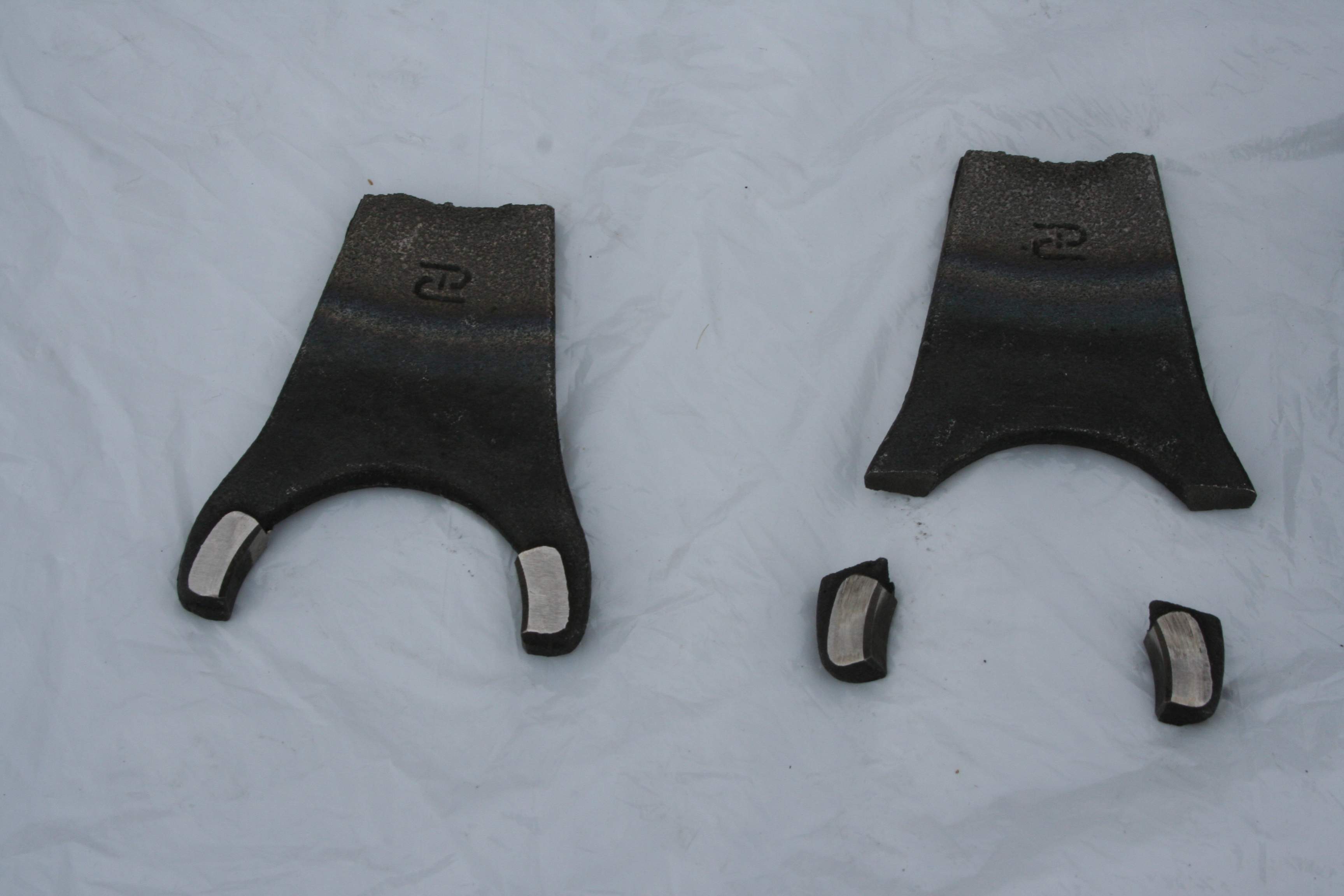

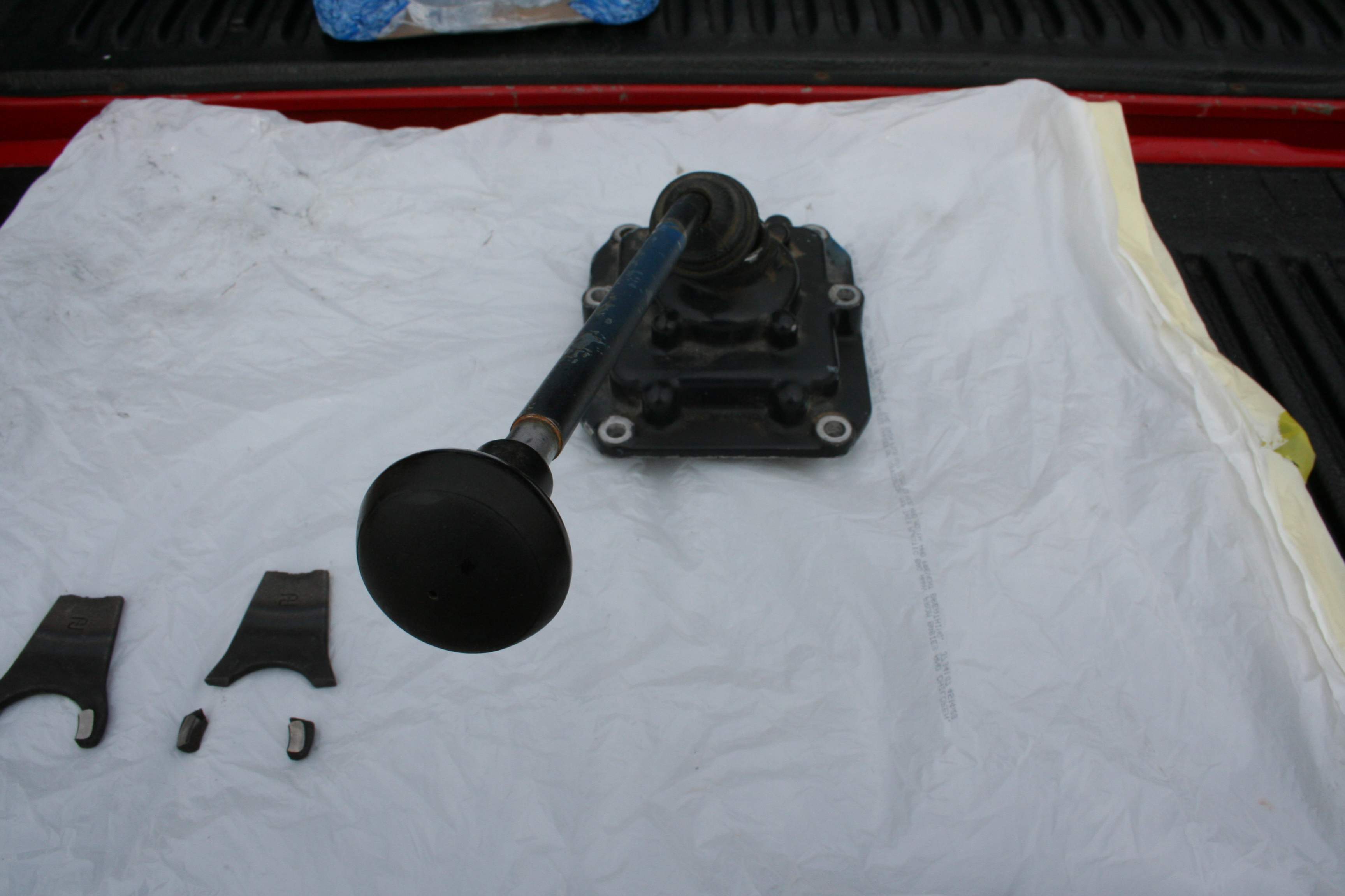

Thanx for your response ! The TL2500 w/o the loader looks identical to mine except my front grill says Iseki and to the right of that Kota.The part I need is the main shifter under the steering wheel. The cast iron mechanisms attached to the main shifter (don't have a clue what they are called)are broken off as you can see from the pics I will post.I can physically move the gears with my hand while clutching so I think I'm ok. When I determine which machine mine is I will also be in the market for a service/maintenance manual as well.This is my first tractor and it was purchased from an individual who didn't have any history of it. Wow , you learn real quick about buying a so-called grey tractor!!! Any help will be valuable and much appreciated! MB I'm gonna send this response now and pics later , gotta run!

This looks like a TL2300, which is what I have. A great tractor.
