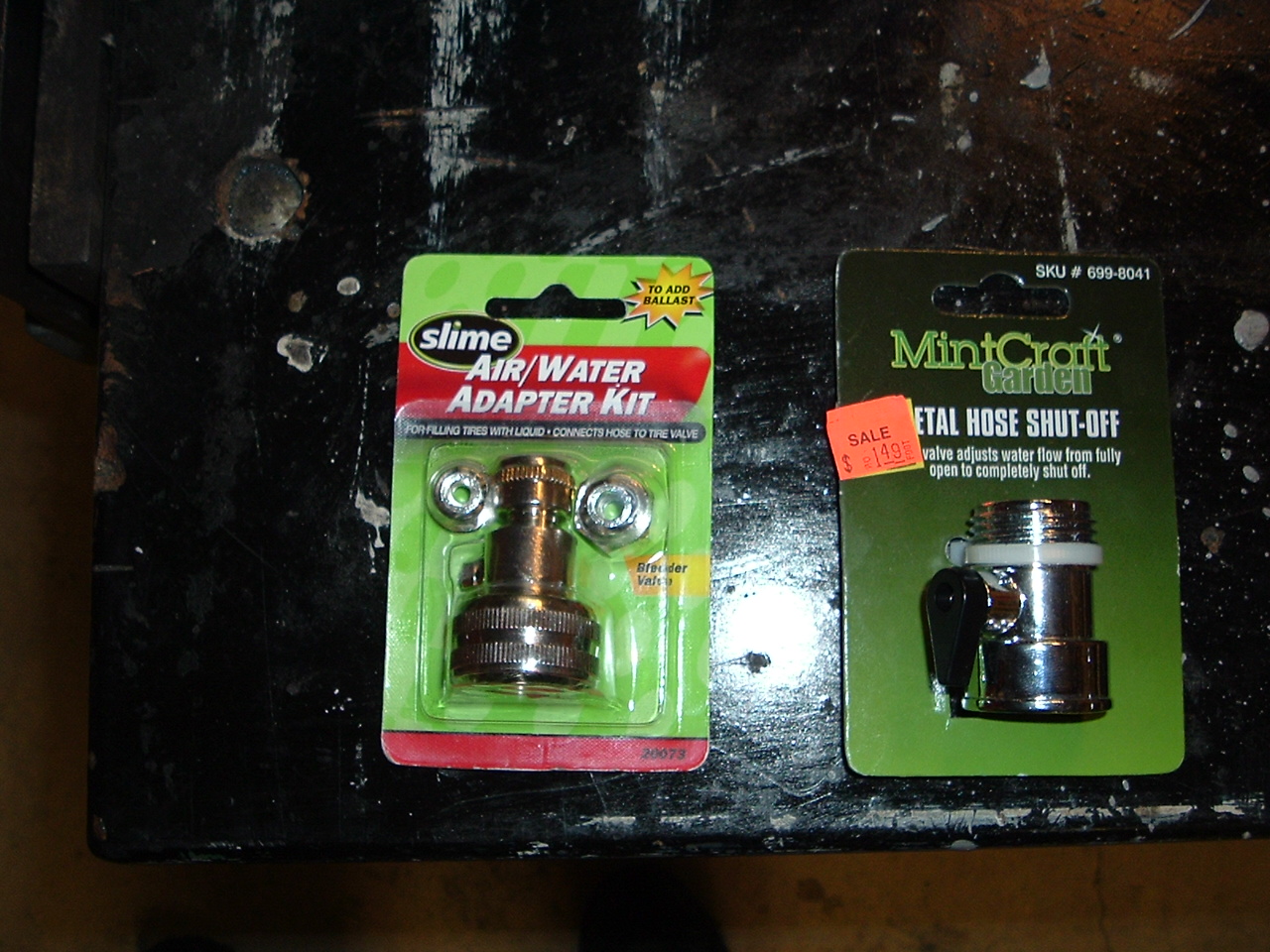

This is the one I used. I got it at Tractor supply as I remember. Also shown is the shut off I attached to the fill adaptor to manage air and fluid flow. This valve can keep the air pressure in the tire from escaping back thru your pump when it is turned off and you are refilling your bucket with fluid.
   / Cannot Load Tires without Unseating Bead
I have both these valves. The only issue I see will be pumping the antifreeze into the tire.I normally pump with a small hand pump and the end of the hose stuck over the valve stem. In this case I won't be able to do so in trying to keep air in the tire. I should be fine on putting the water in with the addition of the valve.
