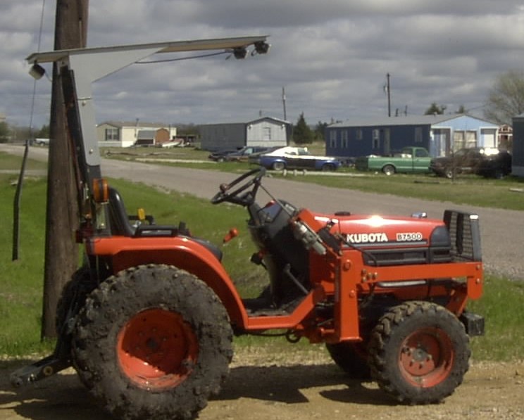

Built my own canopy out of steel for around $50.
   / Canopy For A 7500 #5
wichiwichi, nice looking canopy! Is it made of aluminum? Please post more details as I'm sure there will be much interest in it. Thanks
Bill C
   / Canopy For A 7500 #6
No it is made entirely of steel. The main frame is 1" heavywall steel tubing covered by 1/8" steel plate. Have less than $50 in it excluding lights. The part that attatches to the rollbarr is 3' x 3' x 1/4' angle iron cut to fit the curves of the rolbar. Insulated the top with 3/4' styrafoam.

A real nice set-up for the price, never thought of building one. It may be the way to go. Thanks, sherbs
