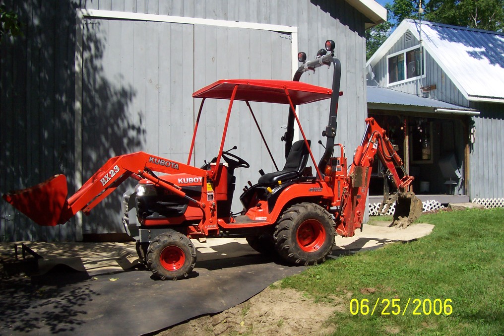

Thought you might like to see how I did mine on a BX 2200.
Bob

/ Canopy - looking for input
Bob, thanks for the pictures. A couple of quick questions & comments:
1. How did you secure the canopy's front frame to the tractor / loader?
2. Can you easily & quickly remove your canopy?
3. I see your canopy is tilted rearward - that answers the question I posted.

posted.
My front supports run to the floorboard, then turn 90 degrees toward the tractor. On the BX 2200 there was already a hole in the floorboard with a bolt through it. A longer bolt was used to run through the same hole to secure the front supports.
It can be removed fairly easily, but is a little awkward holding a large top like that with one hand while loosening the bolts with the other hand, then holding everything so it doesn't fall on top of you. As you know, the top does not weigh much, so weight is not a problem. My wife and I can easily remove it together. I thought about rigging up something in the garage ceiling to hold it, but have never gotten around to it. I only removed it one time, and that was when the BX 2200 went to the shop for warranty work.
The top does not touch the loader or any loader mounting hardware at all.
Yes, it is tilted toward the rear a little. The thinking was that rain water would run toward the rear. In a light shower it works, however, in a heavy downpour, I still get wet. The best part about the top is keeping the sun off of my bald head.
Another poster stated he did not like front supports. I like them because the front support can be a handhold for getting on the tractor; a rearview mirror can be mounted to the support, as can a tilt meter, cell phone, radio, hook for your gloves, or whatever else you want to hang there.
I did not design this set-up. In 2003, Danny Williams was an active TBN poster who came up with the design. I asked him about the attachment to the ROPS as well as the front supports, and he made a set for me. I paid him for all the materials and the shipping, plus a little extra.
I have not seen Danny on TBN in quite a while. He was making his own FEL, and I wanted to when finished.
Good luck with yours. If you need better pictures from me, let me know.
Bob
