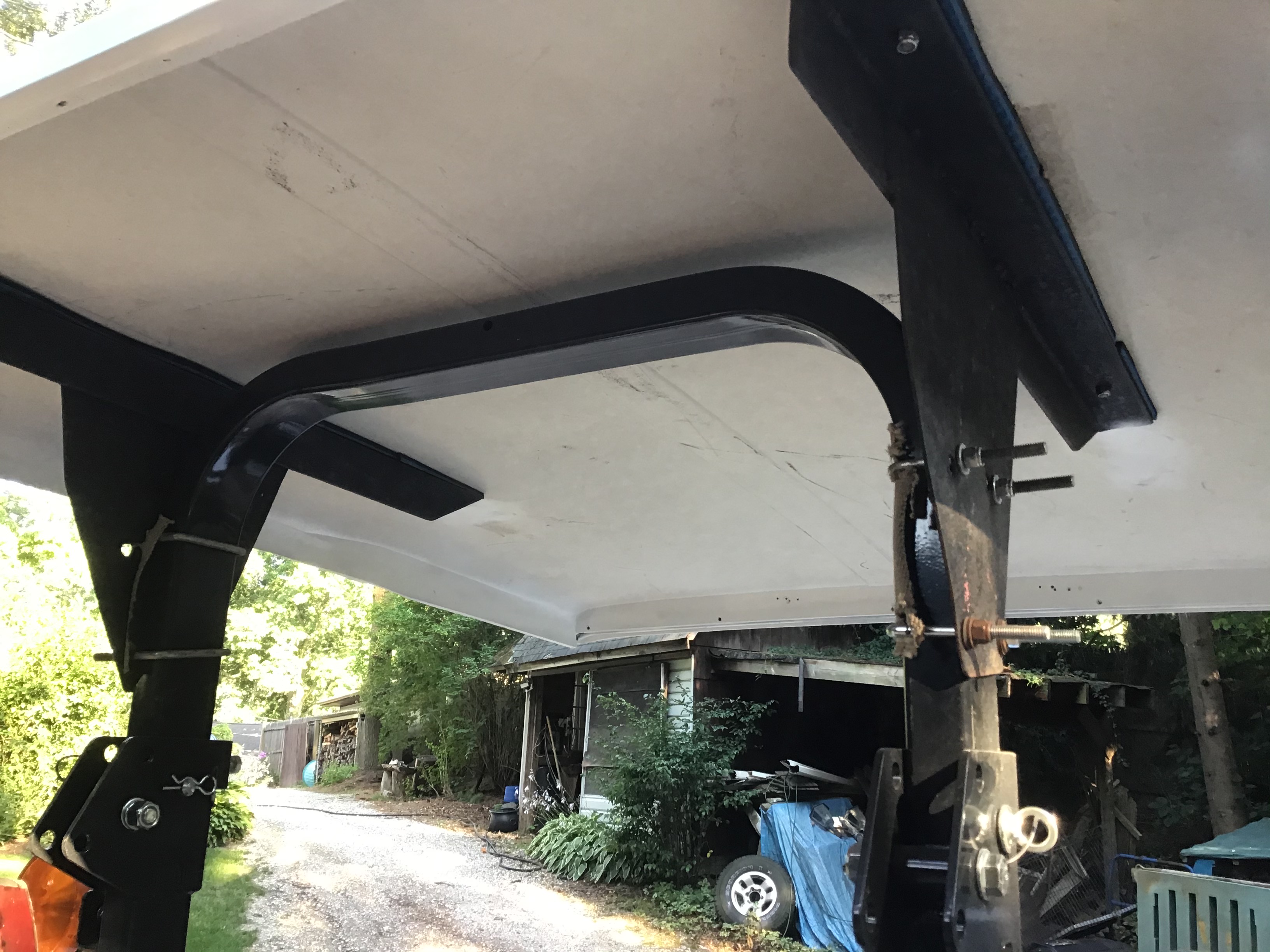

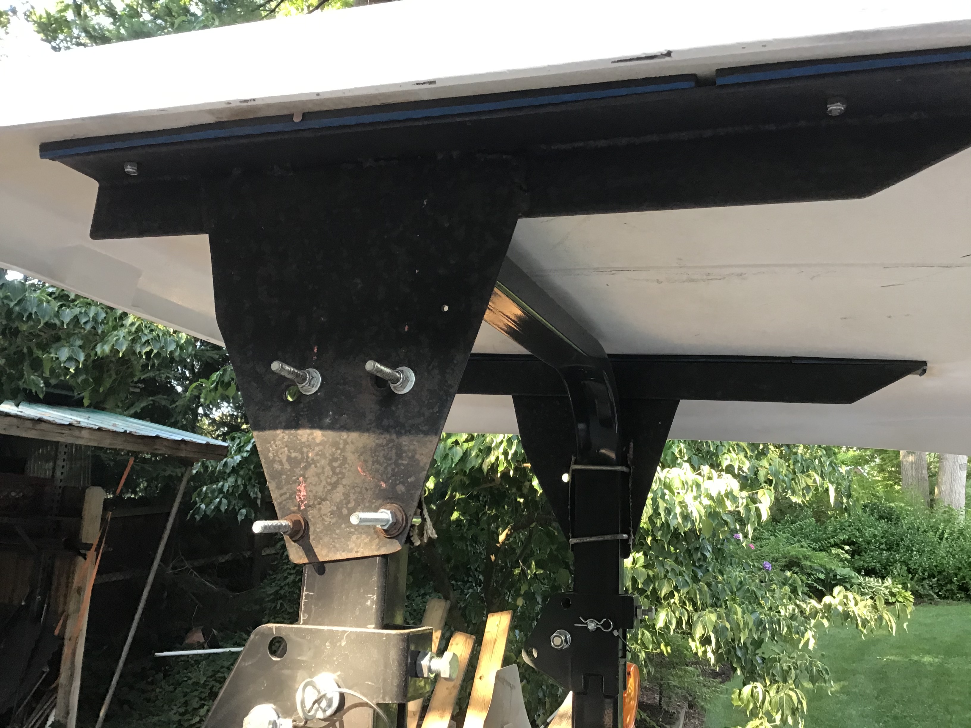

I made a canopy for my Bobcat tractor 2025 model out of a junk CJ7 Jeep hard top.
Removed broken glass and cut off sides. With a little sanding and painting was ready to go! Bolted it onto the ROPS with bolts from Ace hardware.
Looks pretty good and will protect from falling branches too.

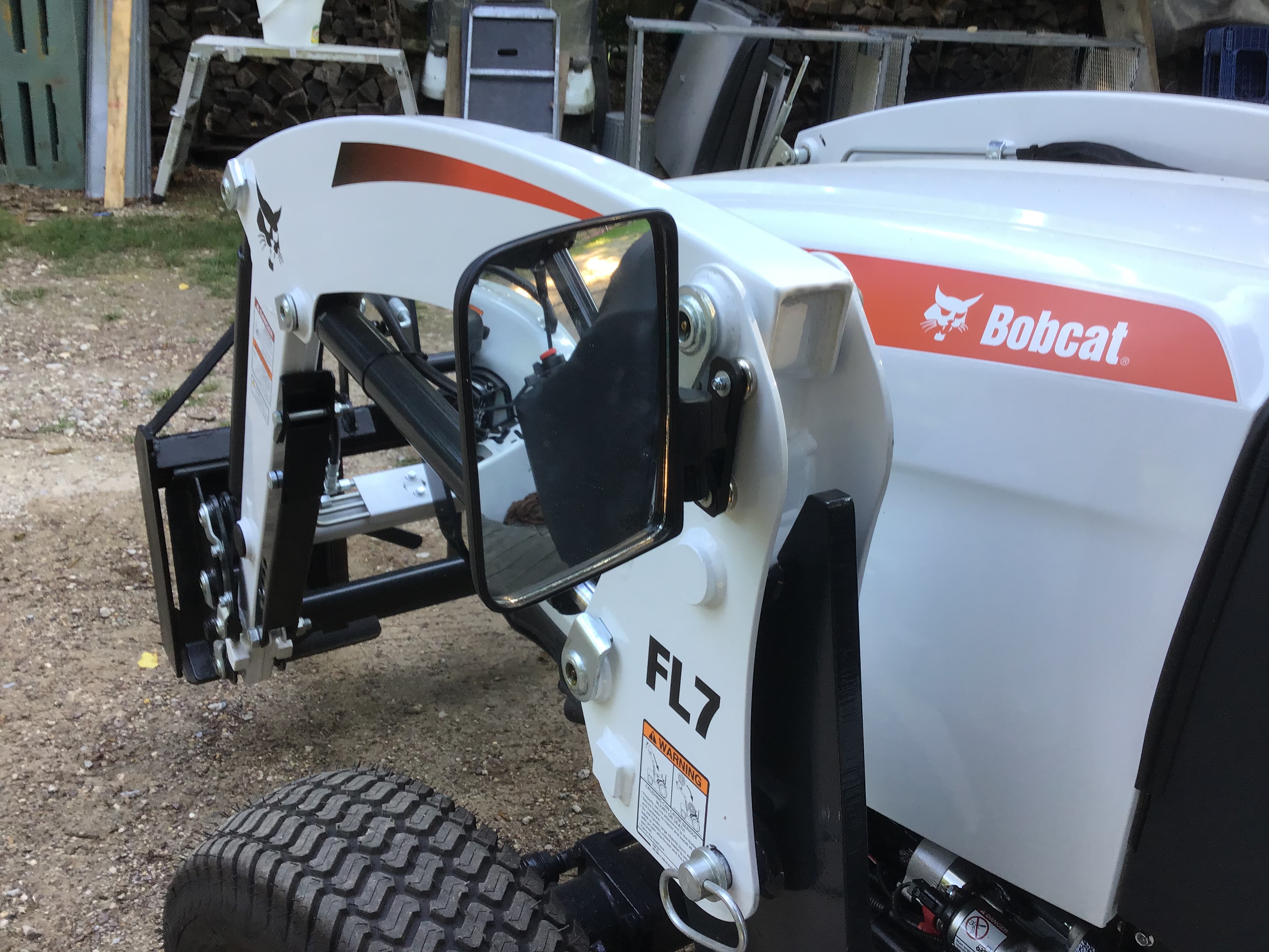

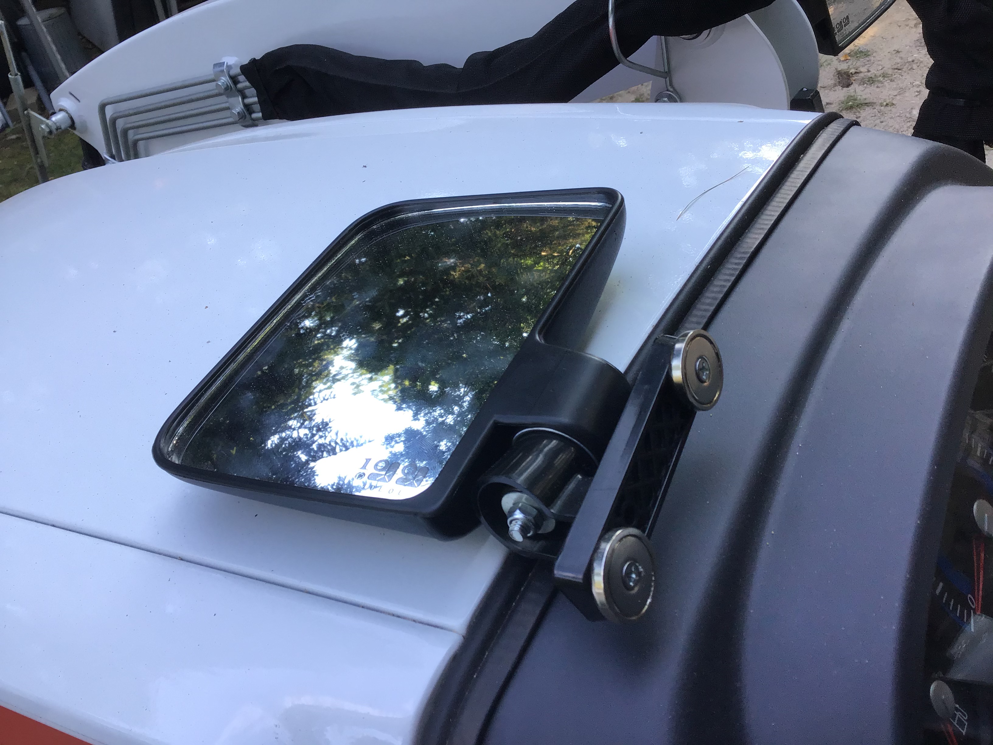

I added some golf cart mirrors that were pretty inexpensive. Added strong magnets to hold them on. They seem pretty good and don't vibrate too much.
