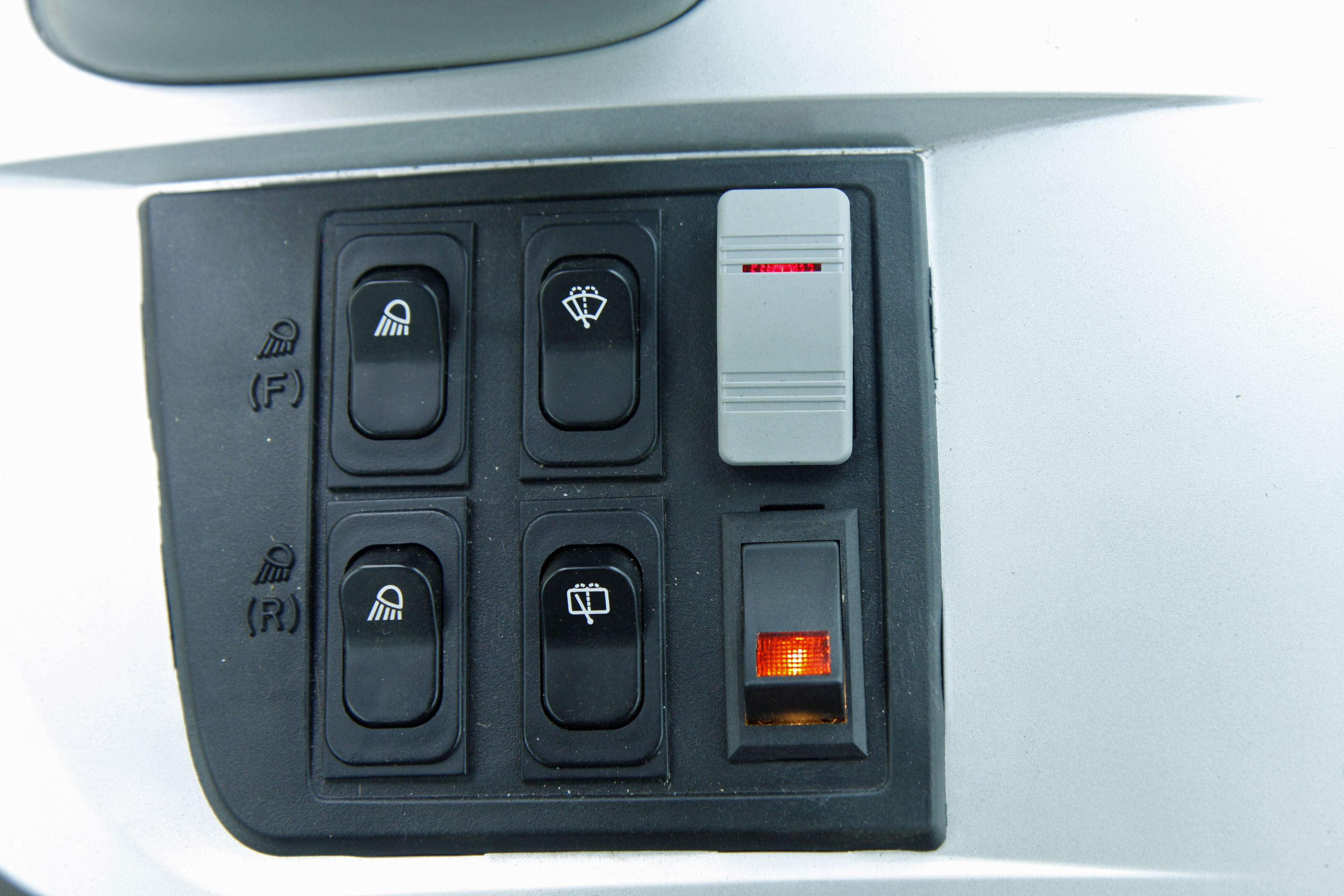

I was planning on putting a 20 or perferably 25 amp SPST rocker switch in one of the empty switch holes on the dash but so far after contacting two NH dealers plus a NH sales Rep and NH's Customer Service, two auto parts stores and using Google, I have found none that will fit the hole!
Since I was hoping to find something soon, I thought I would see if anyone might know a source for one. It doesn't need a light. It would be nice if it looks similar to the NH switches.

Can you pull one of the existing switches out and figure out who makes it? Look for name/part# something? Go to the part mfg, not NH.

Check this link to Grainger rocker switches. I think it hardest problem will be finding an all-weather switch. If you park your tractor indoors, this might not be a problem.
   / Can't Find a 20 or 25 Amp Auxiliary Switch for a TC45D #6
For all weather switches...check at a Marine supply store. All boat switches are weatherproof., These 2 switches i added for my emergency lights are from a marine store. They dont look like my original switches, but i really dont care. They fit into the existing cutouts without any problem, and they work great. The bottom right one turns the light on and off while the upper right is a momentary on switch that adjusts the flashing patterns of the lights. I wanted them lit so i could see them at night in winter when i use the lights.,

The hole size is 21 mm x 37 mm.
   / Can't Find a 20 or 25 Amp Auxiliary Switch for a TC45D #9
Don't know why you need such a high amperage switch, why not just use whats available that fits the hole. Use the switch to power a relay to carry the load. Relays are available at any parts house and can be rated for any amperage load you would ever need.
