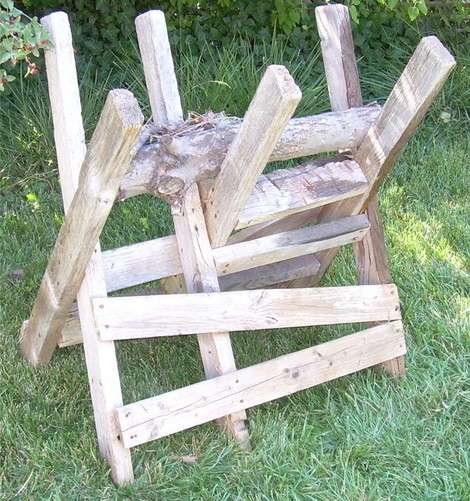

I remember 2 or more years ago seeing an attacment for a tractor that held 5 or 6 logs about 10 foot long. It was some how slotted or something that let you cut the logs to firewood length with a chain saw. Do any of you folks know what I am talking about?
   / Can't find attachment #2
Thanks JJ, but I still want to findthat attachment. I got the impression it wasn't made by a big company. Anyone's help is appreciated.
