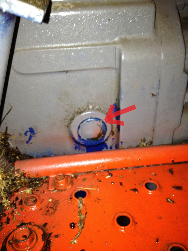

I seemed to have developed a leak in hydraulics and the seal pops out but there is no mention of it in my manual. I have a used 3054 any help would be appreciated

Not sure what your showing in the picture.
Is it the sight glass that is leaking?

I was bush hogging and looked down and my boot was covered in fluid and the cap had pushed out of position and was leaking. I pushed in back but was unable to raise the 3 pt so I had to drive back to the barn. The leak is coming from where the red arrow is pointing. You think this the sight glass?
Thank you

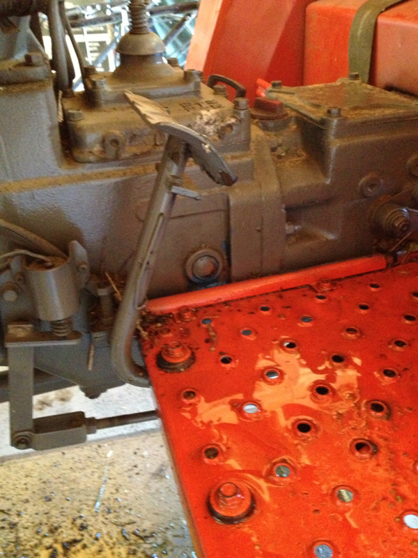

My sight-glass is at that spot, but on the other side of the transmission. 2004 LK3054xs

That is the sight glass someone painted over. Go to your local dealer or call us. We have them in stock.
