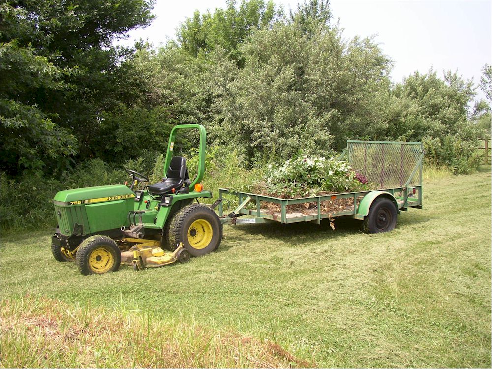

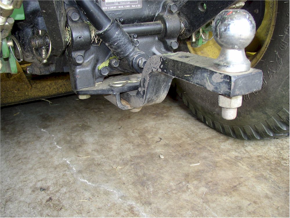

Thought I would add some pics.

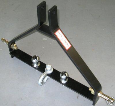

I use to use my 4400's drawbar...now I use this 3PH mounted drawbar more frequently. Works nicely for towing and pulling old tree trunks and such.
You can find these on eBay for about 80 bucks. Looks pretty easy to fabricate if you have the tools and a welding machine.
