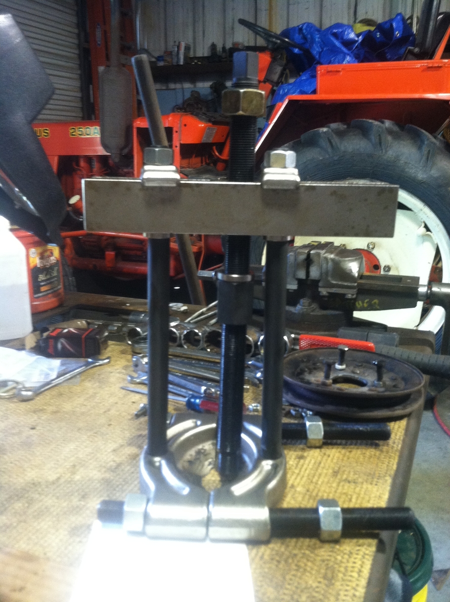

Try to determine exactly what's stuck. If the part that's still on the tractor feels jammed tight with no moving at all then it's probably like 5030 has stated. Lot of the yokes on those pto shafts are open inside and you can see the end of your pto stub after you remove the cross (universal joint). If after hammering don't work you can use a large puller while tapping with a hammer but it'll take a large puller such as this one to help.

If the yoke is loose and the pin is not releasing you may have to cut it off. If it's the pin stuck you might can keep tapping on it with a hammer to help it release. If you don't think the release pin is the problem don't beat on it or you may have 2 problems. If it comes down to cutting it off and I've seen it don't use a torch use a cut off wheel on an angle grinder. If it's the pin stuck and you simply can't get it to release sometimes you can cut the section that's holding the pin with less chance of damaging the stub.
If it is just stuck as 5030 says you shouldn't have to worry about cutting just figure a way to put a pair of vise grips to hold the pin in the release position while working it off. Good Luck.
