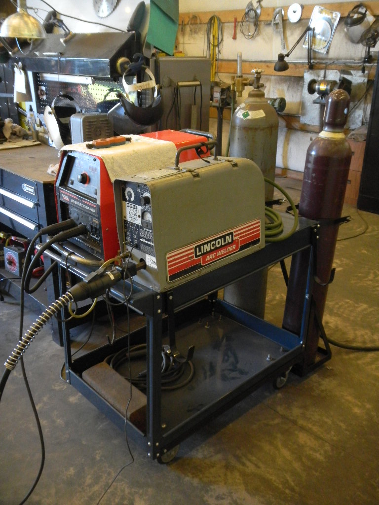

So how do you guys keep your glass (Plastic) clean? Do you store your helmet in such a way it gets some light so the batteries are up to snuff when you grab your helmet?
   / Care and Feeding of welding helmet #2
I only use flannel cloth to wipe my welding lenses. My auto lenses are solar powered. I just hang the one I'm using on a hook near the welding table in front of a space heater. Here in the north west fogging is always an issue. You can see it in the back ground of this picture.
