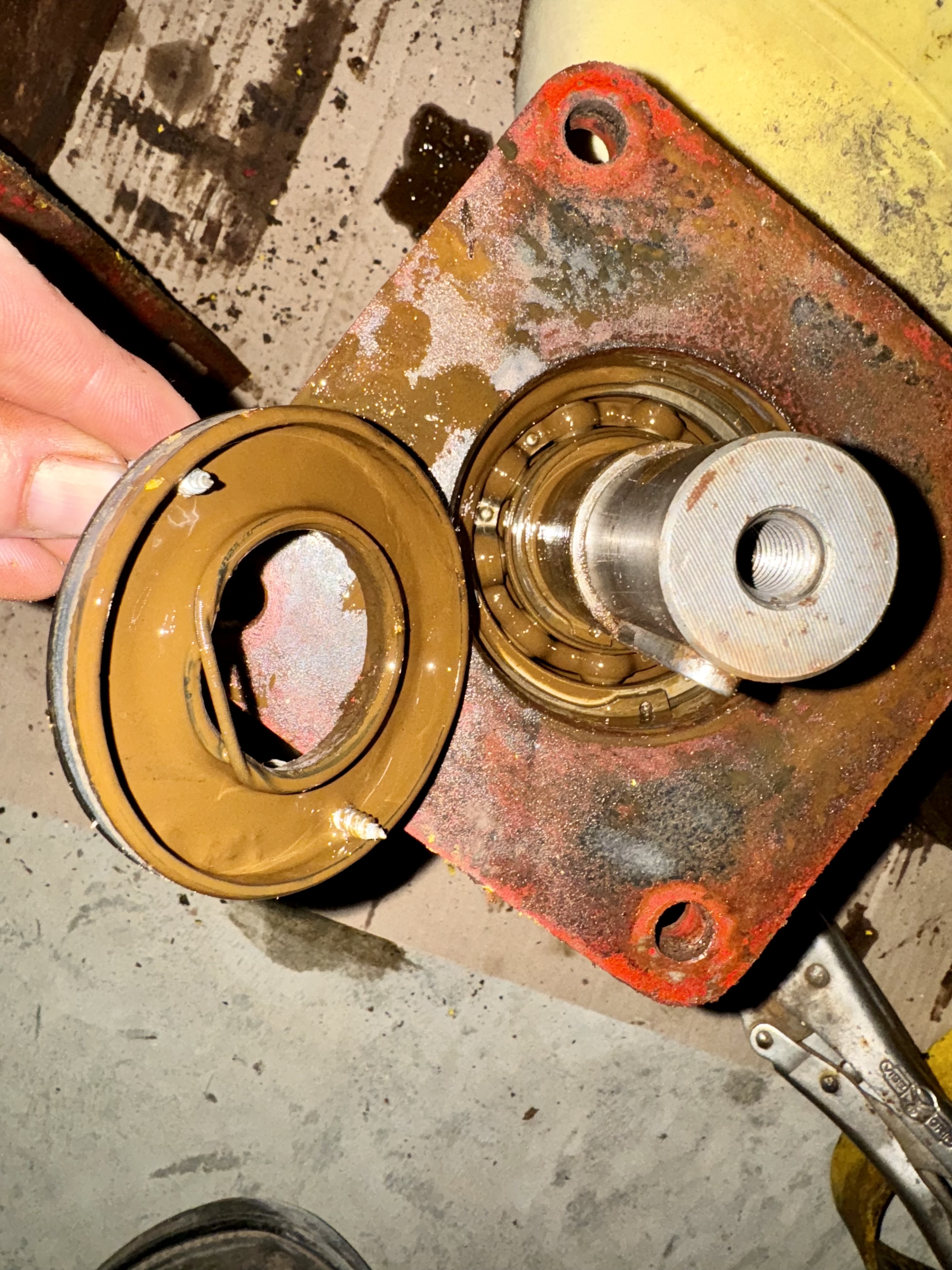

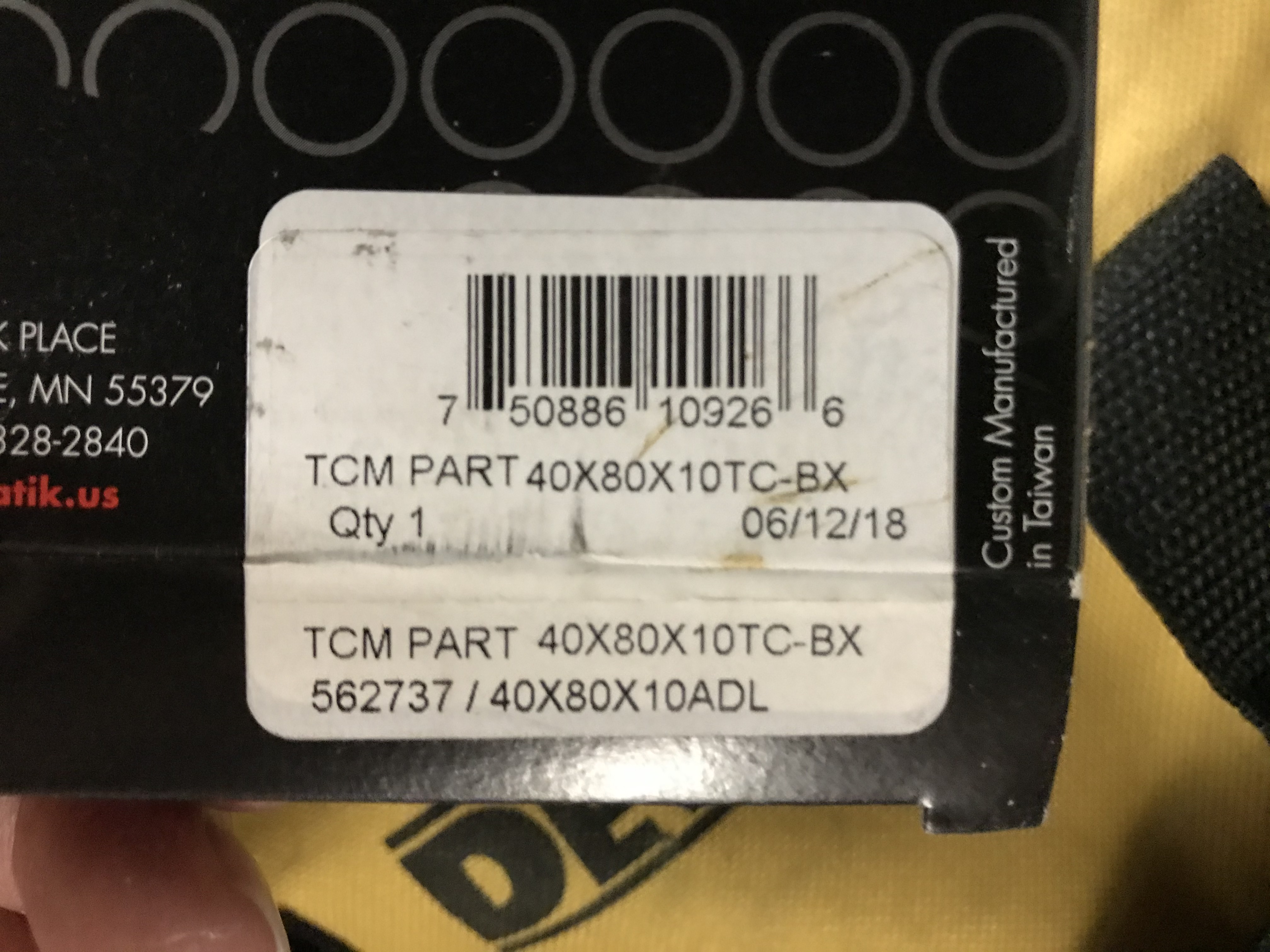

I really like the Caroni finish mowers, and may be able to help. I rebuilt a 91" about 2 years ago and am in the process of refurbing a 5 footer for our little Ford. Way too busy with things so the 5 footer is went on the back burner following the welding. Make sure the shaft is really clean and smooth without any sort of burrs when you replace the seal, lube the shaft. I think I hit it with some silicone grease. Access to the seal is time-consuming but not terribly difficult. First of all, here's the parts manual:
https://www.caroni.it/wp-content/uploads/2017/07/1_CARONI_SPARE_PARTS_TOSAERBA.pdf
If the oil is coming from the bottom of the gear box, the manual says the seals for the gear boxes on the models shown are all the same. See the first item on Page 8. The 91" deck I did wouldn't even hold the oil because of a damaged seal. The seal on the 5 footer looked bad, so that'll get replaced. There was no evidence of leakage at the input shaft on either deck.
Here are a few pictures:
The box with the seal in it has the 40x80x10 seal that matches the factory and it was available at a real hardware store nearby.
Center shows how I removed the old seal. A couple self-drilling screw and some gentle prying did the trick.
Third photo is the old seal before removal.

Welcome aboard! Removing the gear box isn't necessary for belt replacement. There are various things that need loosened for belt replacement though. Refer to the parts diagram in the link in my earlier post.
To remove the gear box the easiest approach is probably loosening things up and removing the gear box support. Then there's a bolt holding the pulley on the bottom shaft of the gear box that has to come out to remove the pulley. The gear box is bolted to a plate that in turn is bolted to the support via studs up through slotted holes. Hope this makes helps.

Thank you. I should have clarified that I am replacing the gearbox oil seal. I realize now that I needed to remove the gearbox support in order to pull the pulleys and to get to the oil seal.
   / Caroni 72" belt replacement how to? #10
Looks like you have it under control:)
A good flushing / refill and it'll run for a long time.
