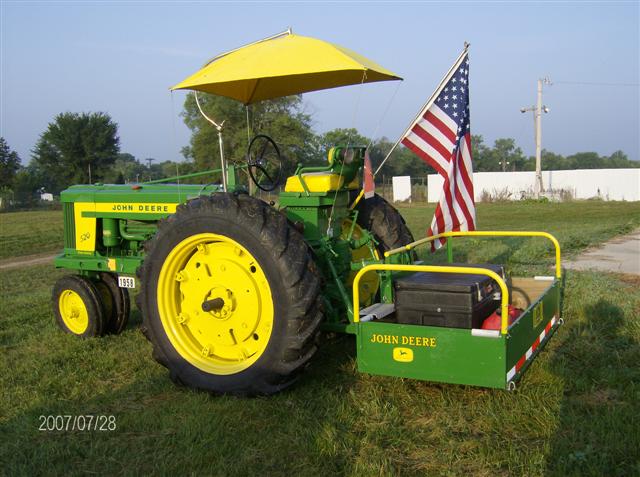

I found an old one at a farm auction for $5! Threw away the rotted wood, painted the frame & built one to use on tractor drives: 2785.jpg Sold it after I quit the drives.
