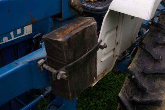

I assume you may have already seen this thread, but it's what I plan to copy for my use.
The attachment shows what my tractor came with - very handy but no room for all the stuff that needs to go with it. It's what I've heard described in military circles as a field expedient solution.
