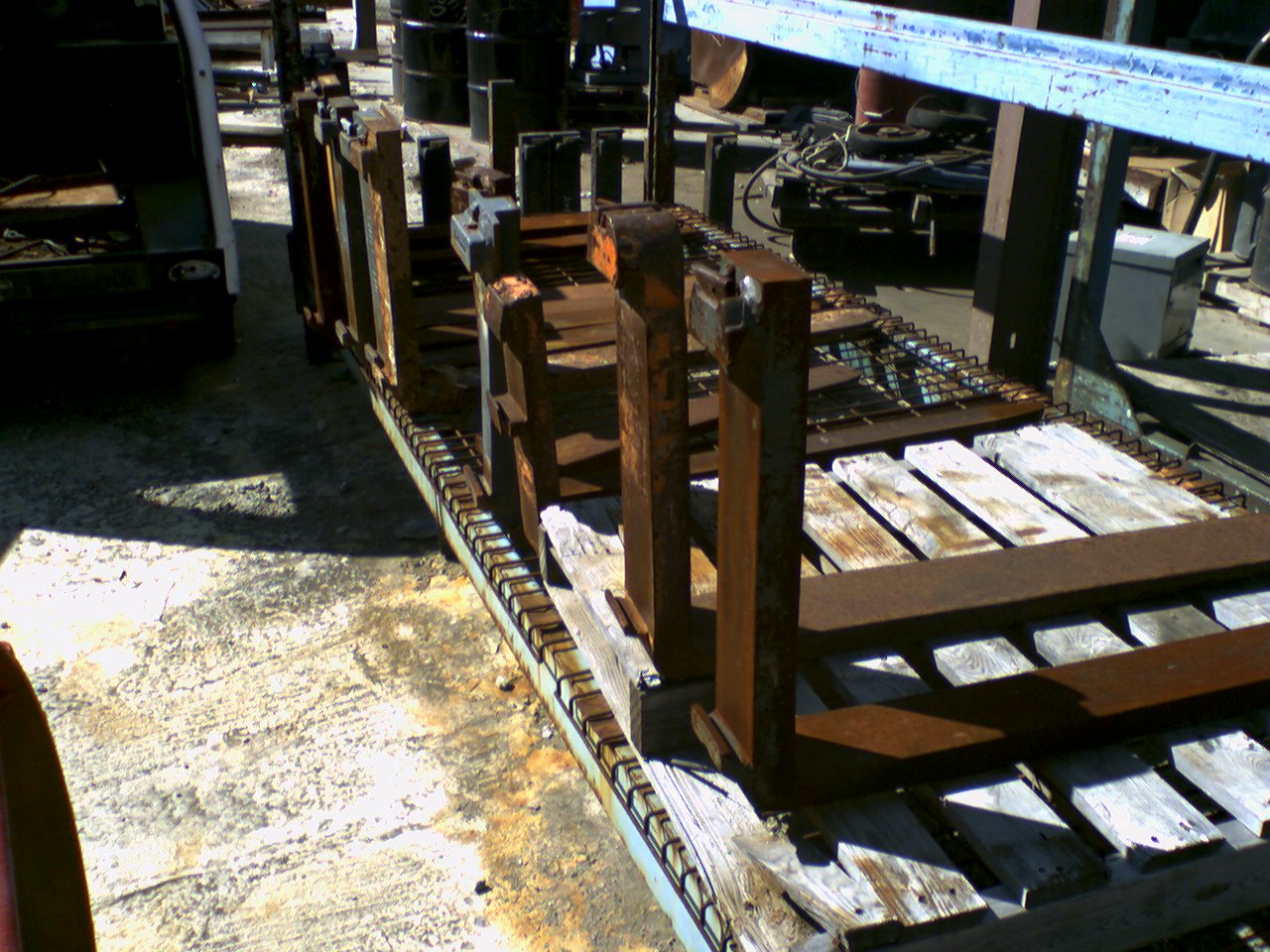

It was Nov. 07 when I picked up a set at the local metal scrap yard for $150,
they must have 100 pairs or more, I had a hard time deciding which pair I wanted, I knew I was going to be picking up a lot of pallets, so I knew I want them to be close to 48".
I also picked up a piece of 4x4 angle about 60" long to strap to my bucket
to hang the forks on temporally .
Here's a small assortment of what they had to offer.

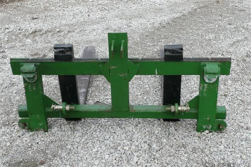

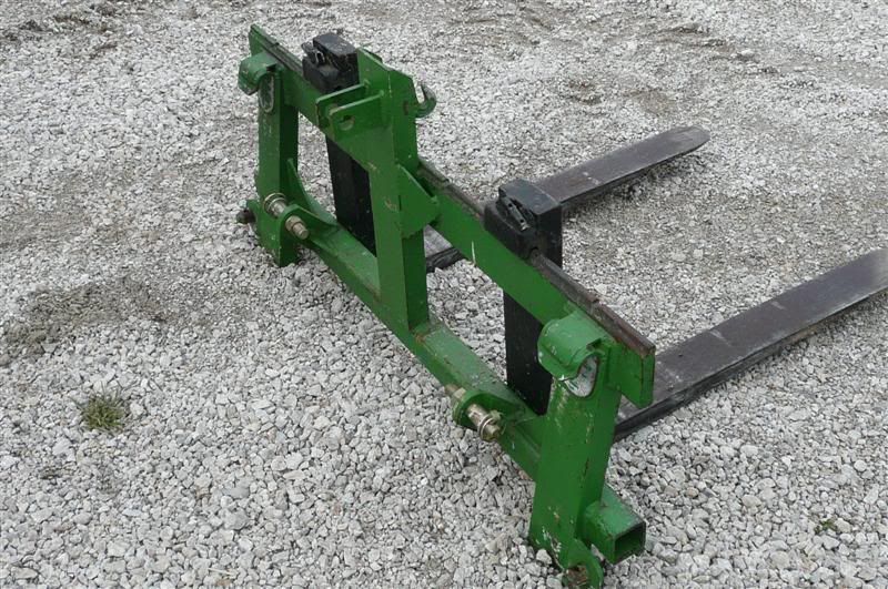

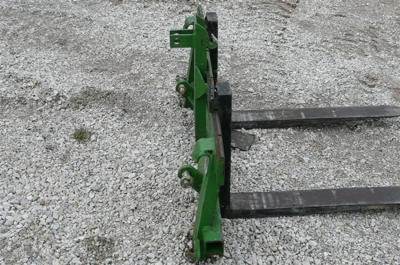

   / carrying wood with 200cx ????? #5
Meb9796, I bought used forks and to Deere for the loader mounts then had a welding shop make these. Also mounts to the 3pt.
