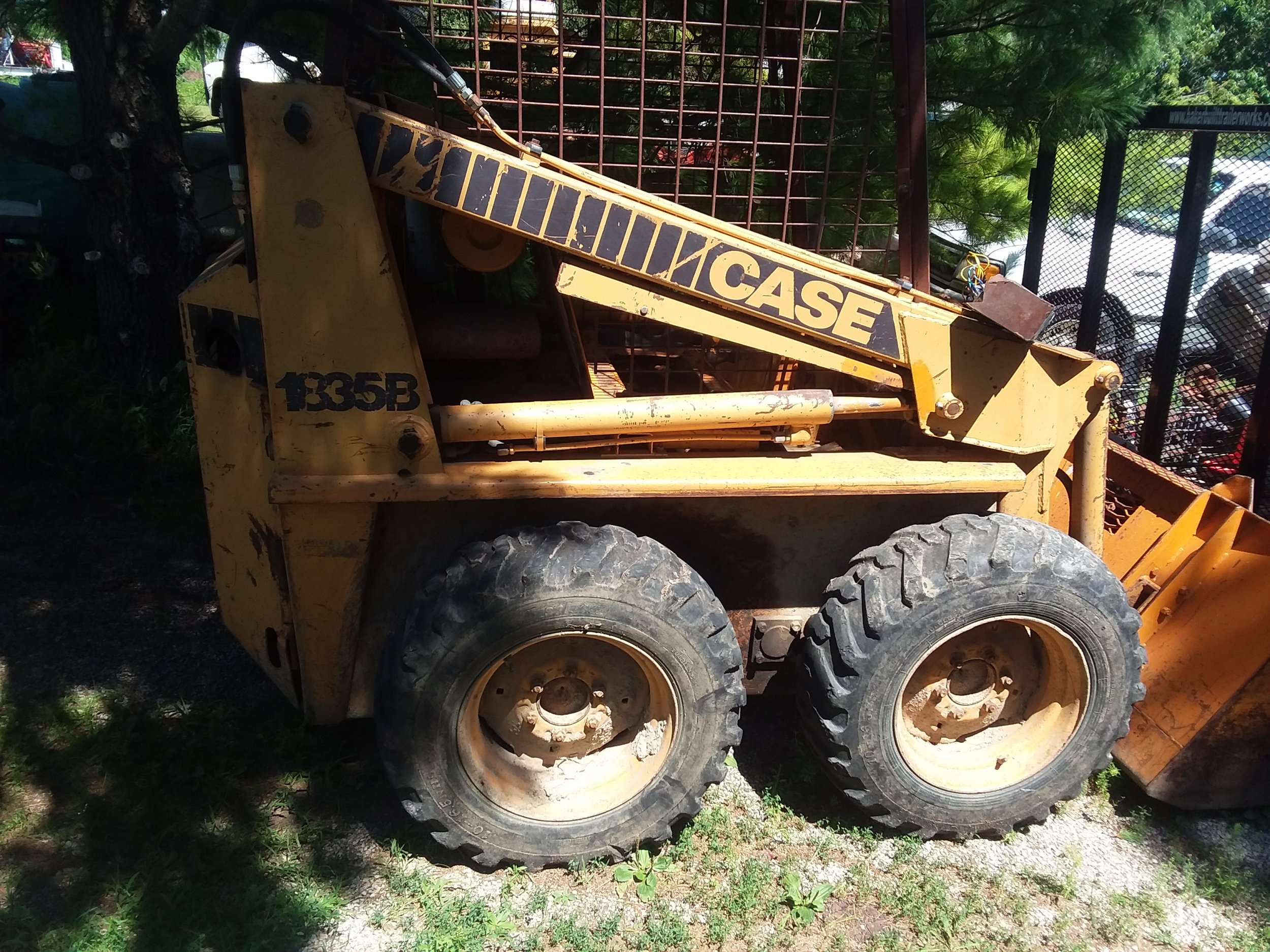

anybody have a wiring diagram for one of these??? This has the 188 diesel in it and seller says starter dont work. He tried to wire a new switch up in it and it looks like a mess. I dont have a clue as to where all the wires go to and need help.
I hot wired the jumper pack to the starter direct and it turned over just fine so I dont think the starter is the problem.
Loader been sitting for eons,--tires were almost flat, fuel has drained down, hand primer pump dont work. But I am getting there as to getting it started. I do need to have some sort of switches to operate the starter and power to the rest of the machine. Push button for start will work but need something else for the machine system power.
I looked on the internet for a diagram and none to be found. I have the parts book but it dont show anything.

Probably going to need a service/repair manual to get the diagram. Did a quick search for a 1835-B service manual, and more than several out there for sale, in PDF download, reprints and some OEM one's.
Best looking deal I found pretty quick was a reprint set on ebay. $90 w/free shipping. I have an OEM one for my 480C backhoe, and they are great. Very detailed... I had to do some rewiring on it, from a PO's hack job. SERVICE MANUAL SET CASE 1835B UNI LOADER SKID STEER PARTS CATALOG WORKSHOP SHOP | eBay

Did anyone come up with a 1835b diesel wiring diagram?
