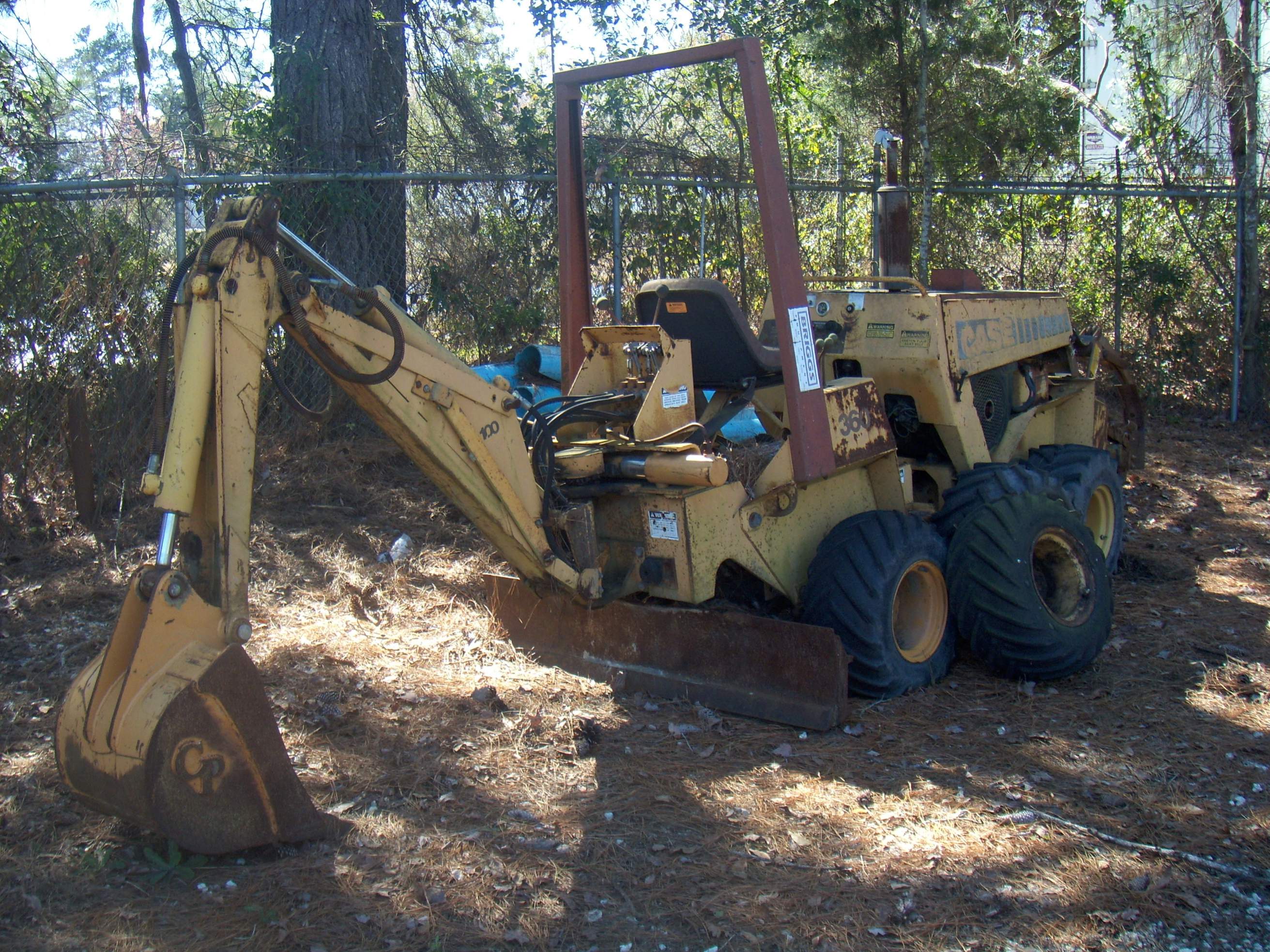

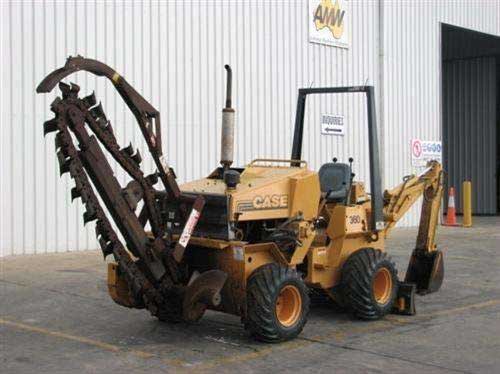

I got a good deal on this trencher, it was calling my name. If everything works, I will be pleased. Has very little hours.
Does anyone have an owners or operation manual for this machine. What kind of fluid is used for the hyd?

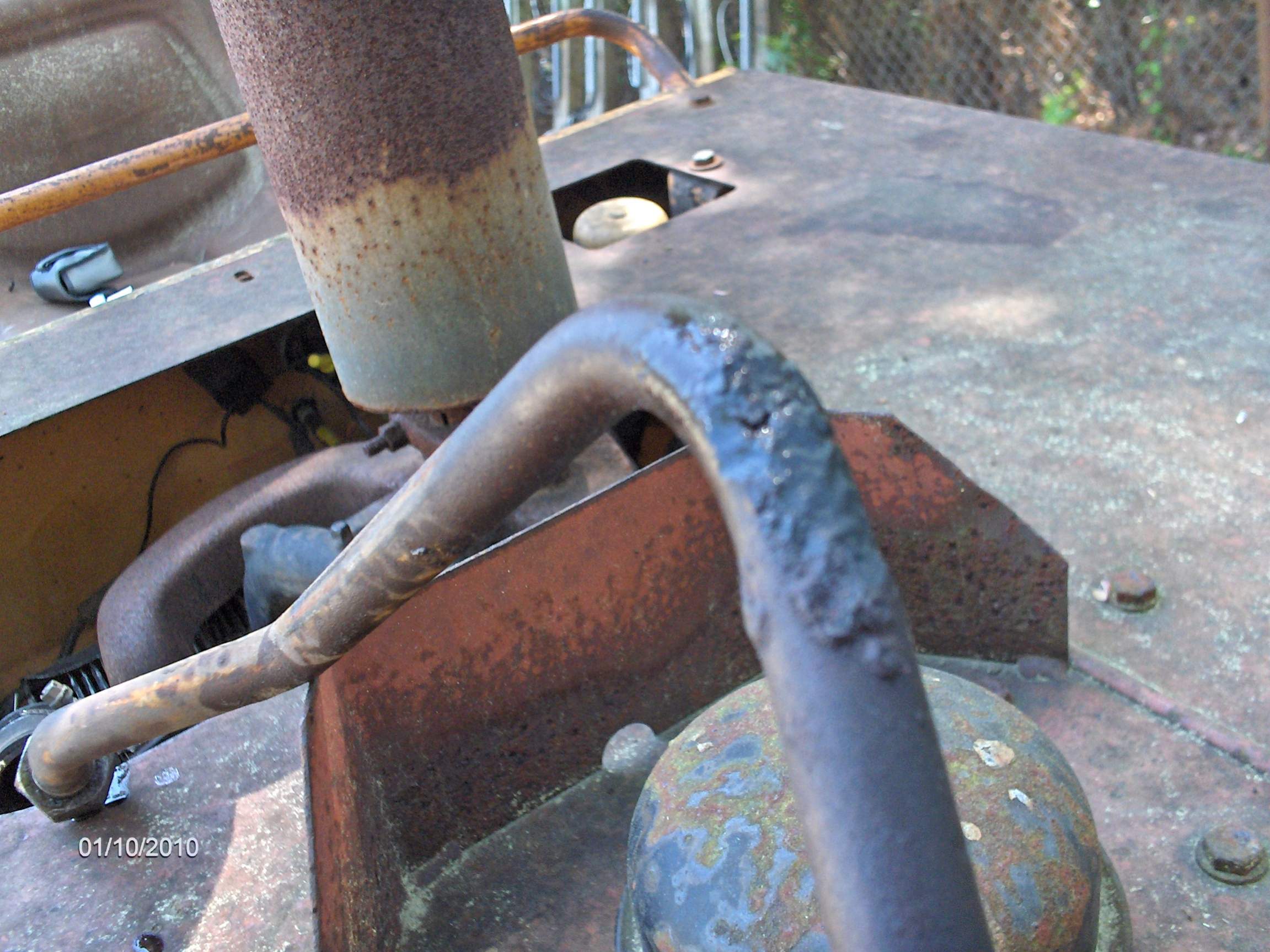

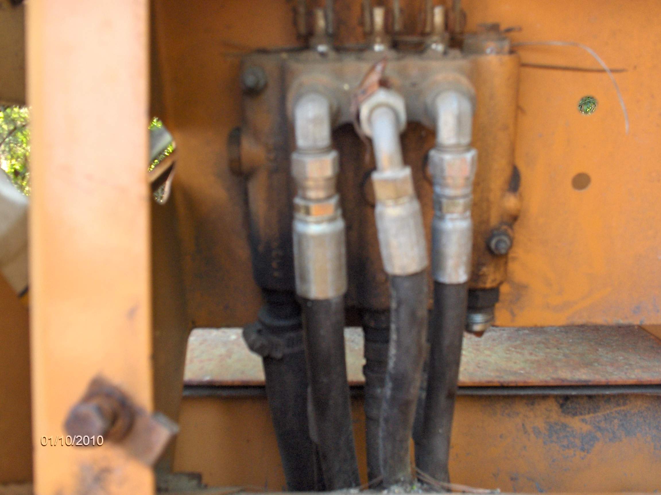

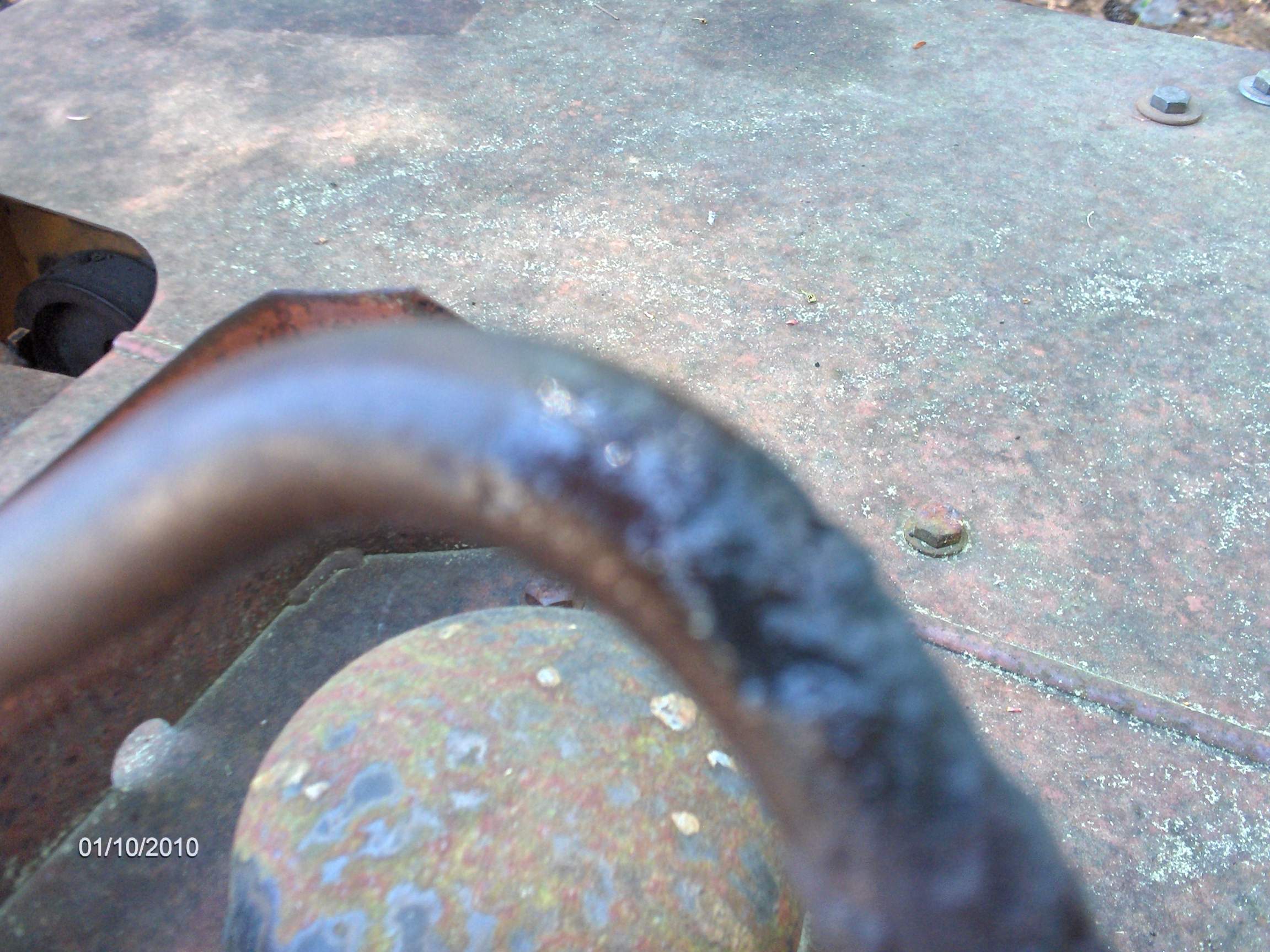

Update on the case 360 trencher. Ordered a new electric fuel pump, and it doesn't appear to be working. So I gravity fed fuel to the carb, and the engine kicked over and ran. Worked the hydraulics for a little bit and shut everything down. I felt sure I was ready to load it on the trailer, and take it home. The previous owner has been nice enough to let me work on it there, and said to take all the time I needed. Started the engine today, and tried to raise the trencher up off the ground with the back fill bld and BH bucket, and then it happened, one of the hyd hose blew, and dumped hyd fluid all over the ground. I tried to look under the machine, but the sun was so bright, and the underside was so dark. I will bring a digital camera back and take a bunch of pictures. There are a combination of steel lines and hyd hose under there, and I have to find the hose or line, or fitting that failed just to move the machine. The fluid needs changing also. I put some ATF in the reservoir just to bring the level up some. I will use Hy-Trans as soon as Case has there stock delivered.
   / Case 360 Trencher/backhoe.
Well, after looking under the bottom of the trencher, fluid had covered all the hoses, and I could not tell which had failed. Put my digital camera under there and took some pictures, and also felt all around, and I finally found the faulty line/hose. It was the steel pressure line going to the plow circuit, and that is why it was pumping fluid really fast. Anyway, I felt a lot of rust on the pressure line, and made a decision to pull the line and check for sure. Sure enough, that was the one leaking. Rusted through. My deduction on why the line rusted out was that someone had put a foam sleeve on the line to prevent rubbing, and I think water got trapped in the sleeve, and water/metal equals rust.
Well the bad news is that they can't make a replacement steel line, so an equivalent hose 32 in long with JIC-10, would cost $75 plus cost. NOT me. Ordered the hose from Discount Hydraulics for about 1/2 the cost.
I had raised the wheel off the ground with the bucket and the plow hyd, and the trencher was still up in the air three days later, so I am expecting good things from this trencher, with Backhoe.
The new fuel pump was dead so took it back to NAPA, and got another one, and put it on a battery before I left the store, and this one does work.

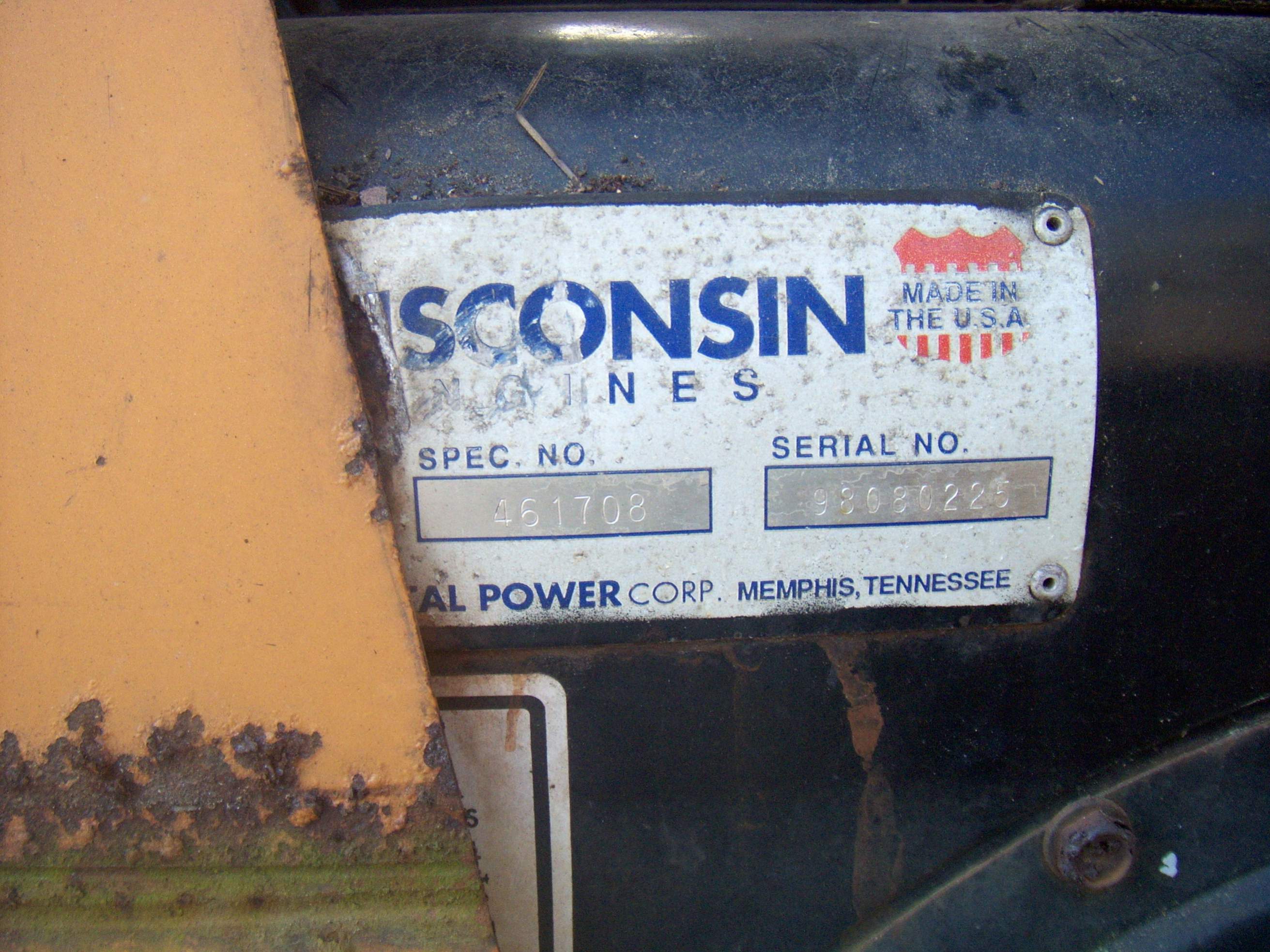

Found U'r post looking for manuals for my 360, did U find any if so where could one get some? Did U use HyTran fluid? I'm not familiar with that was wondering if there was a different brand that would work my reservoir is getting low. How do U determine the year of manufacturer?
Thanx!!
   / Case 360 Trencher/backhoe. #15
Here is a pic I hope to tell what year. I’m interested in a service manual for a 360 trencher also if anyone could point me in a direction. I have a parts manual. Seems like not a lot of parts made for these anymore
