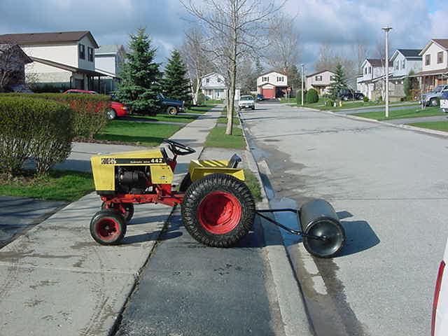

Hey s1120 heres a pic of the beast (442) /w3tcompact/icons/smile.gif
Strong little tractor.

   / Case 442 #9
Looks nice. I have done a bit more digging for you, and it seems that the 442's were only made 2 or 3 years. 70-72 I think. So you got an old girl there. Take care of her.
