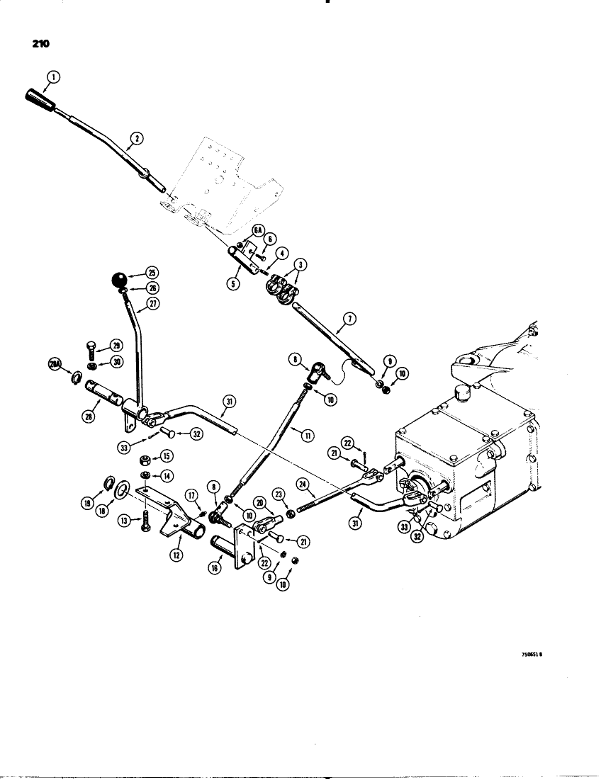

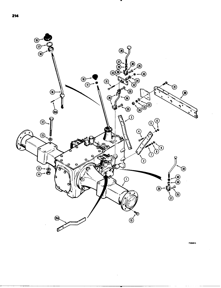

Shrek2,
We need a little more information before we can help much.
1) Which "transmission" is the PO saying won't shift? The 4-speed in the floor or the FNR shuttle?
2)If it's the FNR shuttle, are we safe in assuming that it's a mechanical shuttle and not a power shuttle?
There are two diagrams attached below, one shows the mechanical FNR shuttle and linkage, the other shows the 4-speed in the transaxle.
See if you can determine which one's not shifting properly and we can be of more help.
Mark

He said it's the shuttle shift with no clutch and the lever on the column for fwd and rev.
   / Case 580C won't shift #7
Steve,
If it's a power shuttle machine, that leads me to believe that the "tranmission" that won't shift without removing the cover is the 4 speed transmission in the transaxle. The power shuttle doesn't have a cover that can be removed.
Unless.... they're talking about removing the floor board to get to the linkage or something.
The powershuttle isn't intensely complicated. It can be removed without disturbing the engine or transaxle, so it's a relatively easy and not terribly expensive job to overhaul it if it's the problem.
The transaxle is more difficult to get to, but still not too complicated in its design, if that's the problem.
