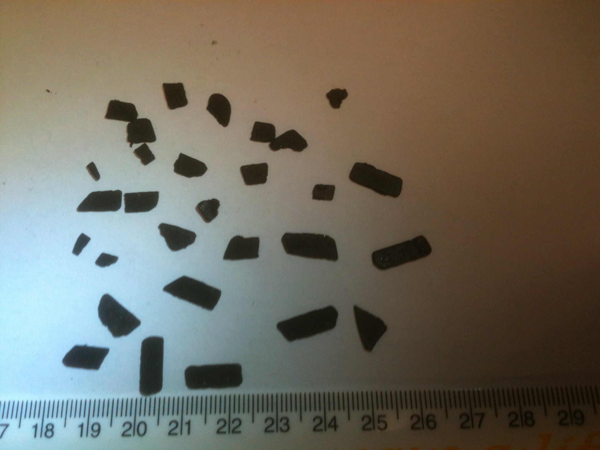

The bits on the filters are they fine and paper like or do they appear to be amore fibrous material ??

The bits found in the filter are quite uniform in size being roughly 5mmx12m (rectangular in shape ) and a bit less than 1mm thick. They are what I would call quite fibrous. Most smaller pieces could have quite easily have originated from similair pieces.

The friction materials which could block hydraulic filter could be plate linings (paper like material from 2speed power shift, 4wheel drive and or IPTO clutch friction plates.
More fibrous material could be the lining from the hand brale band, fits around the rear differential.
before you strip we need to conduct some hydraulic tests, can u get hold of fittings and a hydraulic test gauge upto 500psi. ?????
My spot diagnosis as at present is that the hand brake band is worn and IPTO clutch plates are worn and need replacing ????
Hand brake band can be left partially on and tractor driven causing early failure, there is an orange warning light on dash (if it is working???)

Hi I have attached photo of material in filter. scale is mm rule ( Ithink, if upload works )
I should be able to source a suitable guage and fittings for testing.
Tractor handbrake has not worked well since purchase . No switch found on lever ( mount for switch found ) hence no handbrake light. I did reverse tractor recently approx 50 meters while not aware handbrake was on.
