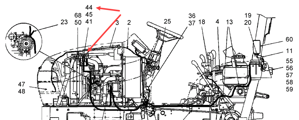

Hi Guy's have a 2008 DX18E with the glow plug light intermittently coming on, starts and runs fine but the light flashes on and off. Searched the net for the location of the relay but can't find on tractor, any help would be awesome.
   / Case Farmall DX 18E glow plug relay/lamp timer location #2
I might not be any help but on my DX 33 it's located under the dash on the right side. I have to remove the side panel on the right side where my knee would be. I know the 18 and the 33 are different beasts but that might be a place to look.
   / Case Farmall DX 18E glow plug relay/lamp timer location #3
It shows part #44 as the glow plug timer relay.
