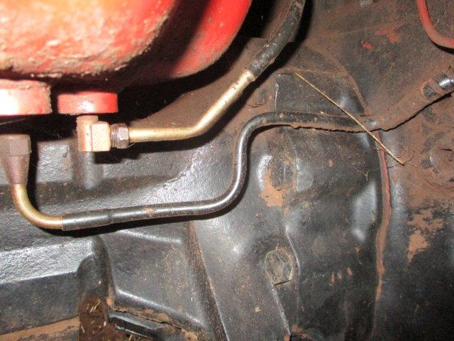

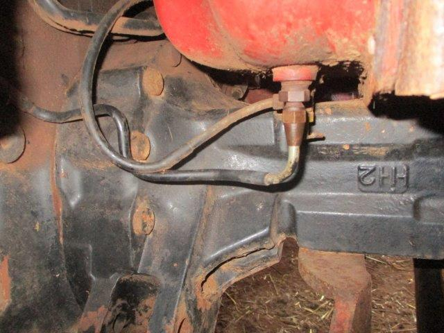

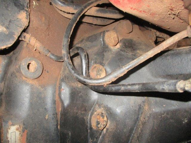

I had that line off on the 495 a couple weeks ago to confirm the line wasn't plugged. I did notice it can sit a couple different ways, one with "passenger" side sticking out farther, I tucked it all in and it's pretty protected.
Tractor has been on the farm 30 years and never caught the line on anything, It does bushhog some but otherwise but I don't drive through brush and sticks with it. I'll take a photo of it next time I've got it out if I remember and you can compare.
You could cap both sides of that line, completely fill the tank and it will just pull from the "passenger side" The "driver" side sump would just never get used, but you'd still have about 2/3 of the fuel tank usable, maybe just drain the "driver" sump once and a while if worried about fuel age.

Here are the sides, the coiled part tucks right under the top link. Lowest part of the line is several inches above the bottom of the axle housings.

Thank you for those pictures. My line definitely doesn't tuck in on the "passenger" side like your pictures show. Looks fine on the left side. I bought this tractor used, but I've had it for 18 years. The line on the "passenger" side looks to have been damaged at the connection to the steel pipe as it only goes on the pipe about 1/2" and it is too short to fit up against the axle like yours does. I've looked on line for a new tube, but don't see any listed. I'll try to call a dealer Monday to see if a new one is available. Thanks for your help.
