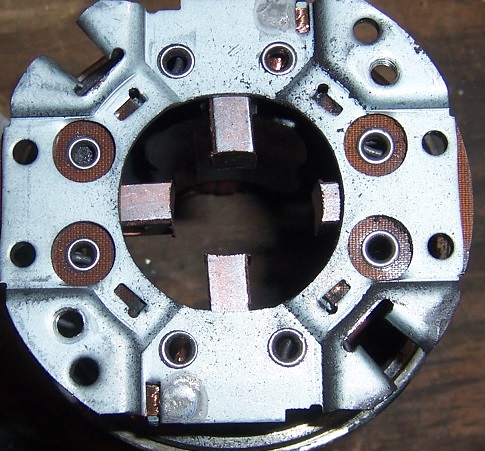

Engine will not crank. Thoughts / Suggestions?
New parts installed:
Battery (tests good - 14 Volts)
Battery post connectors (ground cleaned at frame)
Ignition switch
Starter Relay
Symptom and Test / Checks:
1. Connect battery, turn On key switch;
  • panels lights illuminate properly;
  • fuel shutoff relay activates properly,
  • fuel gauge indicates fuel level.
2. Key switch to Preheat position and hold; Preheat works properly.
3. Turn key to On / Start; starter relay clicks, then DOA. All lights go out; fuel gauge turns off.
4. Turn Off key switch, then back to On...no lights or fuel gauge; DOA.
5. Move key switch to Off then to Preheat; no Preheat.
6. Wait 10 minutes or so (battery still connected); move key switch to On - DOA. No lights, nothing.
7. I disconnect negative battery terminal for a few minutes, then reconnect battery negative terminal.
8. Turn On key switch; panel lights illuminate properly; fuel relay activates properly and fuel gauge indicates fuel level. Preheat works properly.
9. Turn key switch to Start, starter relay clicks, then DOA. All lights go out?
I have checked continuity of all the safety circuits and they are good.
B+ is present at the key switch.
All fuses check okay.
What am I missing here guys?

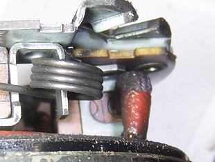

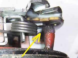

I may have determined the tractor's starting issue.
I removed and disassembled the starter.
One of the four brushes was hung up (brush wire hitting brush cage) and could not be pressed against the commutator.
   / Case International 235 (1990-ish) Compact Diesel Starting Issue
#9
New starter installed 19 Sep 2019. Engine cranks normally, no issues.
I presume that messed-up brush made charging the battery real ugly! I wonder if that is what cooked the old battery?
