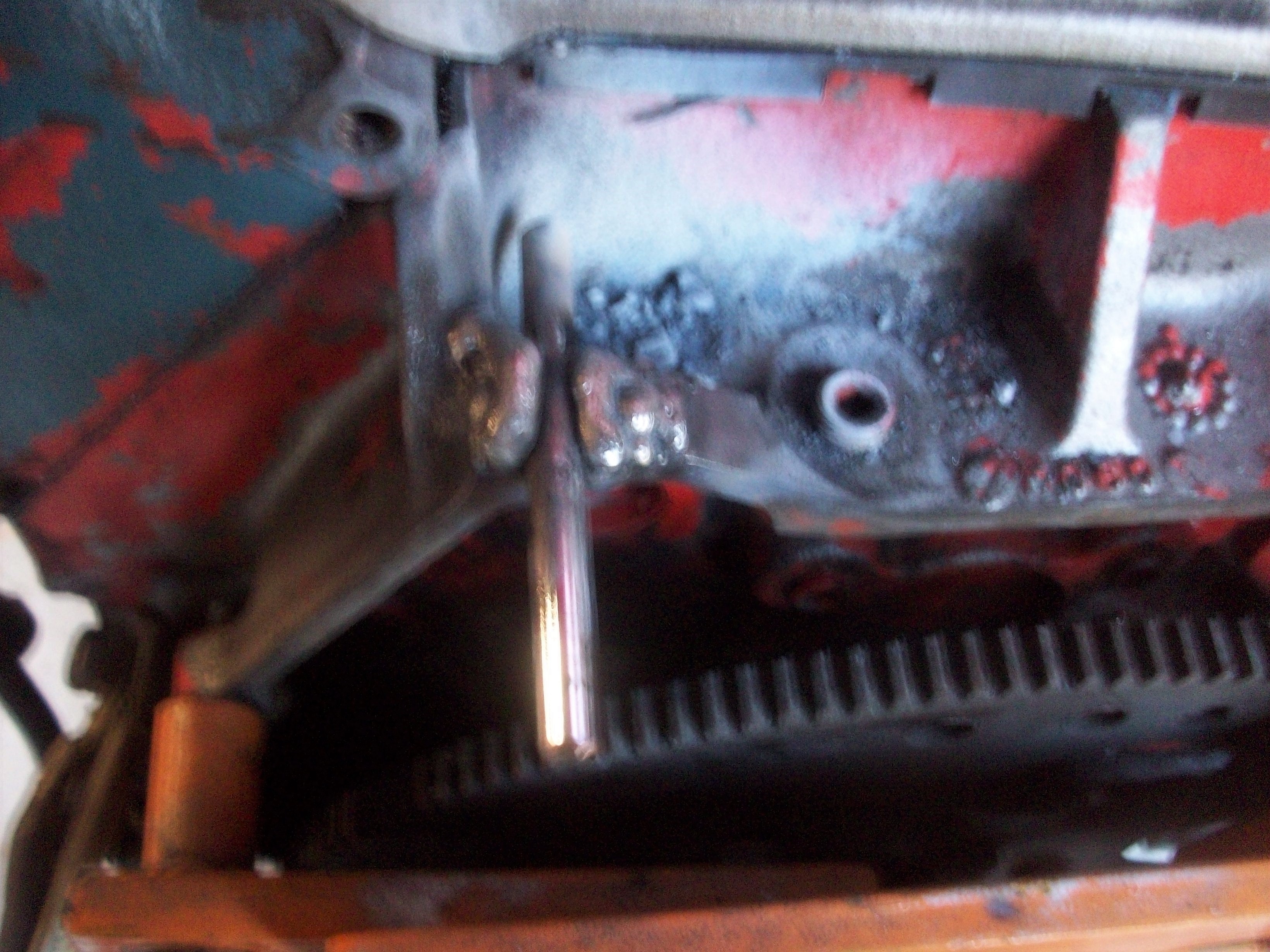

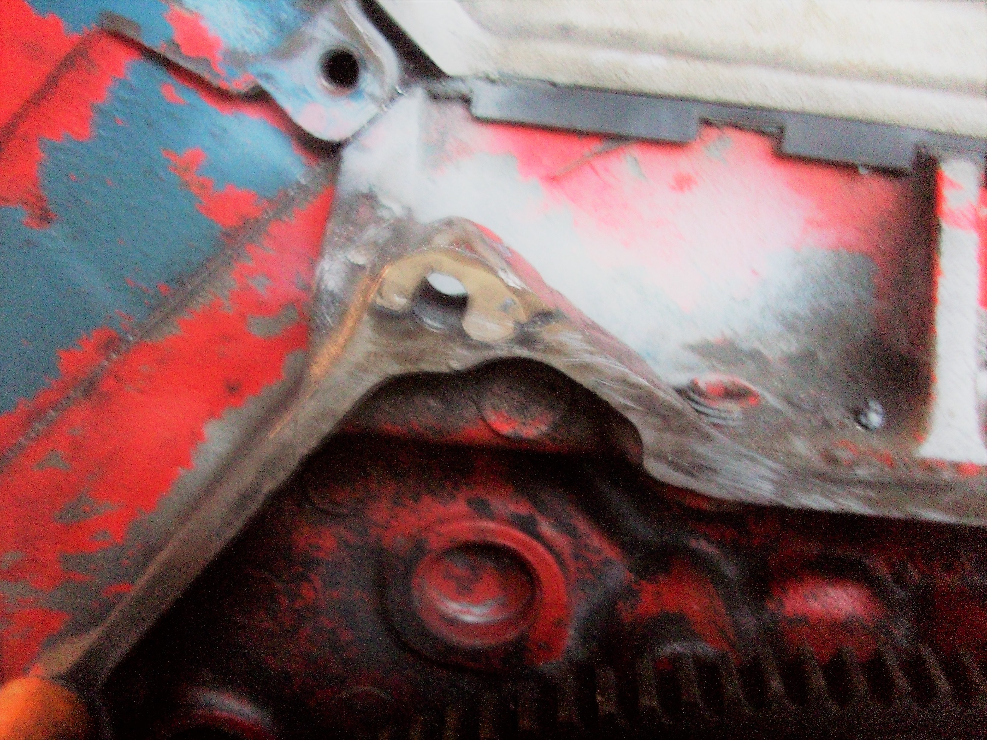

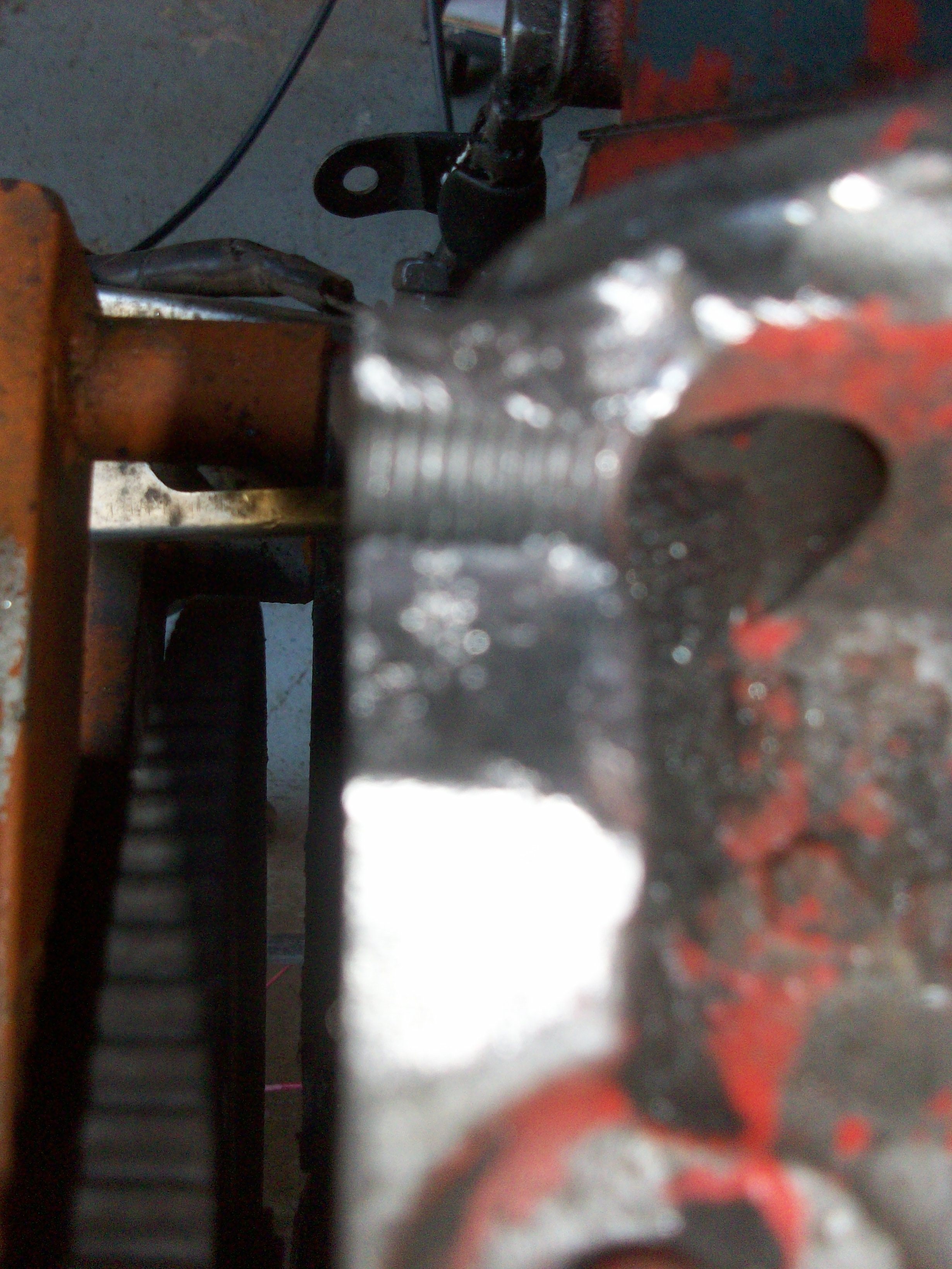

Got a Buick V6 in trade to help my son (shoe horn) a 350 Olds in to a 3rd gen Camaro.
The V6 had the left top engine to transmission ear snapped off at some point in the past.
Wanted to give repairing (building up) a new mount a try.
I have only tried repairing 1 other cast project - mig welding a cracked intake back together.
bought a couple sticks of 1/8 rod for cast iron at the local Co-Op- and all he knew was the sticks were for cast, they were marked NA 111
The only reference I could find to these rods was an old post by Shieldarc and Yomax. Thinking these were on the shelf for a long time. but sounded like they were a good repair rod that was also machinable.

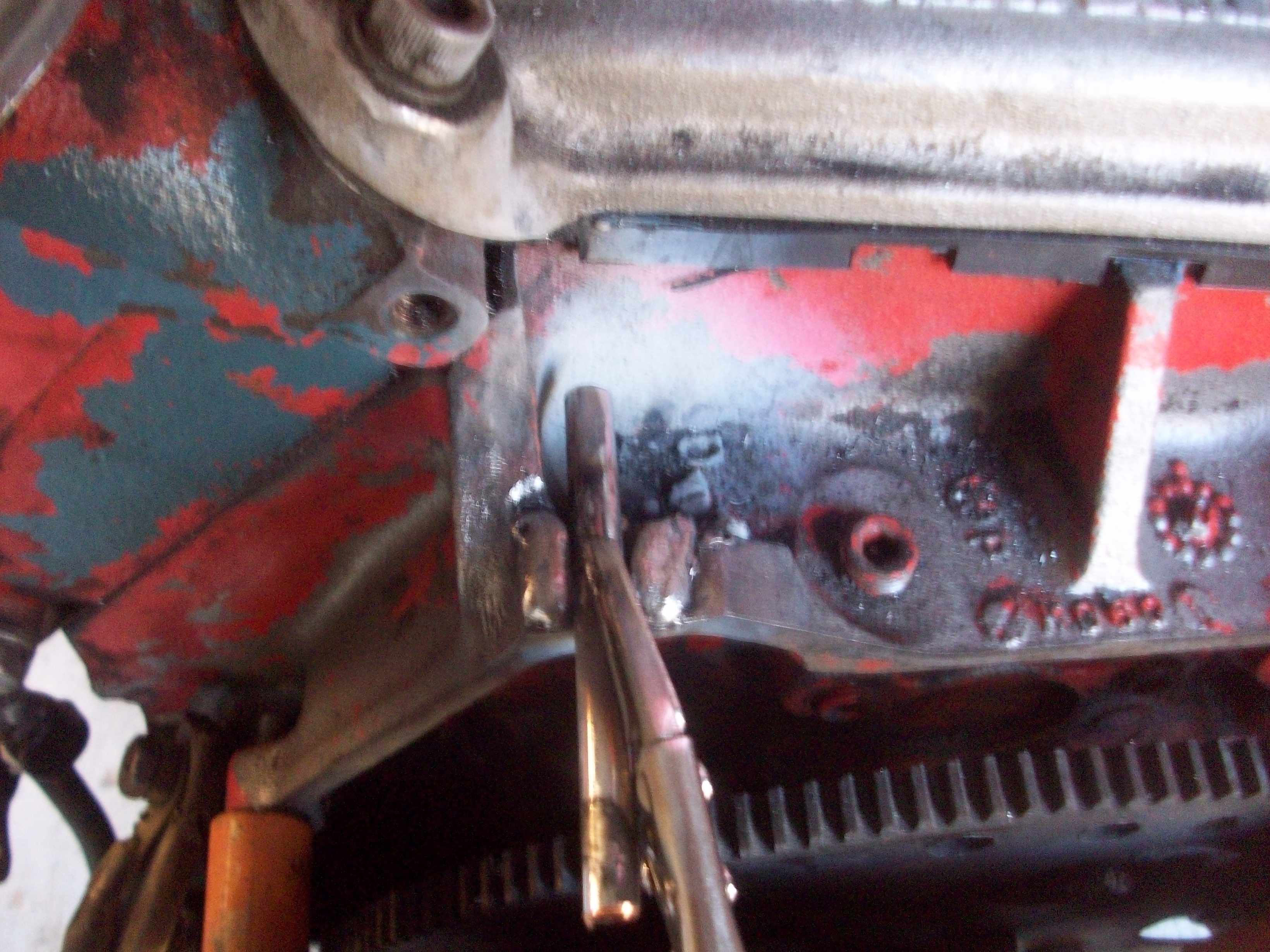

Anyway ground out the sides and since there was about 1/2 of the threads left on the bottom it occurred to me that if I could find a piece of tube or round stock of aluminum or another metal that the cast rod would not stick to it might save some time and work trying to bore and re-thread the hole.

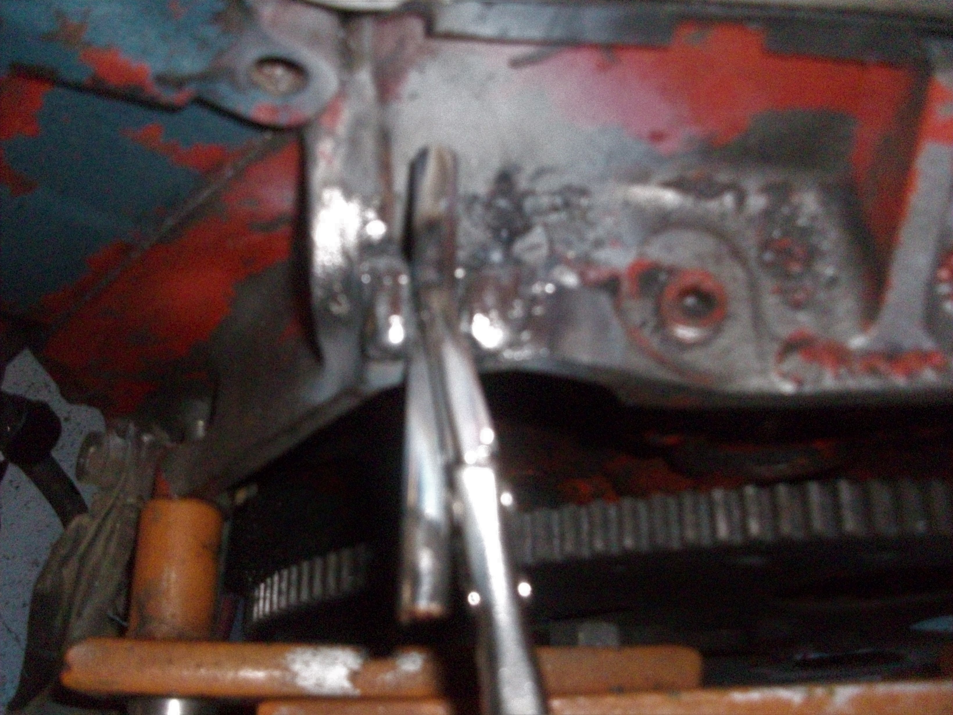

I did find a piece of tubing and clamped it in place hooked up my little 3 in 1 inverter found a chart that said to run cast rod DC+ tried 1 short weld on an old junk head to get the amps close and did a little local pre heat.

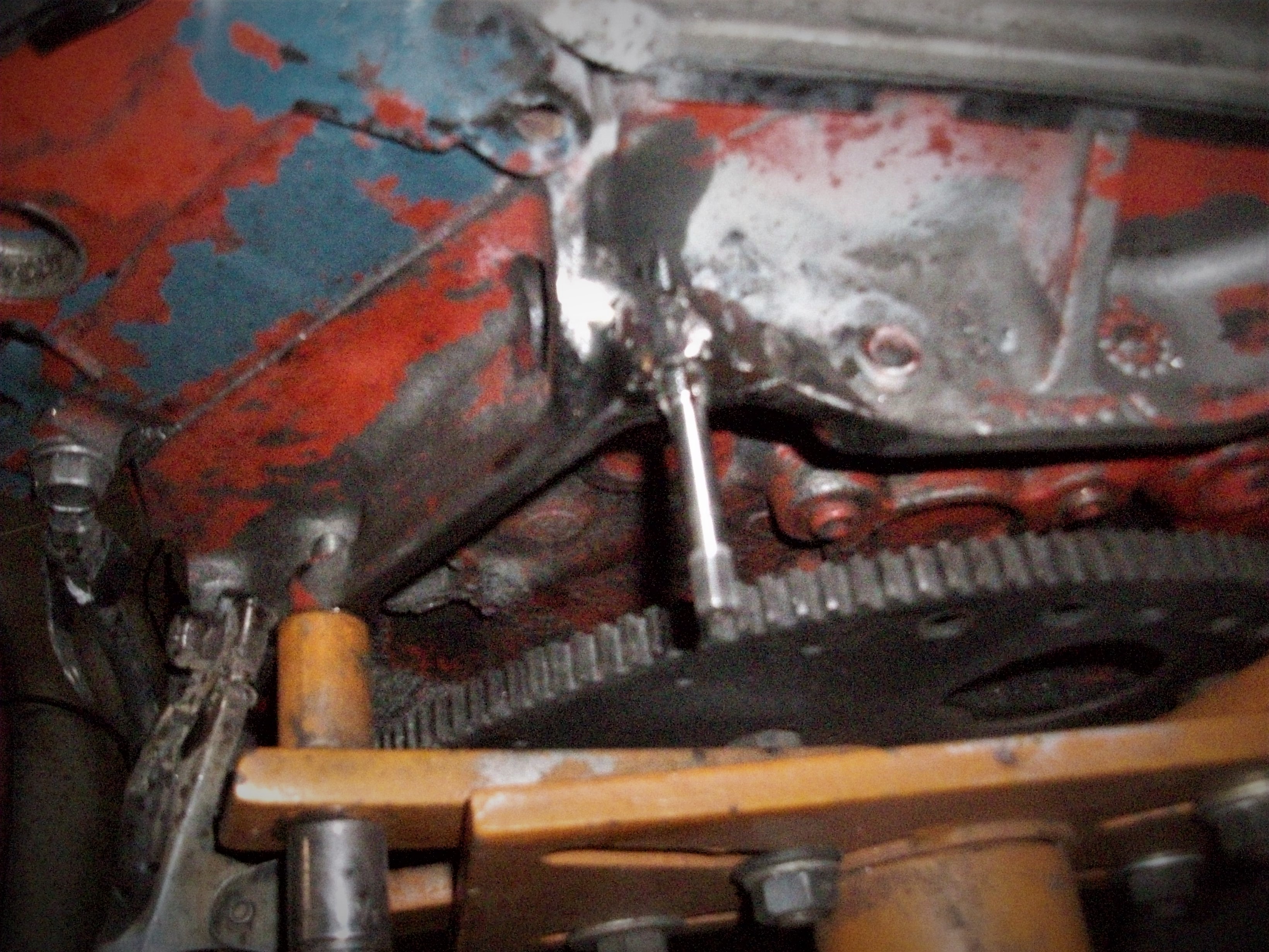

Ran single 1/2 inch beads and worked my way around the tube after letting each weld cool while peening the beads.
Did get some inclusions but can't find any actual cracks

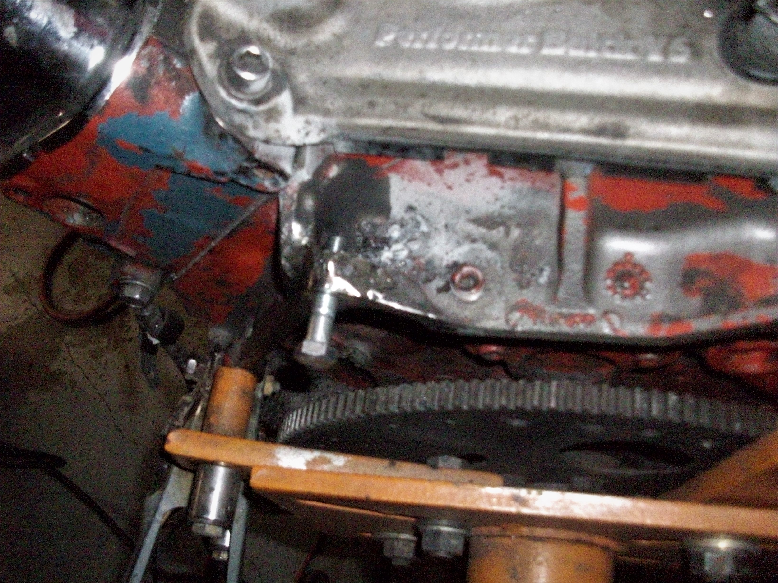

it is not pretty but after a bit of grinding and light drilling was able to run a tap through it.
Again Not pretty for sure- but I think it will work.
And it was fun trying a new new stick welding process.

I think it's awesome that you took the bull by the horns and fixed this damage. Next time try using a piece of carbon stick in the hole and weld around that. It works very nice. Turned out good as far as pics go. I'm wondering if you could add a little rod around the base of the eye without it tweeking or cracking or maybe you did. It will likely not be a perfect alignment but as long as you don't reef down on the bolt too much it should hold. Maybe less torque on that one with locktite blue or something? Good Luck !!!
Thanks Yomax Yeah-I almost chickened out and just left it alone
but decided to go ahead even though there is a possibility of cracking. Sometimes the urge to weld
and just try something new is hard to suppress:laughing:
i will likely get another rod or 2 of the smaller NA111 3/32 rods this time and add a bit more around the base. Still wondering if this is Kast-weld 111? It is pricey, Co-op is selling it for $55 a lb.:eek:
Someday I would like to try Mig with 309 Stainless that shieldarc linked to in the thread- sounds pretty slick for home type repairs

Thanks for the tip on carbon rods being used to keep part of a castings hole in place. Sounds like a great way to do it.

Kastweld 111 is an Oxy-fuel rod made out of ground up and pressed cast iron.. Pretty cool stuff too but works best with a few strands of copper speaker wire wrapped around it and the dipped in it's flux. If your weld hasn't cracked yet, You are out of the woods. All I can add is I'd be very conservative on torque when you pull against the bell housing. You probably know that but that's my only concern. If it's not a perfect flush fit, I'd hold my breath while tightening. Go easy lol.. I hope it works out..
