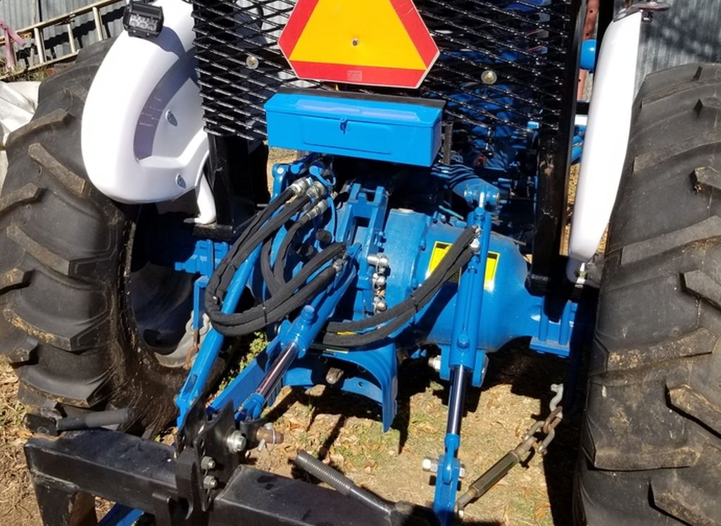

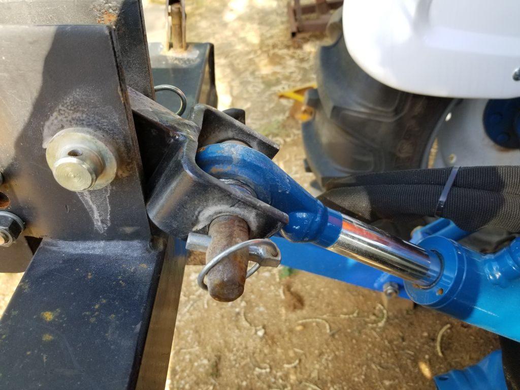

Every application is going to be different. I think I'm using the 18-26 on mine. However, I have Quick Hitch and I'm using a Stirrup to connect the rod end to the QH. The stirrup allows a cutter to float.
Here's a better picture of the stirrup.
