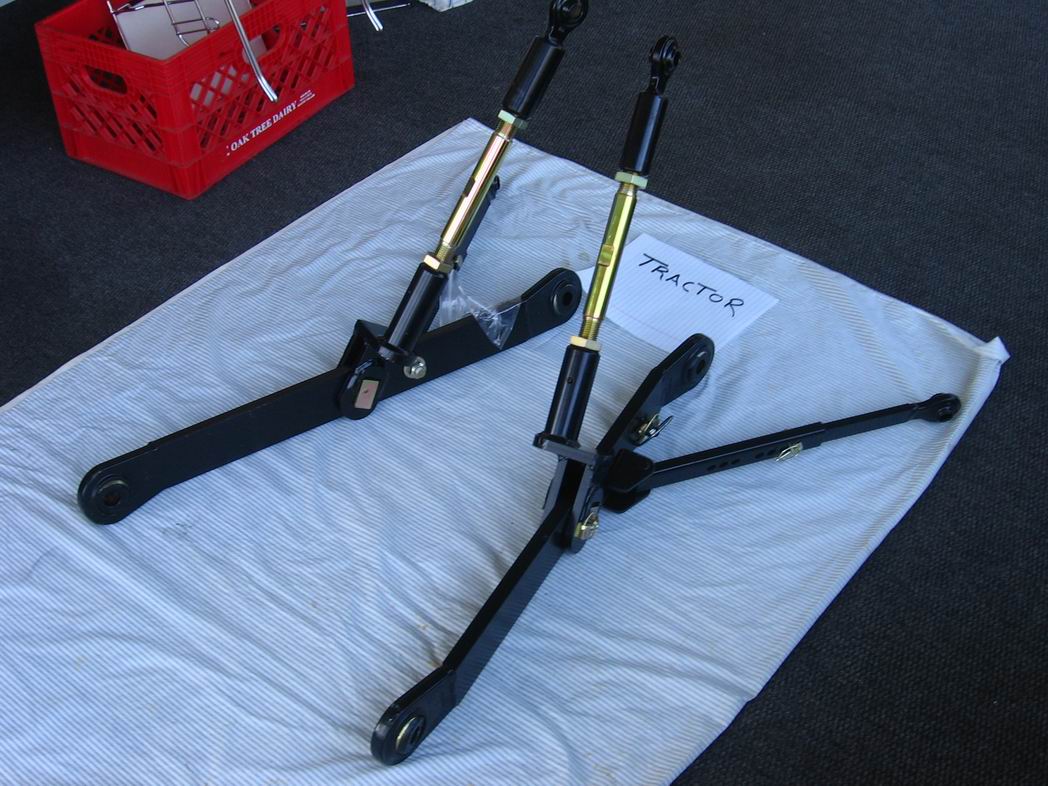

Picture FACTORY ASSEMBLED1 : If I lay the Lift arms down so the angled ends are facingin a way that they will mount to the Tractor see how far back U under the tractor)the Stabilizers run?
AND the Side Links are in front of the Stabilizers. That can't be right.

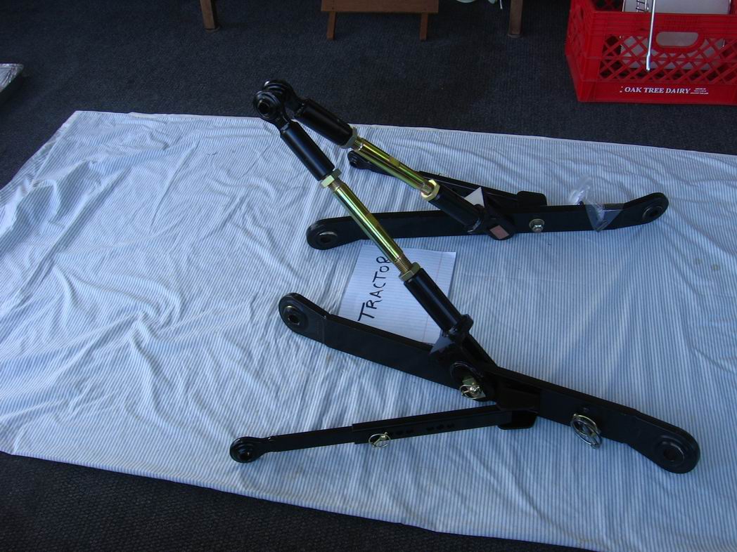

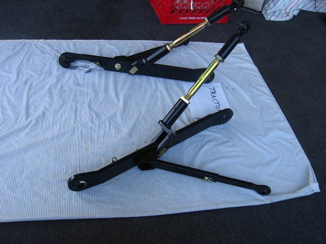

FACTORY ASSEMBLED3 : If I rotate the Stabilizer and Side link to the other side of the Lift Arms, the Side link is closer to the tractor ( as I think it should be)and the Stabilizers are out closer to the attachment area (as I think it should be) and all teh mounting to the tractor seem to line up Vertically ( as I think it should be). The problem is, the angled end of the Lift Arms face incorrectly .
After unbolting te Stabilizers and moving them to teh other side of te Lift Arm, It all makes sense accept for the welded on eyelets that I show with clevis pins in them.. shouldn't those eyelets be closer to teh tractor ? maybe not.

Those eyelets are for holding the Lynch pins when there is no attachment on the lift arms.
Looks like you have it right, post pictures after it is on the tractor, the lift links might need to be turned around on the lift arms.
