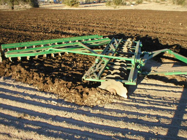

We use an old Cat D6 to pull our 12'disk. Have used our Case 310 to pull the 8' disk before we had any wheel tractors. This is all old equipment, but still gets the job done. :thumbsup:
Nice straight line travel on the D6 photo, and it looks like you have a front sight on the hood. :)

I grew up on a farm in the central valley of California (1940s and '50s) and we used track engines exclusively for tillage. The valley had heavy clay soil, and the track engines produced much less compaction than wheel tractors. We used them only for row crop work, like planting, cultivating, and harvesting of some crops.
