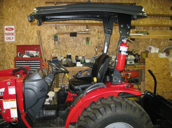

Easy and clean. 2 hose clamps and 1 fire extinguisher. ;)
   / Cautionary tale. Check your Shear Bolts and get a fire extinguisher for your tractor
Very clean Brian. I've got to figure out where I can put one in the cab without too much drilling.
