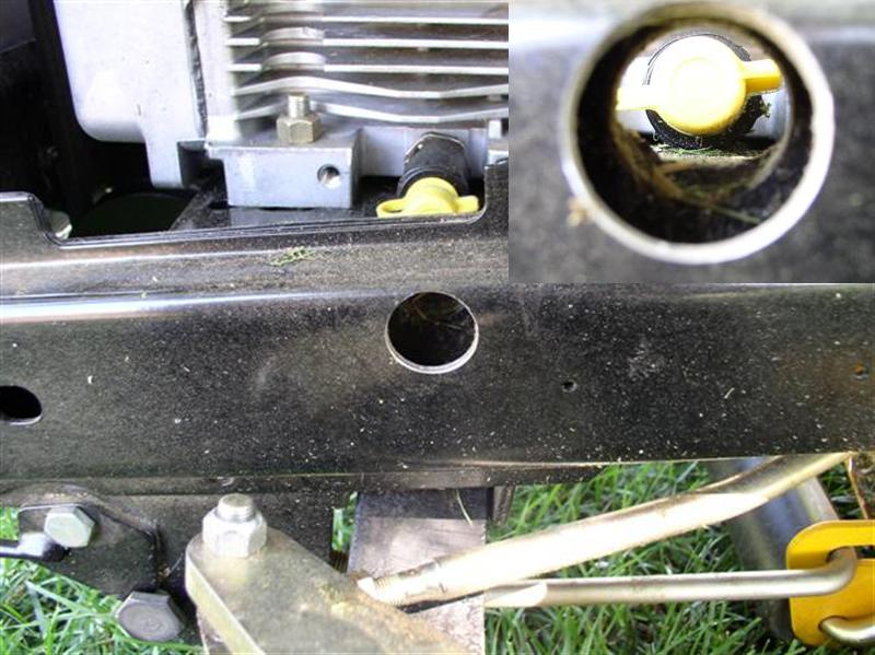

When you go to change your oil, grab your 7/8" hole saw and cut through the frame to attach the hose (you'll see others who have done it here, I have pics if you want). I did mine before I ever changed it and didn't get to experience the difficulties others had.

I would like to see some of those pics Rhoderman has of the oil drain hole. I have 12 hrs on my mower and am fixing to change the oil at 15 hrs. Also how much am I going to have to fork out for the stuff to do it with.

Al,
Here's a pic looking through the hole to the drain "plug". If you bore a hole through both pieces of metal as close to the top as you can without hitting the top portion of the frame it will work good. The back piece will be welded in place so you will have to break it loose and bend it out. If there is a lot of metal left, you will need to file it out with a round file. I used a mirror propped against the engine to check progress while drilling the hole. I used salmon oil to lube the hole saw, works great. The salmon oil is normally used for adding to the dogs' food to keep thier coats shiny.
Also, when you change the oil, be sure to get the filter good and tight. Mine was snug, but it dripped a little oil until I cranked it down good. Also, put the right rear wheel up on a block to tip the engine to the drain side before you drain it. All of the oil will come out better that way.
I would suggest changing the oil at 5 hours. Mine was pretty grungy at 10 hours. If you're at 15, don't sweat it too much, but get it changed soon...

Ok I'm going to be the party pooper here....I personally wouldnt drill through my frame in order to drain my oil.
I concur its a bad design from Cub on many of their models.
But simple surgical tubing eliminates the need to bore a hole in your frame. Many other ideas like tubing can be used. I feel it weakens the frame bottom line...

/forums/images/graemlins/crazy.gifI'm with you ducat. Drilling through the frame and weakening it would be a no-no just to drain the oil. Some time we over react and create other problems. My .02 /forums/images/graemlins/smirk.gif

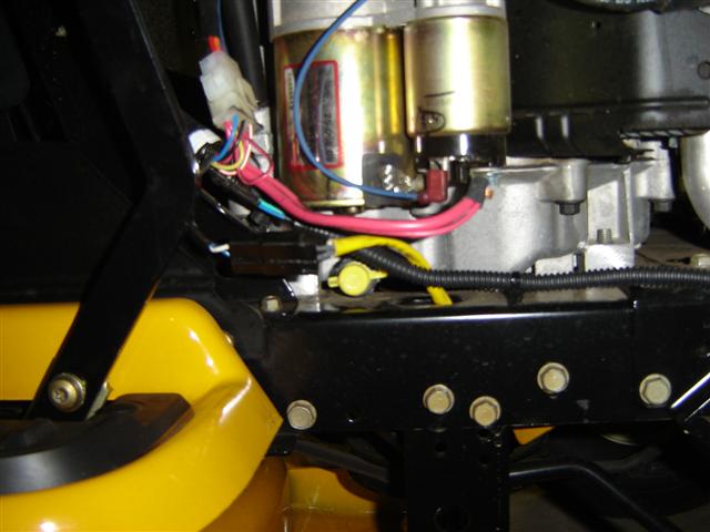

Well,
I went to look at the drain hole location on my mower. It is a 2005 LT 1046. It has the 23hp Kohler Command. I will not have to cut a hole in the frame. It is located right under the starter. I have attached a pic.
