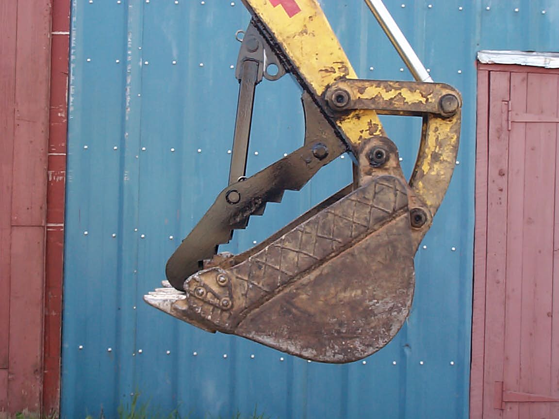

I have not built a backhoe but did purchase a thumb for my excavator from the people on your link.The quality of the laser cutting was second to none"excellent" and people were very easy to do business with.Maybe this is of some help if you decide to do business with these people.

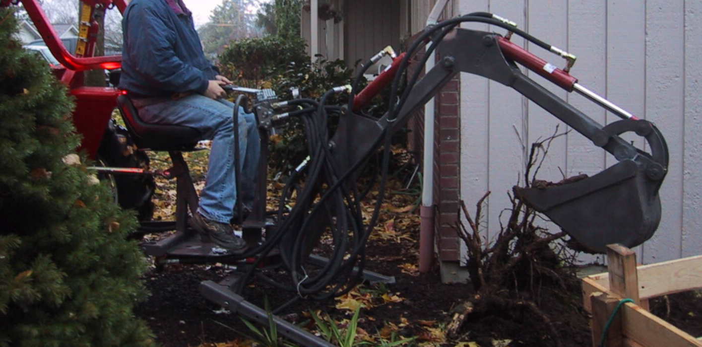

I recently completed building the CDP mid-600 backhoe. I also reviewed plans for the cad-digger, and built the cad-digger 5" bucket (modified for use with the CDP unit)
- Here are my impressions/reccommendations,FWIW
I went with CDP because the initial cost was cheaper, and I was annoyed that Cad-Plans wanted to charge for the plans even if you buy the parts kit. CDP also had better specs
Cad plans are a little more detailed, but CDP was adequate for my needs - The CDP plans I got with the parts kit are not enough to build from scratch - there are no instructions for making the parts. The CDP parts themselves were great, precision cut, excellent. Shipping and service were fine.
CDP's backhoe is harder to build. Look at the buckets - CDP is rounded and requires bending metal - a real pain. Cad digger is squarer (uglier) but easier to put together/weld.
One big drawback for CDP is they use non-standard cylinders - I had to buy them from CDP.
Total cost for me was $2500, including the second bucket.
My reccommendation - if you are building from scratch, go with cad-plans - if you are getting a parts kit, CDP is a good option.
If you have any other questions feel free to ask.
Jeff

I got the spool valve from www.northerntool.com I used parts 201612 (4), 201617, 201616, 201526. It works fine except the handles point the wrong way. Around $300 with shipping.
I'd be hesitant to drill out the 3/4" ends, doesn't look like enough metal - you probably could cut the ends off and just weld on a 1" end - you might need to dissassemble the cylinder to keep from damaging the internals during welding. My local hydraulic shop offered to custom build me some cylinders, but that costs more than ordering from CDP.
