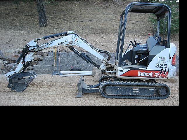

   / CDP backhoe or thumb experience? #6
Picture of excavator with a thumb.
I have used a rental excavator with a powered, movable thumb. I've used it to build a gravity wall out of boulders. The wall is partly viewable behind the left of the bobcat. It would have been impossible to build the wall without the thumb to lift and accurately place the boulders.
I'd like to get a movable thumb on my Kubota backhoe to help move more rock as the lanscaping continues around here. Although with a backhoe you can't safely transport rocks with the backhoe. The excavator is stable when transporting rocks in the bucket--just tuck them in close.

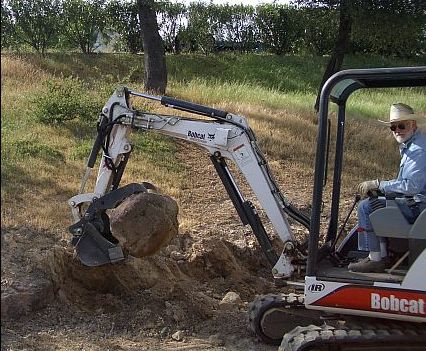

   / CDP backhoe or thumb experience? #7
Picture of picking up a boulder.
Dave

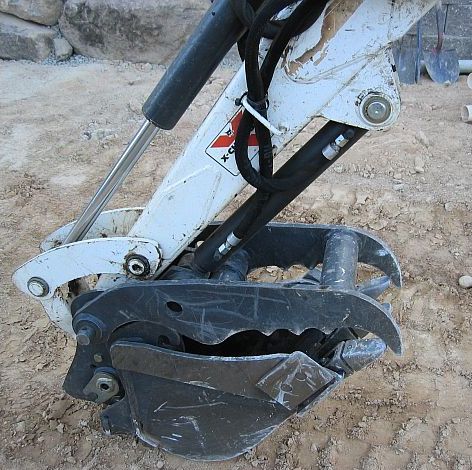

   / CDP backhoe or thumb experience? #10
Here is the CDP thumb kit that I built.
