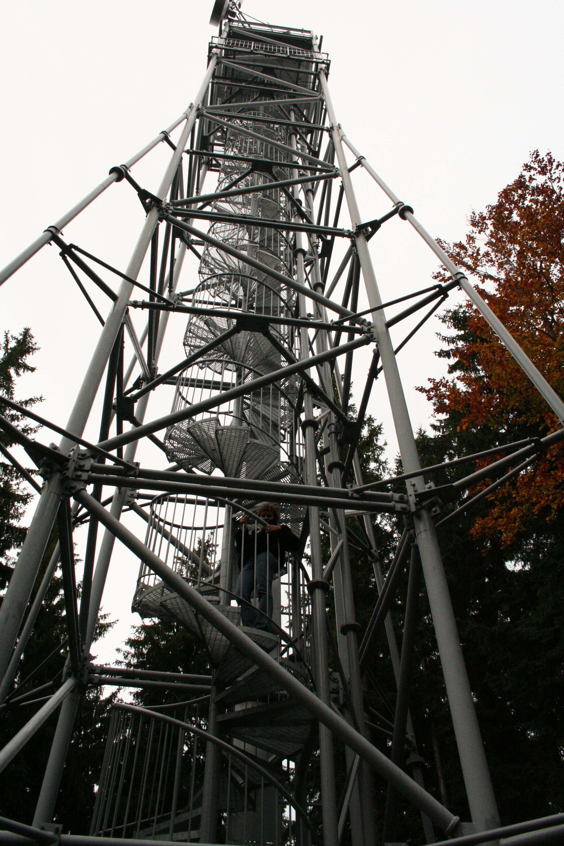

I heard a story about a guy who bought all guard towers between Czech republic and Austria and Germany. There were hundreds of them built. Now he leases them to mobil phone companies in all three countries. The lower platform is open to public. The very top platform containing the equipment is locked.
This one is about 150 ft tall.
I and wife on the top.
